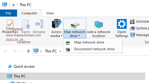

Hi Grogs
Just found this
In Windows Explorer:-
Select This PC
Click Map network drive & bring up the dropbox.
Click Disconnect drive.
Should get a popup box with a list of N/W drives.
(You can pre-select the drive which is what I did in the screen shot)
Reload Explorer to clear the list.

Posts: 10081
Posted: 08:20am 28 May 2020
OH yes - tried that LOTS of times, including right-click shared drive in FM tree, select Disconnect.
Windoze simply moaned that: "The network location does not exist."
Which was, actually, true, but I wanted to be able to get rid of the entries in the FM tree.
