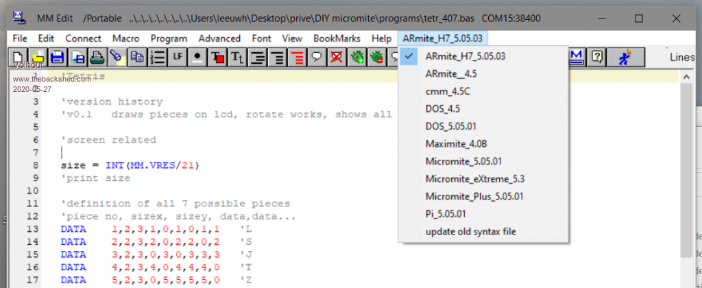

The syntax file TassyJim refers to refers to a configuration of micromite/maximite type you have connected, and version of the firmware. You can select the correct type in MMedit.

Posted: 07:10am 27 May 2020
As long as you have Micromite selected, it will be OK
Different devices such as Armite or Maximite work differently. That is why we need to tell MMEdit what device we have connected. There are no differences between firmware version on the same device.

Posted: 09:46pm 27 May 2020
One of the options in MMEdit is to RUN the program after loading. Perhaps you had that set previously.
