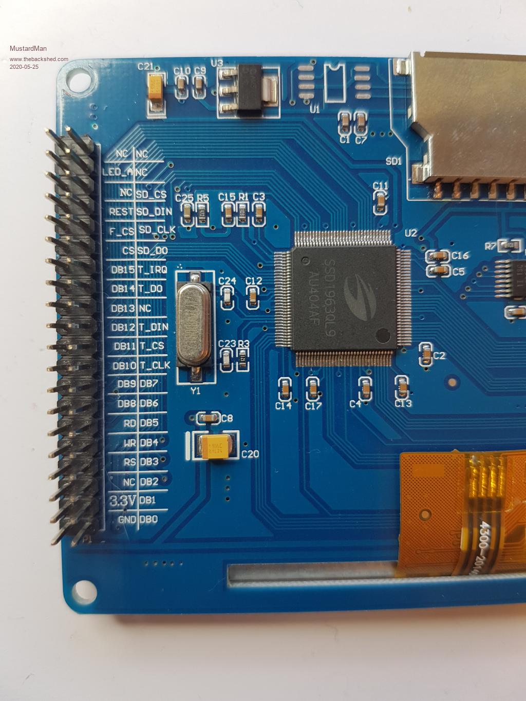

I am fairly certain I saw a thread on this forum (although it may have been elsewhere) regarding the 'empty' spot on the 5" SSD1963 based LCD panel PCB. I didn't pay much attention at the time other than 'mmm, interesting'.
Now some while down the track I've discovered that I do need the extra memory and a removable SD card is not really going to cut it. The Explore 100 has insufficent memory for storing bitmaps larger than a couple of dozen by a couple of dozen pixels (at 3 bytes per pixel, bitmaps are pretty hungry) - and it is volatile anyway.
On the 5" SSD1963 based LCD panel PCB there is a footprint marked 'U1'. This is for an SPI based flash memory device (eg: SST25VF016). The Explore 100 has the CS of this chip connected through CON9, and it uses the same SPI bus as the touch controller and the SD card slot. I did see an eBay seller that offered panels with this chip installed.
My intention was to use this as either a large block of raw memory, or copy a SD card file system over to it, to load/save full screen bitmaps. The largest chip I found in SO8 is 32Mbits (4Mbytes) which is enough for three full screens of 800x480 at 3BPP. I have some on order, and soldering an SO8 is easier than soldering a DIP!
Question I have is how to access the thing... the explore 100 MMbasic version has support for SD card filesystems (files, open, save, etc), and 'OPTION SDCARD 58' should enable me to just access it with no problems (I haven't done it yet, the order is still a week away).
However, it will be completely blank when it arrives. If I am able to configure it as a filesystem, I'm not sure how I'm going to format it or copy stuff from a 'real' SD card over to it. And I've even less of an idea of how I would use it as a block of raw memory - has anyone written a CFuntion for doing something like this?
I intend on using this to store images, config files, program backups, etc rather than relying on there being an SD card in the SD slot all the time - which if removed by the user will cripple the system (I can bypass filesystem read errors, but there will be no graphics and limited config save/restore).

On page 4 of the original post the code has this comment.I think its correct if you are using the CFunction versions available for MM+ E64 and E100. The selection of various SPI devices is handle OK by the Cfunction so mounting the memory on the LCD is OK.
The sharing of the touch SPI when using the MMBasic version is an issue as the touch SPI is not available to MMBasic. This would apply to the MMX and ARM versions, which don't have a CFunction version. For these the memory chip would need to be off the LCD so a different SPI could be used.
  Quote  '

I cannot be certain that it does pertain to the e100, not having had one to play with, (I jumped from the 28 pin straight to the 64pin extreme) but in the extreme you can talk to the chip fine but if you configure the display and then try to read/write the chip you get an error something like (SPI in use) I tried every trick to get around this (as confirmed by Peter Mather) but in the end I had to redesign BackPack-64X to use a different SPI port..
Maybe there is a difference as Peter used CFunctions, which are not available on the EXTREME family, to read and write..
Andrew Henderson wrote some really good, and fast, routines entirely in MMBASIC that work on the MX170 and the Extreme-64 so you might like to play with them.

Thankyou for the tips and pointers. I have very quickly skimmed some bits of the original post and it was mentioned about Peters code and simultaneous MMbasic touch access. From what I saw skimming, Peters code accesses the memory as raw memory (in pages), and due to the way SPI1 is used for touch, it can't also be used to access a flash device?
I have no problems using touch and SD together... but then again an SD has a micro inside it to handle the flash, and without that... perhaps a flash memory would work as a read only "SD" if it was 'pre-formatted'?

Definitely works with touch configured on an E100. I have read from the Windbond chip  in the PenDown event and its OK. I would normally set a flag in the PenDown event and action in the main loop.
