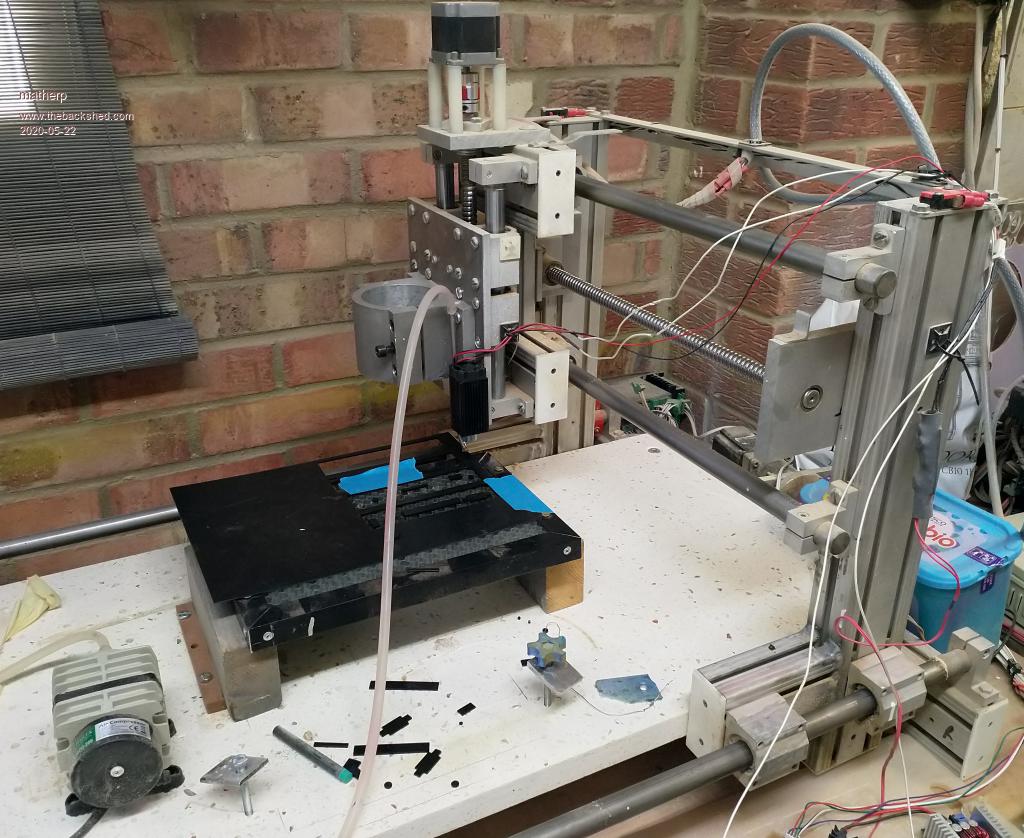

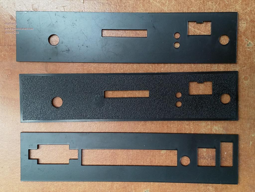

I use either a CNC router with a 1.5mm endmill or I cut them with a laser diode I have fitted to the router. I could scale this up and make them available to WW to sell but volumes would be fairly low.
I can cut the supplied end plates or cut from scratch using 2mm plastiboard
The ones pictured are laser cut

  Quote  I wish I had a CNC, too
Build one, that's what I did
The laser head uses a NDB7A75 diode that I'm running at 2.8A which gives me about 4W of actual laser power. Note the air assist pump in the picture. This is critical to remove fumes and burned material from the cutting site. Getting this all set up and working took many hours including designing and building the constant current source for the laser and integrating control of it into the CAM software.
You can buy complete units  but need to understand the power ratings. By "commercial" standards my laser is roughly 2.6A * forward voltage c5.5V = 15W but the burning power is only 4W. To cut this plastic I use 3 passes at 200mm/min. Fume extraction is essential as some plastics give off HCN when vaporized in this way - BAD

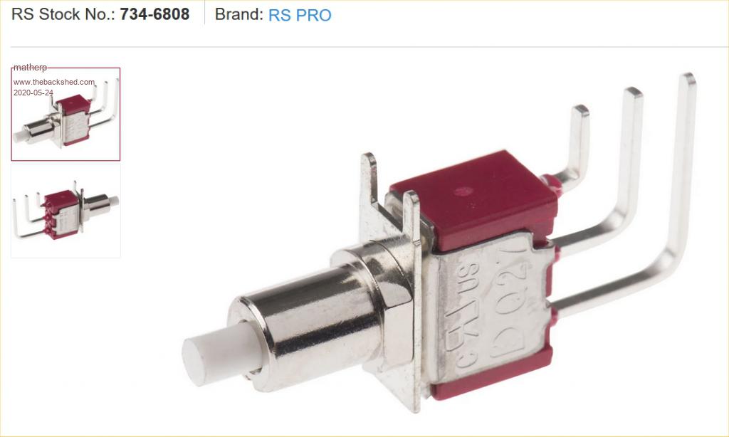

btw, an obscure question: will the versions of the PCB for the 'american market' have the power switch orientated as up=on? i half expected to see the switch orientation configured with an optional jumper on the PCB.

  Quote  btw, an obscure question: will the versions of the PCB for the 'american market' have the power switch orientated as up=on? i half expected to see the switch orientation configured with an optional jumper on the PCB.
The switch listed is down=on but there is a push-on push-off switch with the same footprint and physical layout for those perverse enough to believe this is incorrect

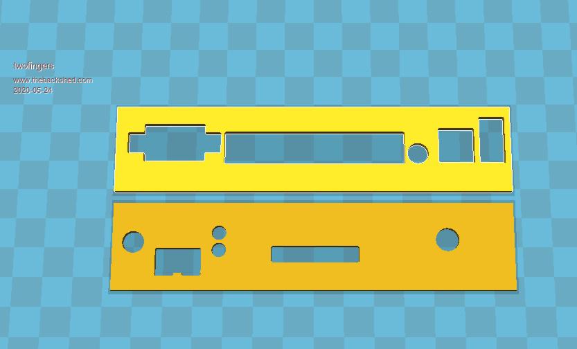

Even a relatively entry level 3D printer (mine is a FlashForge Finder - you can get one for just over A$400 if you shop around) can print to +/- 0.5mm which is more than sufficient for the front and rear panels.
The .STL files you need to feed to your slicing software that comes with the 3D printer can be seen on this page
If you need to, you can edit the .STL files with FreeCAD or any other CAD program. Also, while the finish on the #D result is pretty smooth, if you want REALLY flash, you can buy some Ultra High Gloss label paper for your inkjet printer and affix this to the panels.

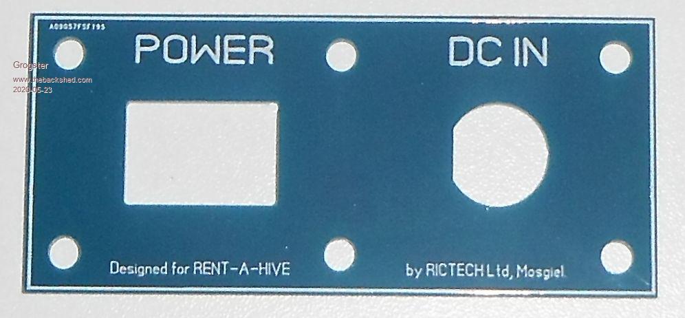

I do like the idea of having them made as PCB's, and having the factory route all the slots and holes for me, which makes it nice and neat.  Basically, you select black for your soldermask, and have the normal white silkscreen, and just have holes and no copper at all.  But they do come out looking lovely, I have to agree with Geoff there!
(yes, I have done this kind of thing before)
So, I am toying with the idea of rustling up front and back 'PCB panels', but I have not actually done anything yet.
EDIT: Here is one I did for a project....
