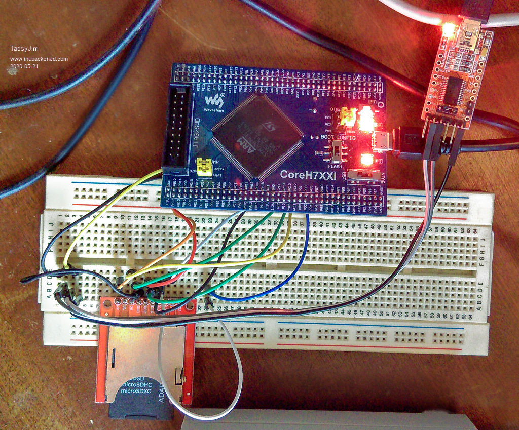

Posted: 03:49am 21 May 2020
Do you have the 2mm 80x2 headers for the module?
Without any of them, there is not much you can do.
If you have spare headers, you can wire up a SDcard holder and with any old USB-TTL module, you can get on air although without any display.
My headers came before my board so that is what I did and the unit I have on the net is still built that way.
