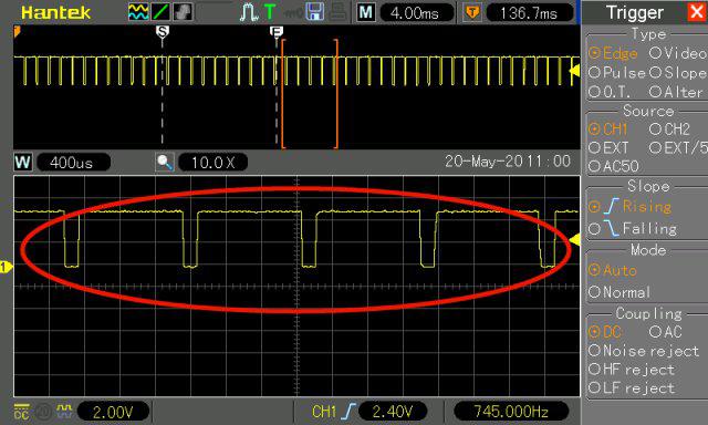

Morning Forum.
On a MicroMite Mk2 28 pin 170, has anyone had any joy getting the SPIPort routine in the Embedded routines in the firmware pack working? (can't use the normal SPI port).
I have something very odd happening whereby I am getting  the CS pin oscillating even when I have stopped the program and am at the > prompt.
Here is my sub to talk to the chip:
Sub MAX7221(MAX7221Dat As Integer)
Local Integer j
Pin(CS)=0 'CS Lo
j=SPIPort(2,DAT,CLK,MAX7221Dat,0,0,16)' 16 bits sent at 1MHz+
Pin(CS)=1 'CS Hi
If I REM the line starting j= then I see the toggle from the CS pin, but if I un-REM it, I get the oscillation, even when my prog is not running. It starts up, makes a single call to the above Sub then ENDs, but that CS pin keeps waggling... at the > prompt(!).

It very much looks something is repeatedly calling your sub.  The CS low time is about 250uS which is about correct if the line starting j= is commented out.

I agree, but it is happening at the > prompt, which kind of points to some backdoor thing going on. Also, I call the routine once then end and it still continues.

Do you have a tick timer going off every millisecond?  That will keep running at the command prompt.

No, no timers at all running. It is a mystery and definitely associated with the CFunction - if I REM it out, the problem doesn't manifest. I was checking for shorts and all sorts but it just made no sense. Maybe the HEX got corrupted when I copied it across or something.

Could it be the CFunction (CSub) that is keeping the pin going?
(I'm guessing it can still be active even back at the command prompt.)

That was my guess too - it needs a power cycle to stop it i.e. once started I have no control (prolly a CPU RESTART would fix as well but dint try). It is not expected behaviour and from code that is quite old (= mature)... Geoff says it has been tested extensively and that is good enough for me.
I am wondering if I missed a bit off the HEX when I copied the routine from the PDF or something. I have had odd instances of weird stuff happening in the past that was fixed by re-flashing, but everything else about this uM is spot on - it doesn't have that "feel" of a corrupt firmware.
