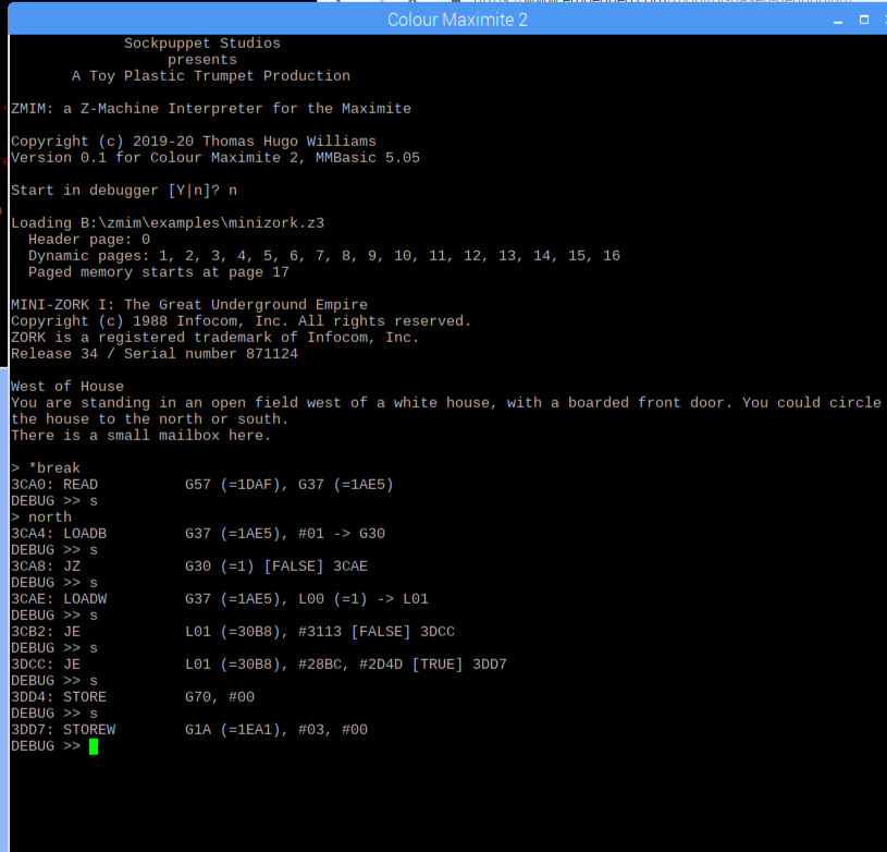

Hi folks,
Just a quick picture to show that progress is being made:
What this shows is a Z-machine monitor/debugger that I've built into the implementation to help me track down a bug in the parser that has been stymying further progress.
