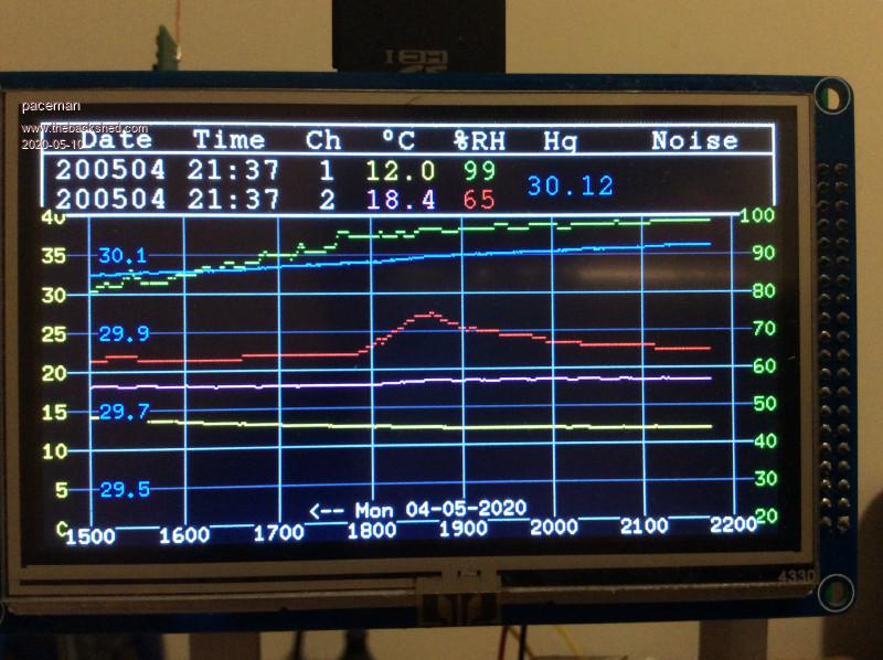

I developed some code that displays a continuously scrolling plot of the temp/RH data from two
Digoo's (one inside and one outside, ten metres away) and the pressure sensor. I've decided to post
this work in case members are interested in some of the methods I used with the uMite+ since I'm sure
in future there will deservedly be a lot of focus on the new STM based MM2.
The system has been running in my office for a couple of years now and it quite stable.
The system includes:
1. the uMite+ (MX470) running on Peter's original 'universal' backpack V1.1
2. a 4.2" 40 pin SSD1963 480x272 display. Smaller displays are generally a bit too 'busy' and
restrict scale range. The 320x480 ILI9488 3.5" would be a preferred choice and improve scale range.
3. a piezo beeper,
4. a battery backed DS3232 RTC,
5. the RX470 433 MHz receiver module and
6. the wired I2C BME280 barometric pressure sensor and two Digoo R8S temp/%RH sensors.
Items 3-6 are mounted on the backpack.
Features of the program include:
1. a continuous seven hour display updating asynchronously, approx. once a minute for each Digoo
and every half minute for the BME280.
2. scrolling the display using the BLIT command - actually a 'pseudo' scroll but still effective.
3. maintaining an updated time grid on the X axis.
4. auto-scaling (only on barometric pressure but simple to add to temp/RH).
5. noise checking (with display) all data using rolling averages.

disco4now
Joined: 18/12/2014
Posts: 1159
Posted: 02:01pm 10 May 2020
Hi Greg,
Good job. Those Digoo things are good value. Seem to be OK on batteries as well.
Looks like it could be raining outside? 99% RH
Gerry
F4 H7FotSF4xGT
paceman
Joined: 07/10/2011
Posted: 02:52am 11 May 2020
Hi Gerry,
Thanks for that, though the tricky efforts were from you, Jim and Peter.
Yes it was certainly raining when that photo was taken and probably well over 99%. I had to limit the plot to 99 because over that, it stuffs up the display scrolling.
I've had a good run from the Digoo units too. I'm not sure when I last changed the batteries but I'd say they go about a year each. I added the noise-check to count and display bad results because they seem to correlate with low batteries. I also had to replace the internal coil aerials to improve the range - made little bare 'loaded' aerials to do it. Took me about half an hour to make each one, winding 16 neat turns of wire using a shish-kebab skewer as the template and cutting a tiny slot in the housing to fit. I also put one on the receiver and now 10 metres through a wall is a doddle.
When I first started playing with it I looked at the signal coming in at the receiver (with the scope) and was amazed how much white noise was there. I thought there was no way this could work so I coded a counter into the 'blip' routine and it triggered hundreds of times a second but still managed to get reliably through the rest of the code for the display. Someone (you maybe?) posted about adding a capacitor to the receiver to 'quieten' it but I couldn't find the post. I'd still like to do that if I could find the post.
The BME280 pressure sensor is very reliable and amazingly sensitive. It easily shows a obvious 'bump' when a front comes through. A couple of days ago there were three or four pressure bounces over about a three hour period.
Peter's code for the BME is pretty involved and makes the listing a bit hard to follow. It would be nice to be able to shorten that code but I'm an awful long way from being up to that. I remember at the time he posted it that he said he couldn't understand why the manufacturers made the handling of the registers so 'messy'. If Peter had cause to complain then I'm stearing well clear!
Greg
