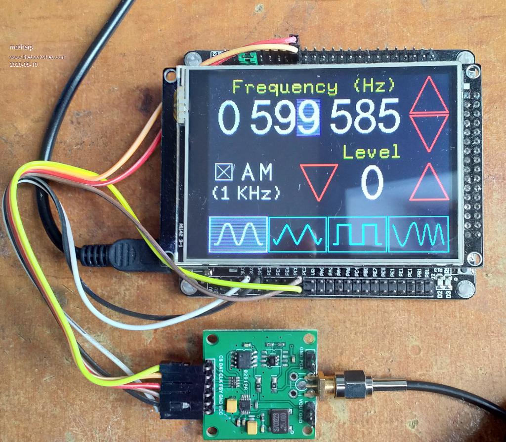

Lots of projects designed for the Micromite backpack work with almost no modification on the ArmmiteF4 (except that they run much faster   and the ArmmiteF4 with screen is MUCH CHEAPER   )
As a lockdown project I've recently got a couple of old Hacker radios out of the loft and have been repairing them (first generation germanium transistors). To properly align them I needed a signal generator and Geoff has created a good one - see his site for full details.

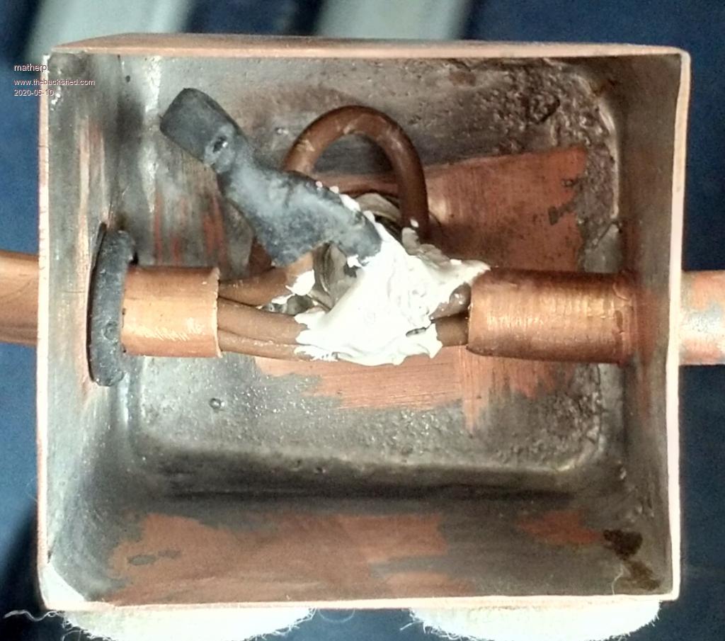

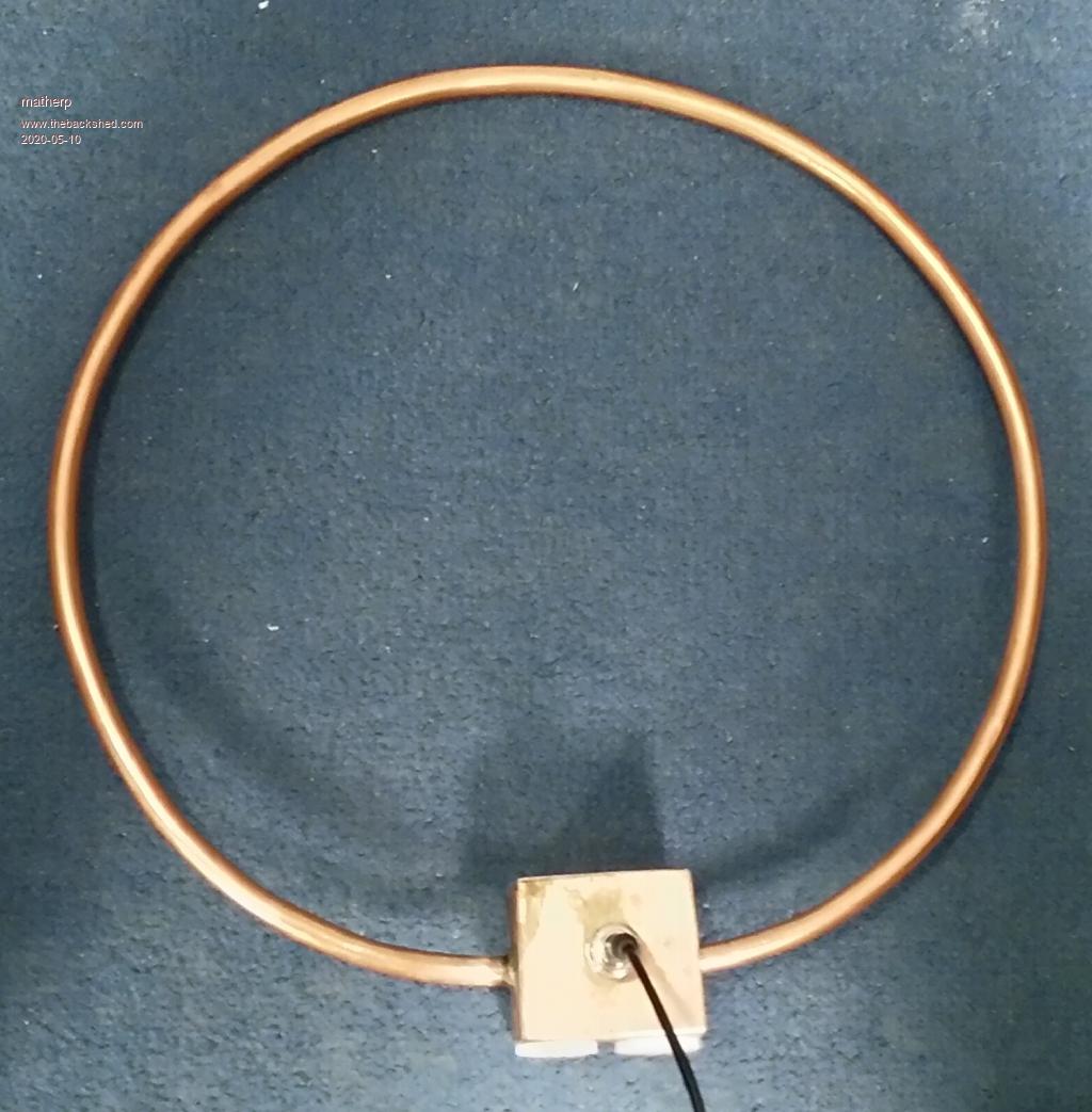

First job though was to create a loop antenna. I followed the instructions in the Hacker service manual. 250mm loop of 8mm copper pipe. One end of the loop soldered to a 5-sided copper box 50mm square. The other enters the box via a grommet. A BNC connector in the front of the box. Then three turns of 20SWG wire passed through the loop and one end made off to the earth tab of the connector which is in contact with the box. The other end of the wire is connected via a 405ohm resistor (390+15) to the centre pin of the connector. Rough and ready but completely functional.
Next job was to get the basic code working. This needed very little change except in the area of the AM modulation where Geoff peeks some memory that isn't relevant on the ArmmiteF4. Geoff's code AM modulates the signal by just turning it on and off at 1KHz.
However, I've got more CPU horsepower on the ArmmiteF4, How about a sine wave modulation like a commercial RF signal generator?
The ArmmiteF4 has a specific command SYNC that allows very fast but tightly timed activities to take place. See last post on this page. Using this I was able to modify the gain of the programmable amplifier on the AD9833 PCB faster than 1KHz. I settled on once every 318uSec which together with 12 output levels gives a rough sine wave every 3.816mSec. Divide this into one and we get pretty close to the middle-C frequency (262 Hz). I used gain values that give about a 30% modulation which seems to be typical for RF work. The maximum rate I was able to modify the gain was about every 225uSec but I adopted something more conservative.
Here the signal generator is set to give a 500 metre output (the Hacker's have metres not frequency on their dials

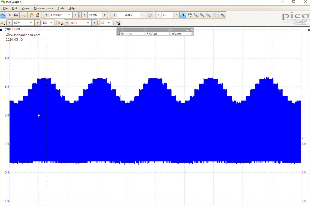

This is the waveform going into the antenna
There is the 599585 Hz carrier with the sinewave (approximately) modulation on top of it.
Tune the radio to 500 metres and there fully audible is middle-C or at least it will be once I've aligned the set, currently it tunes at 525m
