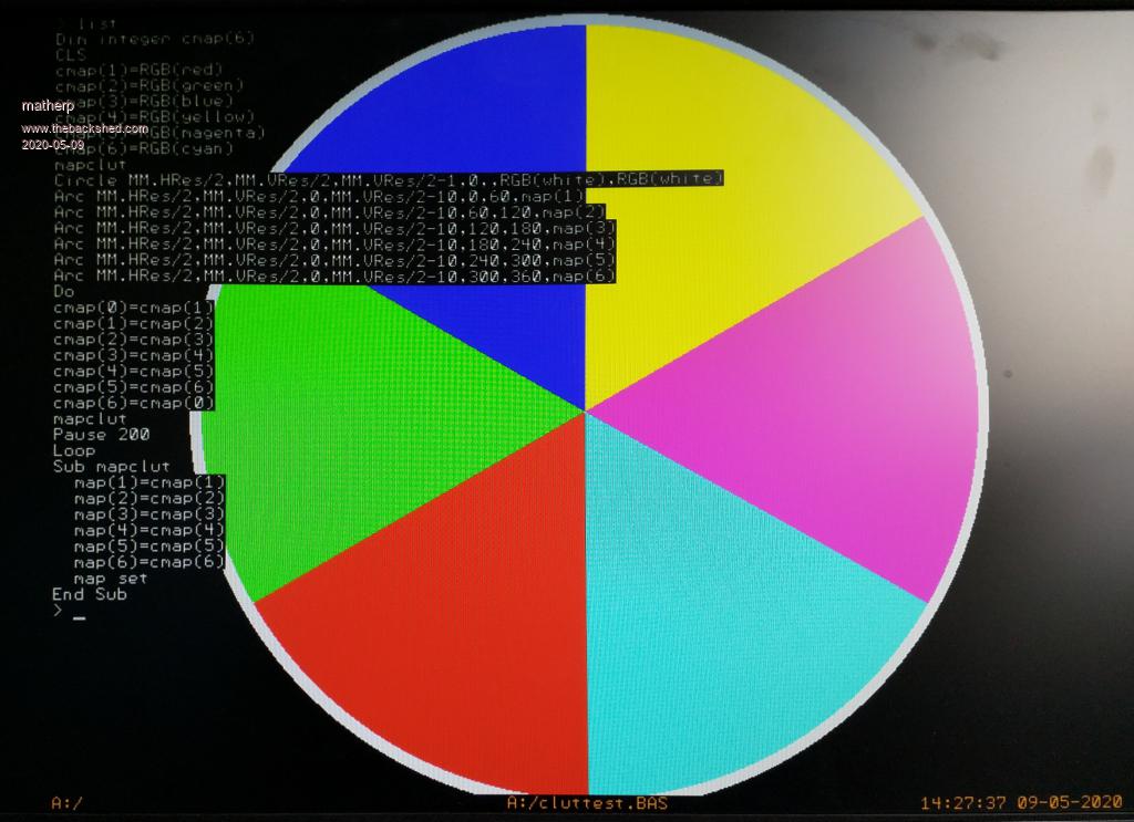

In this post we look more at the Colour LookUp Table (CLUT) and the MAP command and function and use them to create a rotating colour disk
As explained earlier, 8-bit colour modes use a lookup table to convert from a single byte of information to the RGB565 pixel that will be displayed. In the CMM2 firmware the 8-bits are treated as a RGB332 pixel and are mapped to the most appropriate RGB565 value.
However, we can override this using the MAP command.
Normally a pixel that is set to zero would mean that it would be black on the screen but if we use the commands
MAP(0)=RGB(RED)
MAP SET
Then every "black" pixel on the display will instantly turn red. Actually it isn't quite instant as the MAP SET command waits for the next frame blanking period before making the change. So MAP(n)=colour primes the colour change and MAP SET enacts it. This allows us to change a number of colours simultaneously by using multiple MAP(n)=colour commands and then a single MAP SET.
To use our new colours in a drawing command we use the MAP(n) function. So for example if we type MAP(134)=RGB(148,73,66) to get some particular shade then to use that colour we would reference it as MAP(134)
e.g.
MAP(134)=RGB(149,73,66)
MAP SET
TEXT MM.HRES\2, MM.VRES\2,"Hello",CM,,5,map(134)
This would display the text in a dark brown colour. If we then typed
MAP(134)=RGB(BLUE)
MAP SET
The text would immediately turn blue as would any other pixels on the display set to 134.
There a couple of other MAP commands
MAP MAXIMITE sets the CLUT to mimic the colours of the original Colour Maximite. i.e. 0-7 are the Maximite primary colours.
MAP RESET restores the original RGB332 mapping
Now lets look at using the MAP command to create the colour wheel above
' Set up an array to hold the colour mappings we are going to use
Dim integer cmap(6)
'Clear the screen
CLS
'Set up 6 colours in the array
cmap(1)=RGB(red)
cmap(2)=RGB(green)
cmap(3)=RGB(blue)
cmap(4)=RGB(yellow)
cmap(5)=RGB(magenta)
cmap(6)=RGB(cyan)
' Do an initial update of the CLUT to set up our colours
mapclut
'Display an outer circle in white
Circle MM.HRes/2,MM.VRes/2,MM.VRes/2-1,0,,RGB(white),RGB(white)
' Now draw a simple colour pie chart using our new colours with the ARC command
Arc MM.HRes/2,MM.VRes/2,0,MM.VRes/2-10,0,60,map(1)
Arc MM.HRes/2,MM.VRes/2,0,MM.VRes/2-10,60,120,map(2)
Arc MM.HRes/2,MM.VRes/2,0,MM.VRes/2-10,120,180,map(3)
Arc MM.HRes/2,MM.VRes/2,0,MM.VRes/2-10,180,240,map(4)
Arc MM.HRes/2,MM.VRes/2,0,MM.VRes/2-10,240,300,map(5)
Arc MM.HRes/2,MM.VRes/2,0,MM.VRes/2-10,300,360,map(6)
' Start a never ending loop
'each time round the loop move the colours in our array one place to the left
' Use array element 0 to store the first element that is going to be at the end
  cmap(0)=cmap(1)
  cmap(1)=cmap(2)
  cmap(2)=cmap(3)
  cmap(3)=cmap(4)
  cmap(4)=cmap(5)
  cmap(5)=cmap(6)
  cmap(6)=cmap(0)
' reset the colour map
  mapclut
' pause so we can see the change
  Pause 200
'This subroutine updates the colour map for the colours we are using
'  set map positions 1 to 6 to the new colours
'  then apply the change
Sub mapclut
 map(1)=cmap(1)
 map(2)=cmap(2)
 map(3)=cmap(3)
 map(4)=cmap(4)
 map(5)=cmap(5)
 map(6)=cmap(6)
 map set

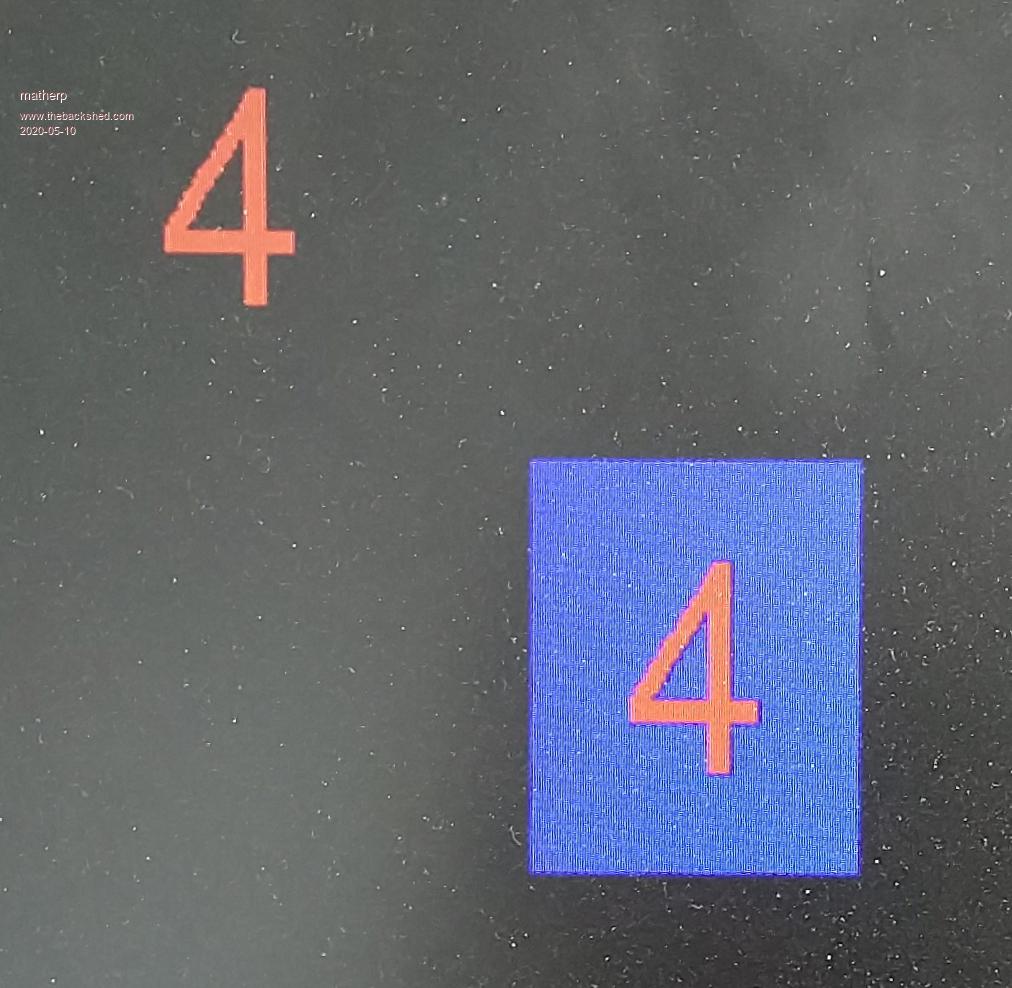

CLS
' draw a large number 4
text 100,100,"4",,6,,rgb(red)
' draw a colour box
box 180,180,72,90,0,rgb(blue),rgb(blue)
' move the text but only non-transparent (non-zero) pixels
blit 100,100,200,200,32,50,,4
do:loop

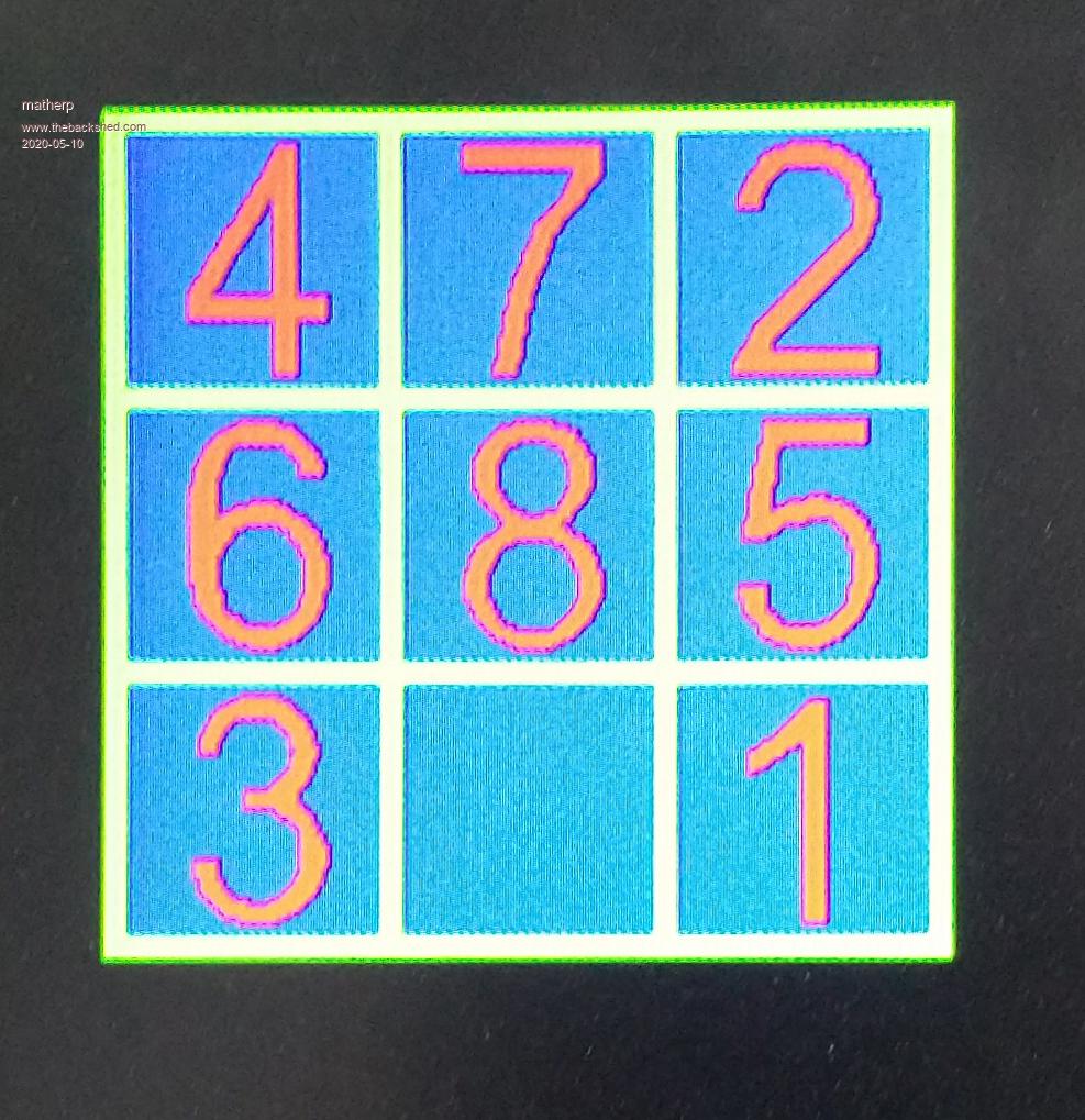

Another example needed. We can use BLIT to create the basis of a sliding block puzzle
'set output to page 1
page write 1
' clear page 1 to blue
cls rgb(blue)
'write the numbers 1 to 8 spaced 50 pixels apart
' font 6 is 32x50 pixels
for i = 1 to 8
   text i*50+10,0,str$(i),,6,,rgb(red),-1
next i
'now we want to randomize the numbers for our grid including the missing one
dim r(8)=(9,9,9,9,9,9,9,9,9) 'create an array to hold the positions
for filled=0 to 8
 do
   test=rnd(8) 'get a random number between 0 and 8
   for j=0 to filled 'check all the filled cells to see if we have already used this number
     if r(j)=test then test=9 ' if yes then set no-good
   next j
   if test<>9 then r(filled)=test 'if OK then store the number
 loop while r(filled)=9 'loop until that cell is filled
next filled
'Now we will go back to the view page
page write 0
cls
' create a background for the grid
box 100,100,170,170,0,rgb(green),rgb(green)
' now copy the randomised numbers into our grid
for x=0 to 2
 for y=0 to 2
'get the x position of the randomised number in page 1
   xsource = r(x * 3 + y) * 50
' blit the number from page 1 to page 0
   blit xsource, 0, x * 55 + 105, y * 55 + 105, 50, 50, 1
 next y
next x
This simplistic example is how Mauro weaves his magic. You can create any useful graphics you want on one or more hidden graphics pages. Then you can use BLIT to move parts of the image between them, including potentially onto page 0. And, of course, you can mirror or rotate the parts of the image as you move them.
There are two more BLIT commands in the manual: BLIT READ and BLIT WRITE, but we will leave these until we deal with sprites.
Next post will look at the various graphics modes supported by the CMM2.

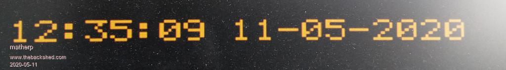

Mode 2 displays 640x400 pixels but the monitor sees 640x480. This is achieved by increasing frame blanking by 80 lines split between the top and bottom (front porch and back porch in the jargon). The memory used is 640x400 pixels and this is arranged exactly like we saw for mode 1 earlier, top left to bottom right.
Mode 4 displays 480x432 pixels for Maximite compatibility. This is achieved by reducing the pixel clock to 31.5/640*480 = 23.625MHz but maintaining the same absolute durations for line and frame blanking periods. In this case frame blanking is extended by 48 lines split between the top and bottom. The change in pixel clock rate isn't a perfect solution, particularly with LCD monitors. These work by splitting the period between HSYNC pulses and sampling the analog signal at the expected pixel rate. So they are sampling at 31.5MHz and we are changing values at 23.625Mhz. They then need to map this to the physical screen resolution (say 1280 pixels) so, depending on the monitor, you may see slight artifacts.
Notice how the left side of the "0" in "11-05" is wider than the right. This is a monitor sampling issue and probably wouldn't occur on an old analogue CRT monitor. The memory used is 480x432 pixels and this is arranged exactly like we saw for mode 1 earlier, top left to bottom right.

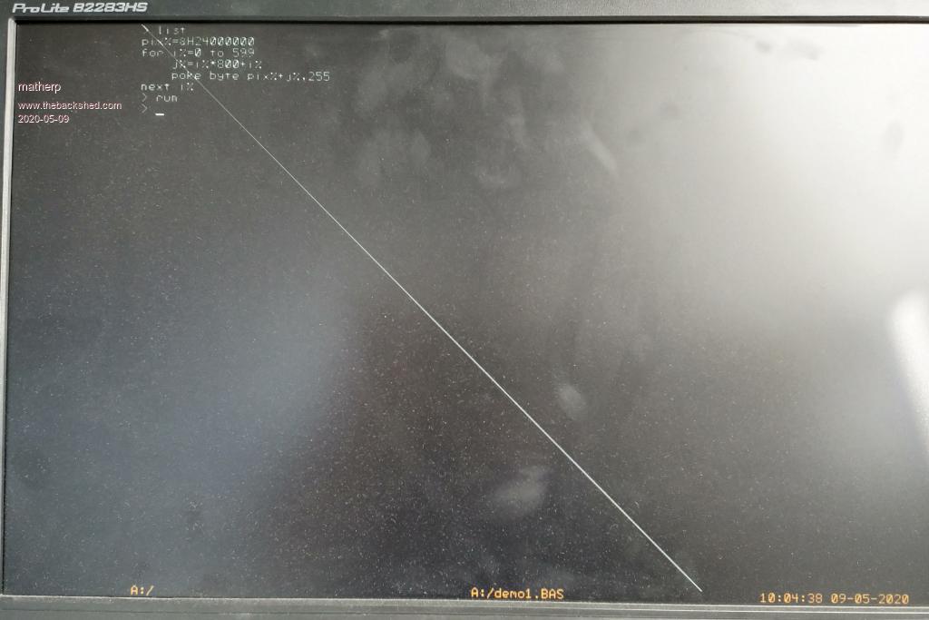

for an 8-bit colour depth:
add1% =MM.INFO(page address 0)+ (y * 2) * MM.HRES + x
add2% =MM.INFO(page address 0)+ (y * 2 + 1) * MM.HRES + x

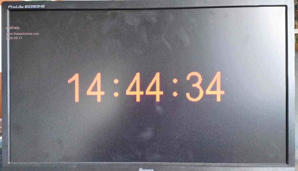

Lets build a very simple digital clock with big digits using the frame interrupt and show that there are never any screen artifacts
' set to 320x200 mode, with a frame interrupt
' NB the background colour must be specified but is ignored in this mode
mode 3, 8, 0, frameint
' set a global variable that will be updated by the frame interrupt
fi%=0
' loop forever
do
  do
  loop while fi%=0 'wait until the frame interrupt has happened
' write out the time in the middle of the screen
  text mm.hres\2, mm.vres\2, time$, CM, 6,, RGB(red)
' prime ready for the next interrupt
 fi%=0
loop
sub frameint
 fi%=1
end sub
Note that I am not doing any screen updates in the interrupt routine - you wouldn't do that would you? Interrupts must always be kept short and the best approach is always to set a flag that can be processed in the main program.

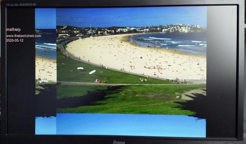

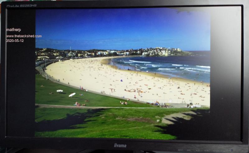

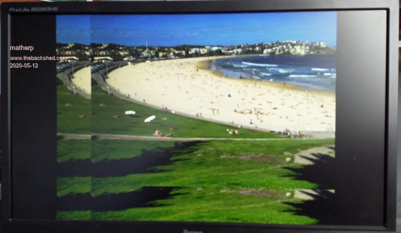

PAGE SCROLL
PAGE SCROLL does what it says. It scrolls a selectable page (doesn't need to be page 0) horizontally and/or vertically by a selectable amount. In addition it allows you to control what happens to the area vacated by the action of the scroll.
PAGE SCROLL pageno, x, y [,fillcolour]
Some examples:
LOAD JPG "bondi":DO:LOOP
load a sample jpg in 800x600x16 resolution
LOAD JPG "bondi":PAGE SCROLL 0, 100,100:DO:LOOP
scroll the picture 100 right and 100 up, moving the scrolled off area to the now vacated part of the screen. Note that the vertical move always happens first. If you need the sideways move first you will need to use the command twice.

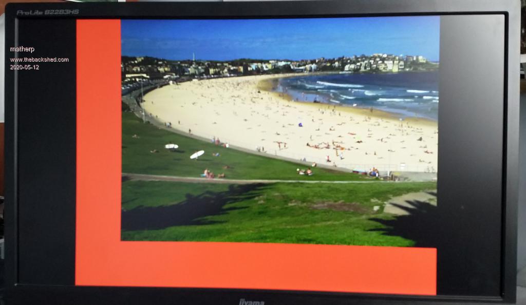

LOAD JPG "bondi":PAGE SCROLL 0, 100,100,-1:DO:LOOP
scroll the picture 100 up and 100 right, leave the vacated off area as-is
LOAD JPG "bondi":PAGE SCROLL 0, 100,100,RGB(RED):DO:LOOP
scroll the picture 100 up and 100 right,replace the vacated area with a fixed colour
Time to load a 800x600 full colour jpg was 347 milliseconds
Worst case time to scroll the image with image wrap was 125 milliseconds. All other lower resolutions or lower colour depths will be faster.
Of course moving a 800x600 image with 2 bytes per pixel takes a little time but try this example program at 320x200x16

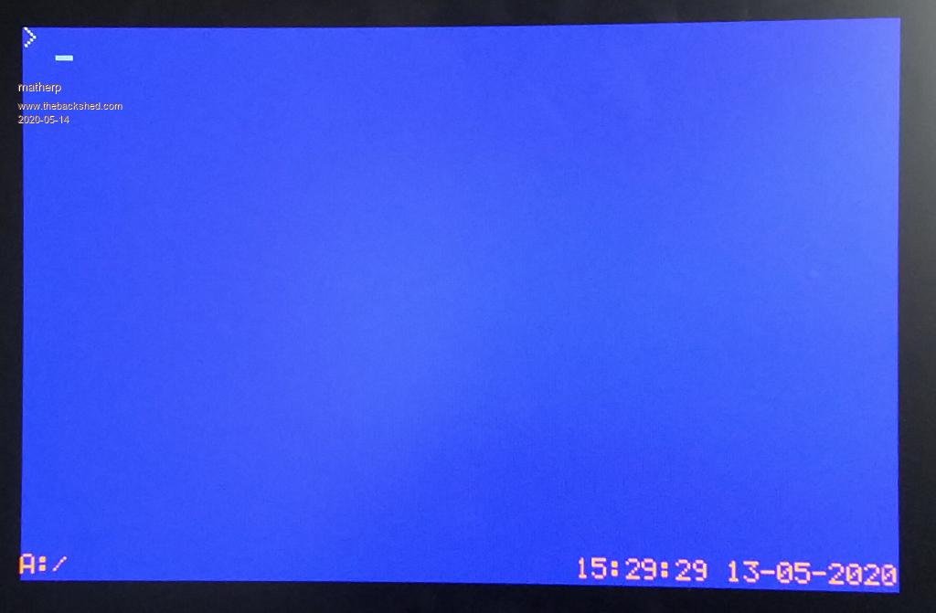

In 12-bit colour mode the CMM2 supports three layers. This is a property of the processor chip itself.
The bottom layer is just a single colour background and to set the colour we specify it in the MODE command.

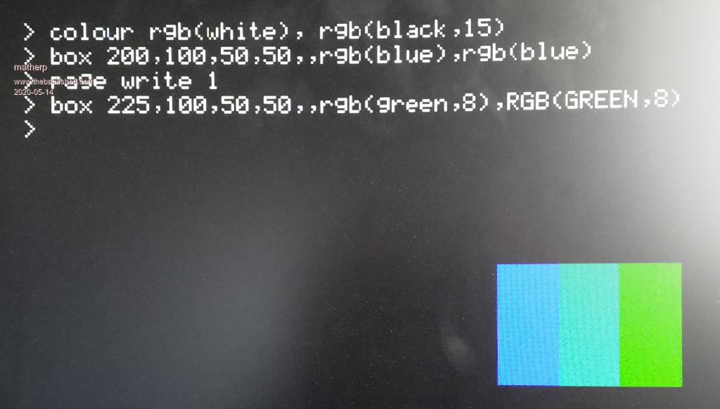

MODE 3,12,RGB(blue)
Will put a blue over the screen. Note how, as we are at the command prompt, the status line and command prompt overwrite the background, but it shows through the unset pixels in each character.
To change the background colour you can just use the mode command again with the new colour. Other information on the screen won't be affected (NB: V5.05.02RC26 or greater)
The status line and command prompt are writing to the second layer of the three layers and the data for this layer is stored in page 0
The data for the third and top layer is stored in page 1. Unless pixels are set to have some transparency (more on this later) any information written to layer 3 (page 1) will block out layers 1 and 2.

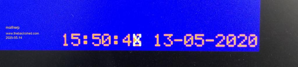

We can prove this. Type:
PAGE WRITE 1: TEXT 247,190,"X":page write 0
We have to do the command as a single line to avoid the status updating while we are writing to page 1
Note how the "X" appears to have overwritten the brown seconds units but the seconds are still incrementing underneath and pixels that are not covered by the "X" show normally
Now type:
PAGE WRITE 1: TEXT 247,190," ":page write 0
The "X" disappears and the seconds continue incrementing normally.

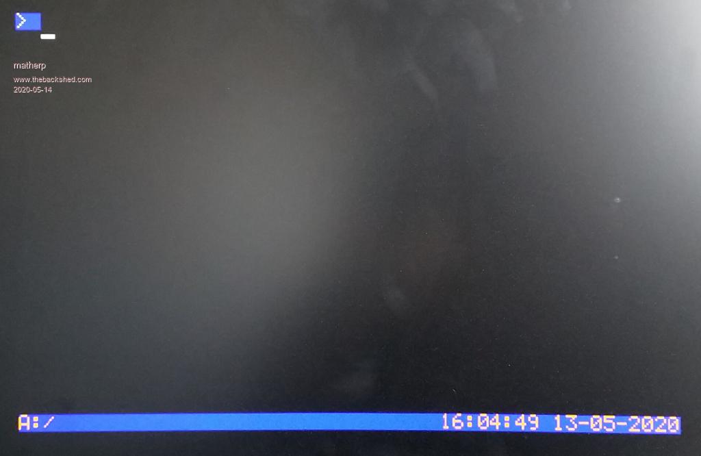

Black, i.e. the pixels in text that aren't set, defaults to being a completely transparent colour.
Now type
CLS RGB(black,15)
Check out the RGB function in the user manual. We have asked the system to clear the screen but to use a non-transparent black. Valid transparency values are from 0 to 15 where 15 is a solid colour. However, the default background colour is fully transparent black so the characters associated with the command prompt and the status line still show the blue colour.
Now try:
COLOUR RGB(WHITE), RGB(BLACK,15)
We have set the background colour to solid black rather than transparent black and now the blue colour on layer 1 has gone completely (NB: V5.05.02RC26 or greater).

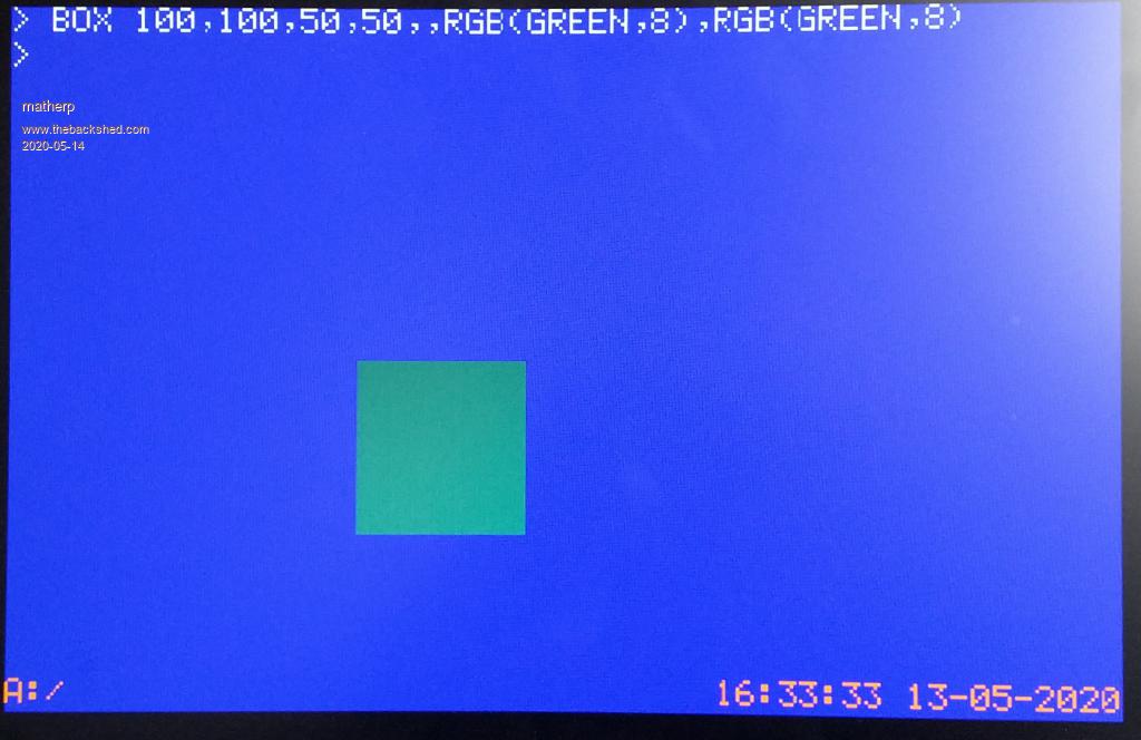

Lets play a bit more with transparency
The blue square on layer 2 (PAGE 0) is partially overwritten by the green square on layer 3 (PAGE 1) which is set to 50% transparency. Where the squares overlap we get CYAN
We could do the same thing with layer 2 and the background layer 1
That should give you a good understanding of 12-bit mode (ARGB4444) and how the "A" transparency can be used to create interesting effects. The most important thing to note is that in 12-bit mode the CMM2 is displaying information from two pages at the same time (PAGE 0 and PAGE 1) plus a fixed background colour. Information on PAGE 0 will overwrite the background depending on the transparency of each individual pixel on PAGE 0. A transparency of 0 will have no effect. A transparency of 15 is a solid colour and will overwrite completely. Information on PAGE 1 will overwrite both the background and PAGE 0 depending on the transparency of each individual pixel.

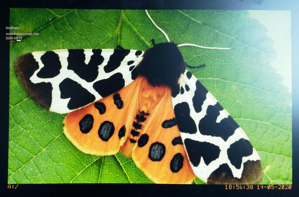

In this post we will look at the pros and cons of the image formats supported by the CMM2: jpg, gif, png, and bmp
We will start by putting the CMM2 into MODE 2,16 i.e. 640x400 RGB565 and for testing purposes I have saved the same image in all 4 formats
File sizes are as follows
> list files "caja.*"
A:/
18:50 14-05-2020     768054  caja.bmp
18:50 14-05-2020     217064  caja.gif
18:49 14-05-2020     233823  caja.jpg
18:51 14-05-2020     506373  caja.png
0 directories, 4 files
And times to load in milliseconds
> mode 2,16
> timer=0:load bmp "caja":?timer
541.699
> timer=0:load gif "caja":?timer
728.09
> timer=0:load jpg "caja":?timer
216.345
> timer=0:load png "caja":?timer
509.873
So JPGs are small and load much faster than anything else. The reasons for this are twofold; first there is less data to read from the SDcard, second the STM32H743 includes a hardware jpg decoder so the CPU isn't used.

IMAGE RESIZE and IMAGE ROTATE use some fairly complex math to scale and rotate images. They are therefore comparatively slow compared to actions like page copies but useful nevertheless. An example of rotation is available here. In fact this was done on an early release of the code and various enhancements have speeded it up somewhat since then.
As an example of their use lets take an 800x600 image that is in landscape and scale and rotate it to a 600x450 image in portrait. This then gives us the worst case timings for the two functions - biggest image, highest colour depth.
tigerside800.zip
'Set to 800x600 16 bit mode
' NB to use this mode it must be unlocked first with OPTION MODES UNLOCKED
mode 1,16
page write 1
' lets see how long it all takes
timer=0
'load our 800x600 image to page 1
load jpg "tigerside800"
page write 0
print @(0,0)"Time to load JPG"
print timer/1000, "seconds"
timer=0
page write 1
'When we rotate the image it can't be more than 600 pixels high so resize it
'Check the manual for syntax but we are specifying to resize it and place the resized image centrally over the old image
image resize 0,0,800,600,100,75,600,450
page write 0
print "Time to resize"
timer=0
page write 1
'Now we need to rotate the image
'In the case of the example this is a rotation of 270 degrees clockwise to get it the correct way up
' Note that the rotated image has to fit into a new area no bigger than the area to be rotated
'So we need to rotate a square area as big as the biggest dimension we need in the result
image rotate 100,0,600,600,100,0,270
page write 0
print "Time to rotate"
timer=0
'Now we can go back to page 0
page write 0
' Copy the part of page 1 containing the rotated image to page 0 using BLIT
blit 175,0,175,0,450,600,1
print "Time to copy"
do
loop
One important thing to note is that resizing and rotating by definition lose some information and accuracy. For this reason if you want to do something like the rotating image in the video you should do each rotation from the original rather than incrementally rotating the previous result otherwise the image will quickly degenerate.
