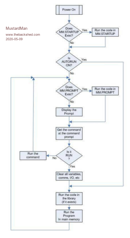

Perhaps it is the autorun getting there first... I know I saw a flowchart of what happens at turn-on / reset, but for the life of me I can't find it. The documentation is quite good, but it is horribly scattered and you need to peruse several manuals and collate all the tidbits from each.
Since the Explore 100 has no ICSP header by default, looks like it is out with the soldering iron and brushing up on MPLAB for me!

The flowchart is on page 47 of the latest Micromite User Manual.
MustardMan
Joined: 30/08/2019
Posts: 175
Posted: 12:57am 09 May 2020
Finally found that flowchart...
Looks like the AUTORUN test is pretty early on.
