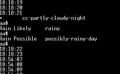

Does anyone know how to get this to store before sending it to the aa$?
At the moment it doesn't seem to be storing it before going to the sub decode
The last field is always a *
it seems to be printimg 3 times
DIM aa1$,b$,c%
on error skip
udp server 4997
do
on error skip
UDP receive aa$,b$,c%
if c%>0 then
  DECODE
end if
ss$=mid$(time$,7,2): IF ss$ <> sec1$ THEN: sec1$ = ss$: print time$ : ENDIF
loop
on error skip
udp close
SUB DECODE
a1$ = FIELD$(aa$,1)
a2$ = FIELD$(aa$,2)
a43$ = FIELD$(aa$,43)
a50$ = FIELD$(aa$,50)
print a1$, a10$, a43$, a50$
print "Fin"
END SUB
This is the output
Edited 2020-12-13 04:08 by lew247

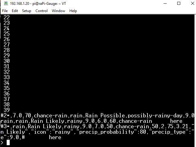

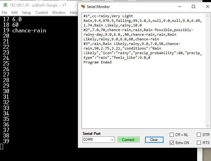

lew247
Joined: 23/12/2015
Posts: 1709
Posted: 11:16am 13 Dec 2020
Nope
I've tried literally everything I can think of
I've made the ESp32 send
*string1#
#string2#
so it's easy to identify the start and end of each string
but nothing works
If there was only one UDP string and it was shorter then it would be fine because I can get that working perfectly
There's no way to tell the received UDP string to do 2 different things, I've tried case select, field$, if/then but none of it works properly
I think I'm going to have to use serial instead
