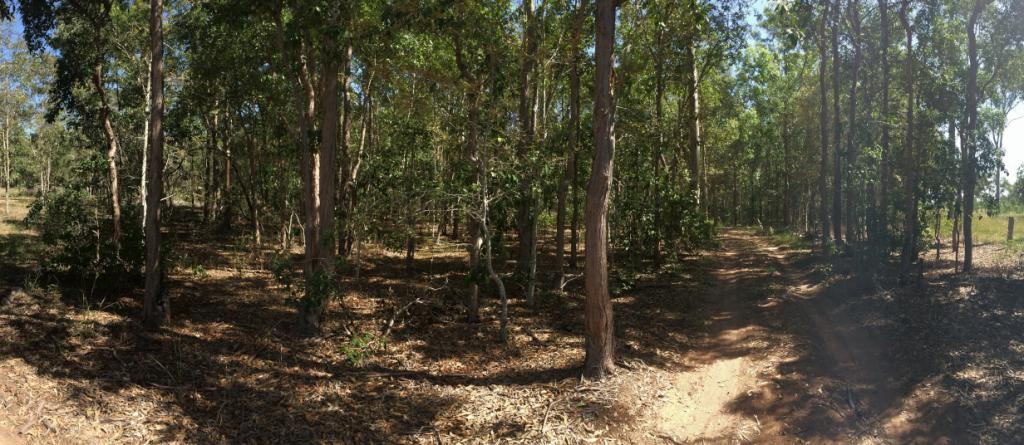

I have some sheds down the back I'd like to extend my network to. The block has a gentle slope up hill toward the sheds and through trees. Here is a photo:
I'd prefer not to trench and pull cable.
What's the best way to do do this wirelessly and cheaply? Does anybody have experience? It's approx 200m in total.

Sorry I cant offer a decent WIfFI solution, especially as it doesn’t look like you have line of site.

Cheapest decent wireless link would be something like a set of Ubiquiti Nanostations, but I really don't like your chances of punching a wifi signal through 200m of trees that thick.
Might get away with it if you cable a few meters either end and put the wireless link in that clear paddock?

Do trees selectively absorb vertical-polarised RF ? I am wondering if say horizontal or helical aerials would make a difference with the vegetation ?
Maybe do a check of reception range without the trees ?

I know you don't want to trench it all, but wireless is a long shot in 200m of trees without spending a kings ransom on kit -and it can be quite variable.
I would get a mate with a mole plough (or rent one) of some flavour, dig in some 8-pair (plenty of spare for other stuff... telephone, alarm etc...) armoured UTP about 100m from each end, run power in one of the trenches. Meet in the middle with an ethernet hub in a little IP54+ cabinet bolted to a tree. Try 4 pairs for a stretch to gigabit, if no good then 100mbit should work (and almost certainly 10)
Earth the armour (gives a bit of a shield), go down about a foot and right in the middle of the track so you remember where it all is. Should do a 200m run OK. Might get a bit of a voltage drop on the AC line so make sure the hub has a SMPSU.
's what I'd do... a day's work if you are lucky and don't hit snags.
lost faith in wireless+trees ages back... get it all working then it is rainy and windy and it all goes to pot.

I maintain 4 Ubiquiti links for my clients, with one having 3 of those links.
The one of particular interest is the 400mm Powerbeam that connects me to their office.
Only 1.24km, but man does it have to punch thru some trees...
Schools, Sports Grounds & a tree lined easement.
It's sitting around 25Mbps this morning, but once a few leaves drop it will climb back up over 200.
A few tests previously had shown it was pretty impressive at short distances in thick scrub over a few 100 m's range.
