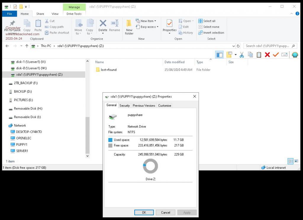

I have got a copy of Puppy talking to W10 this afternoon to kill some time in lockdown:
I just threw a spare 250GB WD Blue drive on the machine for testing purposes.
Happily, W10 picked up on THIS Puppy build right away in network neighbourhood.

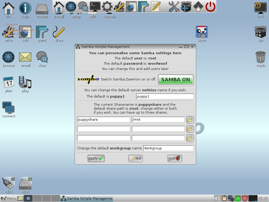

This is the latest Slacko Puppy 6.3.2, and I note differences in the icons, background, and that Samba Simple Management now lets you set the workgroup, which I don't THINK earlier versions of this Puppy did.  Perhaps that was why it was so hard to see the share in W10, as without the workgroup being the same as all the other PC's, Windoze just does not think it is SUPPOSED to be a part of this network group.
I have reset the Puppy AND Samba passwords from the defaults shown in the image above, confirmed by my being prompted for those by Windoze, and it accepting those new ones.  This required use of the scary Linux console, but I am getting less frightened of the console, the more I use it.
I just know that you can do very destructive things in the console if you are sure about what you are doing.  But then, the same could be said of Windoze command-prompt and diskpart or format commands with switches set to no prompting, so....

@ Volhout: I used the latest Slacko 6.3.2 distro.  Yes, earlier ones did not include the excellent Simple Samba Management utility.  Any of the recent ones have it though, including Bionic Pup 8.0
I just used the Slacko one, as it was one I THOUGHT I was familiar with, but the latest version has changed several of the GUI aspects, so I probably should have just used Bionic64!
This one is only an experiment anyway, so it won't be getting kept, as I was just playing about with Samba vs W10 etc and sharing files.
Yes, always root in Puppy, so as you say - only the Samba password needed, but that keeps it simple and easy, and with a decent alpha-numeric password, I feel that is fine for a home server.  I keep my AV and Malware Bytes up to date, and have scheduled scans so I feel REASONABLY confident no-one other then me here at home can get access to it.

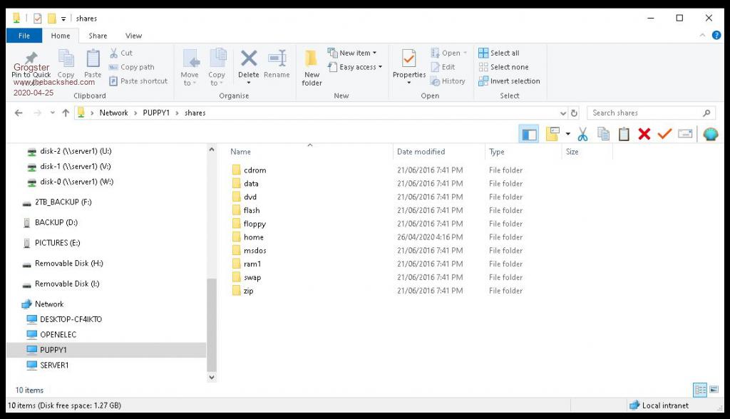

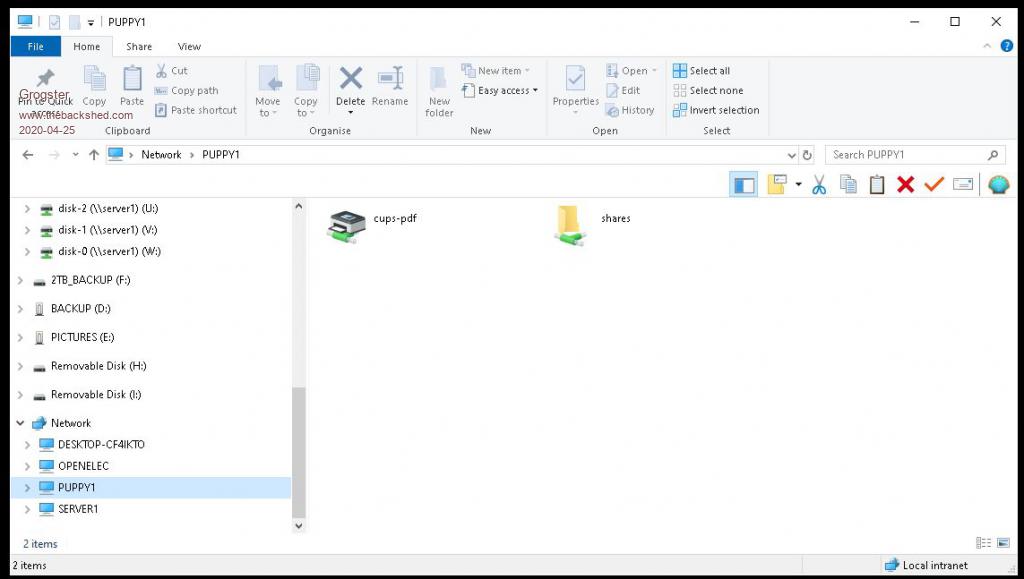

UPDATE:
I have installed Puppy Linux (Slacko64 6.3.2) on a different computer, but kept the network specs the same as the experiment I ran the other day, and W10 has no problem seeing it.  I have no HDD's on this box yet, but W10 can see the shares.
...and the 'shares' folder opened:
Note that there is no /mnt folder here, as I don't have any HDD's connected, this system is just running from the USB flash drive.
