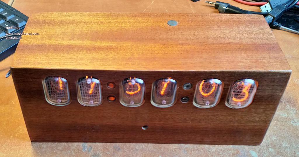

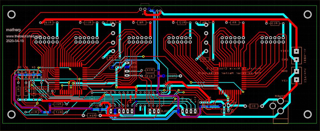

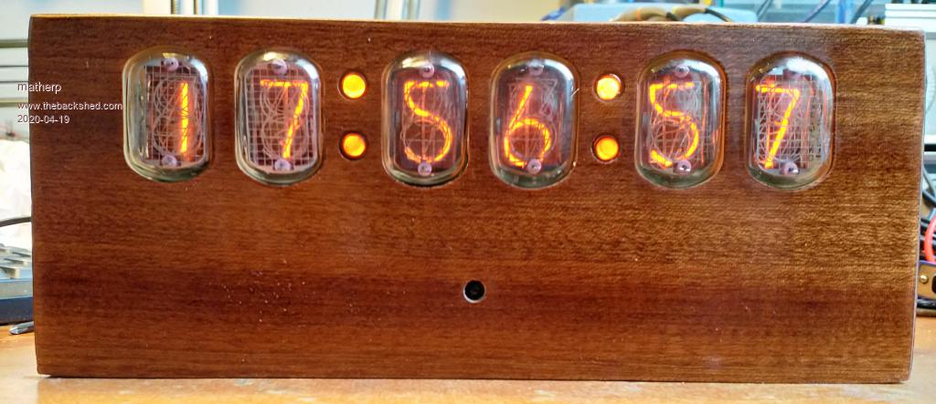

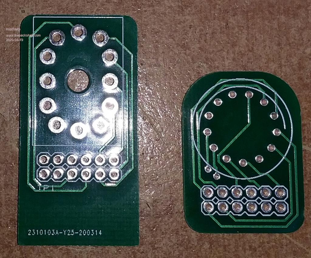

Ages ago I designed a PCB for a Micromite controlled Nixie clock. I revisited the design recently and have made one. The schematic and main board layout are below.

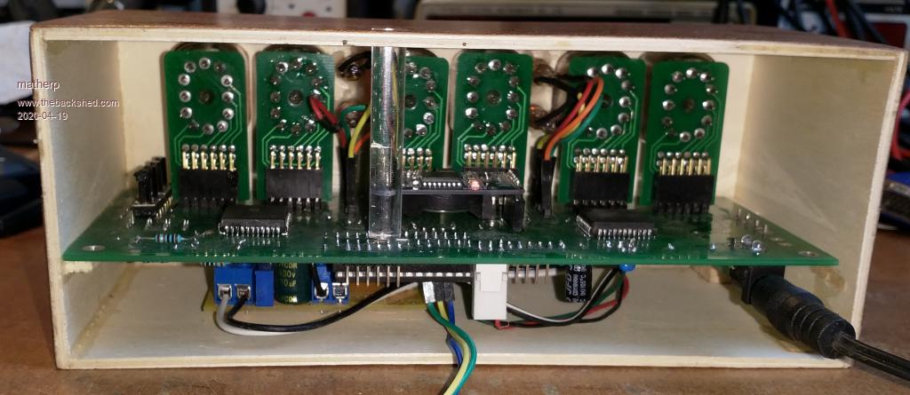

The design uses a DS3231 module as the time source with the option of a GPS input or a 1PPS source.  It uses a TEMT6000X light sensor to support automatic dimming. You can see the light pipe I use to bring the outside illumination to the sensor.
The big change from the previous design was to mount the Nixie tubes on separate small PCBs. This allows various different tubes to be used. The current version uses IN-12A but I've also developed PCBs for the IN-14. The IN-12A can be mounted vertically like I have done or flat against the main PCB. All gerbers are attached.
The important component is the HV5530. This is a 32 channel high voltage open collector driver. Two of these are chained together to support 6 digits (6 x 10) and 4 "dots". The unit takes a 12V supply from a standard Walwart and then uses a DC-DC converter to generate the 180VDC needed to fire the Nixie tubes.
Control of the clock is via an IR receiver which I've mounted on the front panel. The PCB also supports a DS18B20 to allow temperature to be displayed.
The code is currently primitive and doesn't include the support for the IR receiver but is enough to run the clock and auto-dim. The dimming supports a cut-off such that the seconds tubes are not lit at night. Current version of the code below. The only important bit is the tables that map the outputs on the HV5530 to the individual numbers. Other than that anyone who built the clock could program any variants they want. Of course the display could be used for outputting any numerical information not just time and temperature.
Enjoy

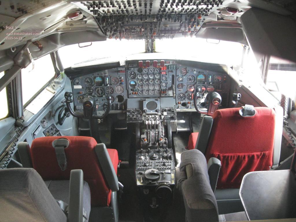

BTW, did any aircraft use nixie tubes in their instrumentation displays at one time or another?
Keep safe
Brian

Brian ... I can't think of any nixies anywhere. It would have had to have been back in the days of piston engines and props and the glass structure with high voltage bouncing around inside would not have been conducive to peaceful coexistence with gasoline tanks.
The first 707-100s and DC8-100s didn't have any alphanumeric displays at all, just analog pointers or dials and indicator lights everywhere. Here's a photo of the cockpit of a B707-123B built in 1959. Nothing but meter movements, synchrotel pointers or cards and lights.
Paul in NY
