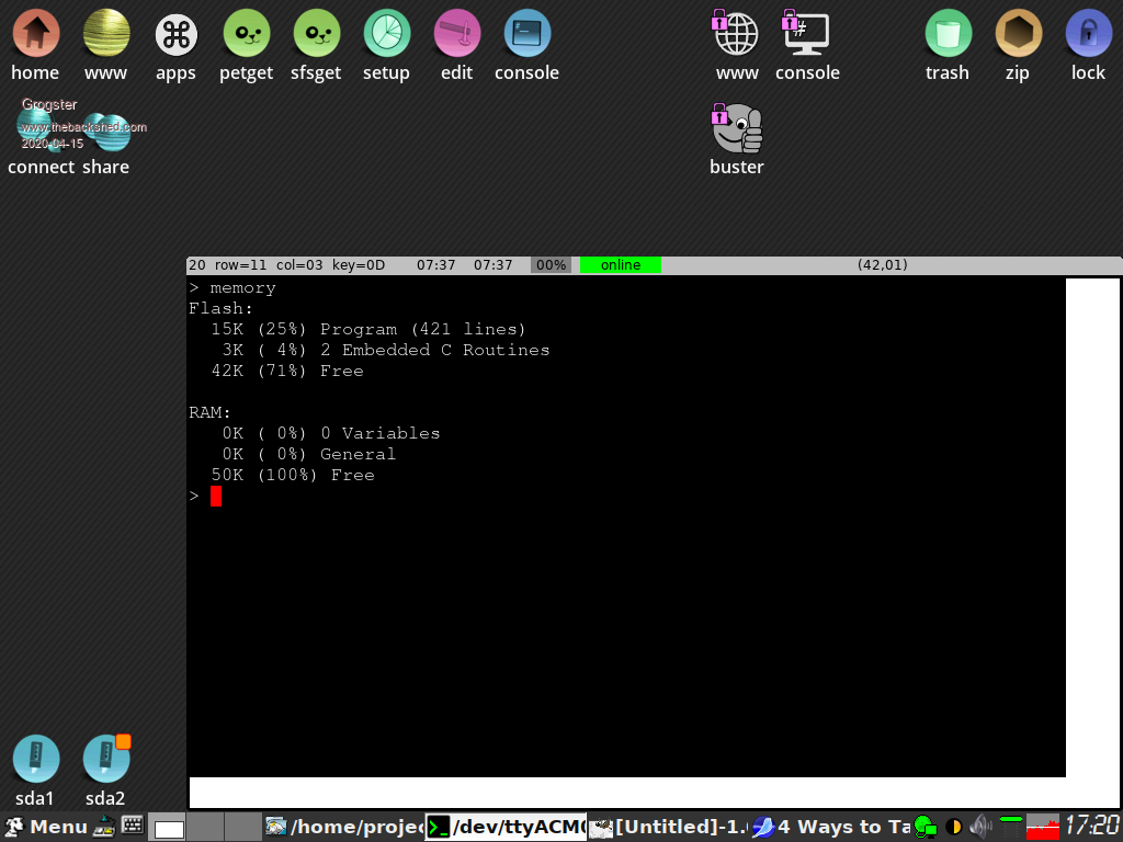

Runs fine in EasyOS 2.2 - which is a linux similar to Puppy, but not puppy.  It is being developed by Barry, the same guy that created Puppy Linux, and Puppy is now being developed by the community.
Talks to an E28 fine on the usual /dev/ttyACM0, BUT I cannot move the window at all - it is stuck there as in the image, and I cannot move it like other windows.
There is also no minimize,window and close buttons, so the only way to get rid of it is to right-click the tab on the taskbar, and select KILL.
It does work fine though.
Posts: 10081
Posted: 08:01am 15 Apr 2020

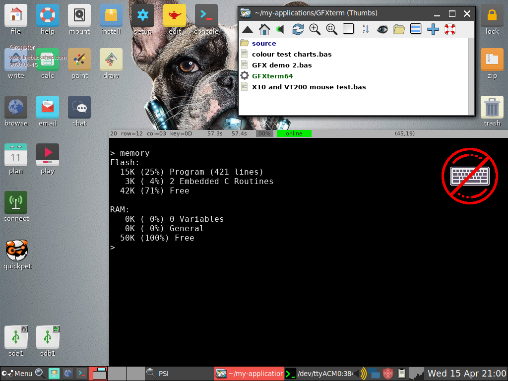

Also works fine on the latest Puppy Linux(bionic puppy x64):
Again, no way to move the window as above, but it IS working.
Right-click on the application in the taskbar, and select CLOSE or KILL.
Other then that, it is working well.  The font for GFX is nicer under Puppy then the thin one in Easy, but both are working.

   give this version a try:
GFXterm64 (15-april-2020_A).zip
have been testing on EasyOS 2.2 this evening (downloaded the iso and ran from a flash drive). am quite impressed, it is a pretty neat linux variant!
the white strips on right side and bottom edge are now gone, and the application no longer hogs focus. this appears to have been an issue with EasyOS not liking a form that has BOTH the 'Scaled' and 'AutoSize' properties set true. i just set 'Scaled' to false on the main form and things seemed to come right - this should probably have been set false anyway.
the title bar is still missing, this appears to be a bug in EasyOS in the way it handles the BorderStyle of a form. bsSingle (which is what GFXterm uses) is interpreted as bsNone. i'll work on an aesthetically pleasing solution to this, in the mean time i've added an 'exit' option to the right-click menu.
for the moment, you can move the window by right-clicking on the application in the taskbar and selecting MOVE.
i'm extremely relieved now to see that GFXterm runs on other than linux mint/xfce. EasyOS probably represents an extremely good test!
rob   :-)

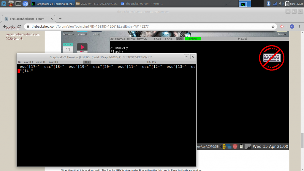

I installed GalliumOS on my Chromebook, and tried your GFXterm64.
I execute it by double clicking the icon.
It starts up right away, but it does not connect to the MX170 I have connected.
Checked my setup, and debugged using Putty. Putty connects at /dev/ttyACM0 and 38400 baud.
See attached screenshot.
I pressed the function keys, and these show associated text.
When I type "list" and return, nothing happens, although there is a program in the MX.
Does this have something to do with running as root ? or adding the GFXterm to the dialout group ?
I'll play with that for a while,,,,,
I noticed there is only one file in the folder where GFXterm64 is located, IS there no configuration file or so??
I tried
sudo ./GFXterm64
and
sudo ./GFXterm64 /dev/ttyACM0
both give same results... no connection.
Edited 2020-04-16 06:40 by Volhout

hi Volhout,
   to connect the micromite you need to right-click and select 'CONNECT' from the popup menu, then enter the path to the serial device into the query box. if the green "online" flag above the terminal area isn't lit, then you are not connected and GFXterm will just loop back keypresses to the screen (a bit like a typewriter).
am working on getting font selection available, so should have another updated version soon. there is no configuration file yet, that is something else to do.
rob   :-)

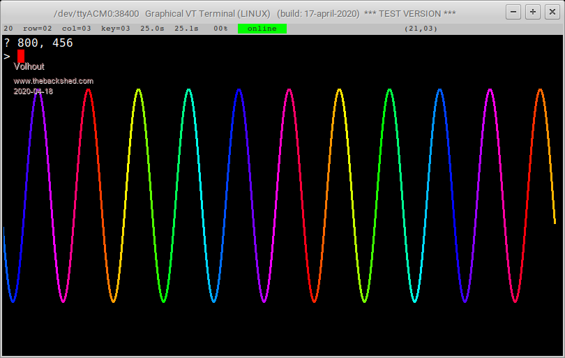

How can I use the graphics functions ? Can I draw lines ?
P.S. this is tested on Gallium OS (a pre configured Xubuntu 18.04 (amd64), especially for chromebooks with intel processors) on a Acer C720 chromebook.
Edited 2020-04-17 05:47 by Volhout
Posts: 2554
Posted: 10:26am 17 Apr 2020
the graphics are pretty simple to use, with less than a dozen different commands. all commands are preceded with chr$(16), and terminated with chr$(13) (optionally followed by a chr$(10)). everything is in plain text, and command names can be abbreviated to a single letter (eg, "C" and "clear" work the same). parameters can be separated by tabs (a comma in basic print statements).
the simplest thing to do first off is define the following three constants at the start of your code:
Const GFX=Chr$(16)
Const ENQ=Chr$(5)
Const ACK=Chr$(6)
graphics commands will then look like:
Print GFX "ink" 255, 255, 0, 7
Print GFX "line" 100, 100, 100, 300
the above  two lines: (1) selects yellow ink with a pen width of 7 pixels, then (2) draws a line from coordinate (100,100) to coordinate (100,300).
see the examples and list of commands in the attached zip file:
GFX command list and demo.zip
the two example .bas files show how to draw cirlces, scroll the graphics area, clear the graphics plane, etc.
note: the colour (0,0,0) is transparent. all graphics hover over the text plane, and the two planes scroll independently. to get the size of the graphics plane in your program use:
Print GFX "?"
Input Gw, Gh
the codes ENQ and ACK are used to regulate the speed of your program so it doesn't end up sending graphics commands too quickly (see the examples). in general, it would be difficult for any normal program to require this; the graphics are largely there for creating graphs of data that your program produces.
press alt-C on the keyboard at any time to clear the graphics plane.

Works very nice !! Tried your demo's, and played with it a bit.
Nice that you can indendently clear the text screen (ctrl-C) and the graphic screen (alt-C).
