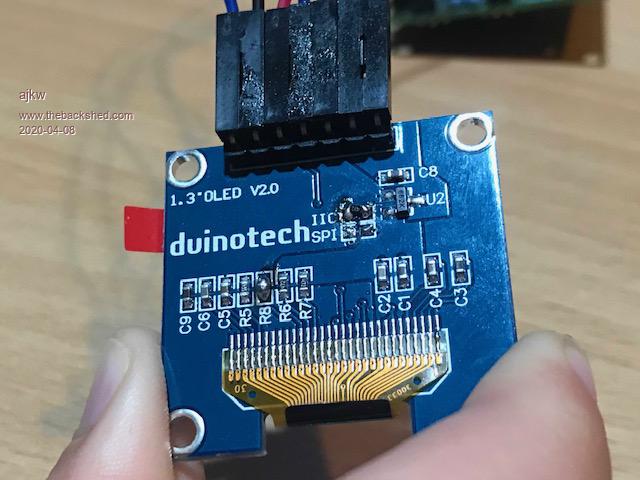

The first trick was to swap the display from SPI to I2C,  to do this the resistor on the SPI pad had to be moved to the I2c pad and R8 needed to be shorted.

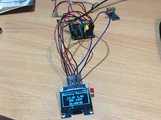

Matherp's driver was loaded and away it went. Thanks Peter.
The only problem is a 2 pixel offset in the X axis and you cannot draw to columns 127 & 128 and hence the gibberish in those.  There was some mention of this in this thread but I don't think there will be any further development.

PS. It is only dummy data on the screen but you can see what I am up to.  Micromite hardware is Big Mik's MUP V2 with a 170 28Pin.
