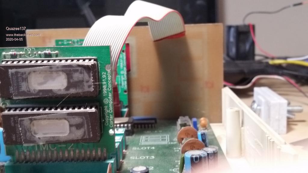

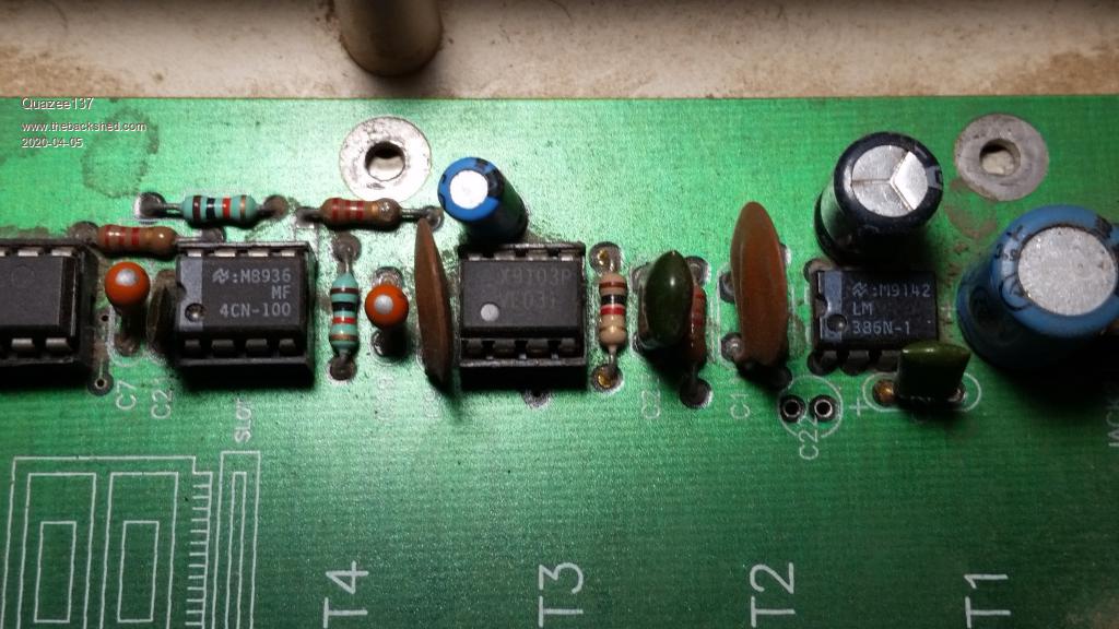

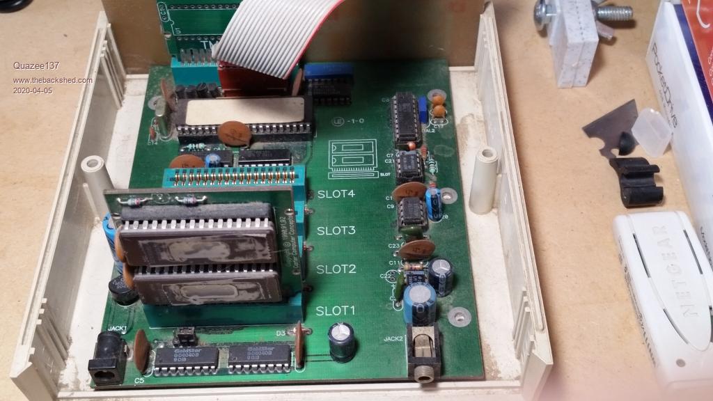

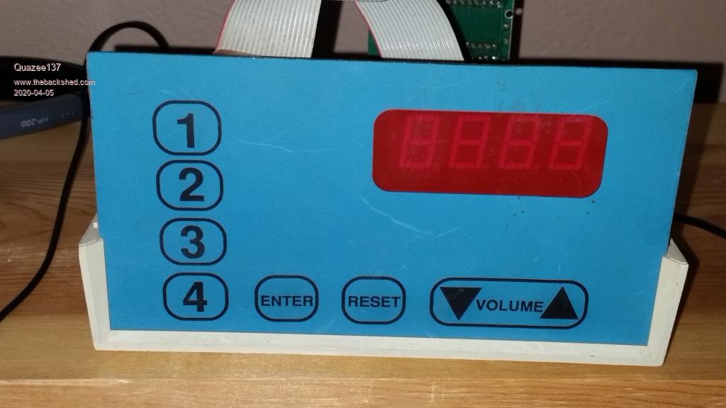

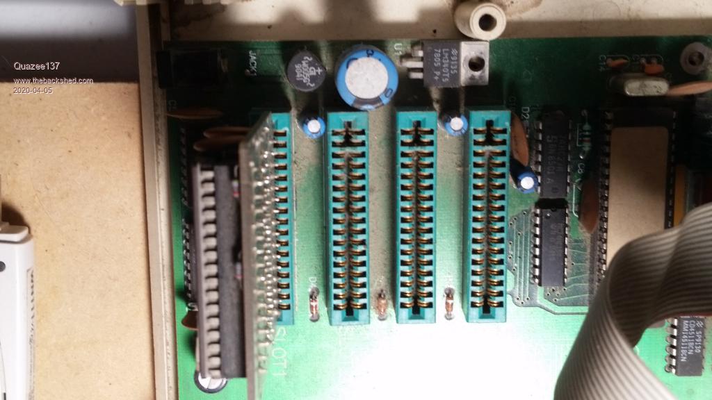

Quazee137
Joined: 07/08/2016
Posts: 603
Posted: 08:23pm 04 Apr 2020
There are a lot now days have a look at Analog Devices
Funny in unpacking I found the demo playback unit today. Studio boards and code
where abouts to be discovered.
Years ago I used Xcore X9103 with 8748 in a message playback unit.
It was sold for "message on hold telephone", in "store advertising shelf"
and a rental truck "vocal guide to shifting"
Had to make a studio board for a 286 motherboard with 2meg add on card as "ram Disk"
the HD's at the time wasn't fast enough. and the noise from the power supply was a
major problem to over come. Coding was Borland Pascal with a lot inline assembly.
Hope you don't mine going down memory lane with me.
The keypad was printed with my $240 radioshack printer "My mortgage was $105"
layout/etching in the kitchen. Very Fun days.
When I find the studio card I'll post few pic's. Hand wired.
The Xcore series was the only D-pot I could find at the time that used U/D count
pins it was easy to code for in 8748 asm.
Today with MMBasic and the mites this would be a maybe few nights of coding and
not the 18 months of programing/hardware trouble shooting on the 286 under MSDOS.
The 8748 was not bad to program for.
I'm Still having FUN doing this stuff. MMBasic has made it even more so !!!
Thanks Geoff, Peter Mather, Robert Rozee, Serge Vakulenko, Jim Tassy and
ALL the BACKSHEDERS that make this so ENJOYABLE and all the help given.
BE SAFE ALL
 Quazee137
Edited 2020-04-05 06:32 by Quazee137

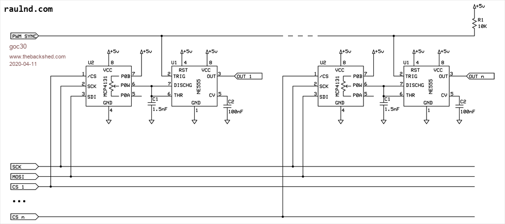

I found another application with the MCP4131, it is an assembly allowing to manage the pulse width of a PWM. It is based on a 555 chip drived by the MCP
http://tibuworks.blogspot.com/2013/05/pwm-sincrono-synchronous-pwm.html
for using mcp4131 with an mx170. you must avoid the 28pin version, because it does not work properly, however with the 44pin version it is correct. I put here the last version that I tested with explorer64 (and validated with an arduino)

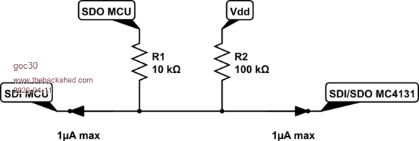

I do not know where the problem comes from, but I did not search in detail. I have a few tracks, either add a pullup on the SDI / SDO line (see picture), or there is a problem with pin3 (which is also used as vref-). I have a little time right now, since we're locked up, so I'm going to study the matter

I have used MCP4151 with 28 pinner with no issues. Only MCU SDO is connected to the SDI/SDO pin and MCU SDI is not connected. Seems to work OK.
