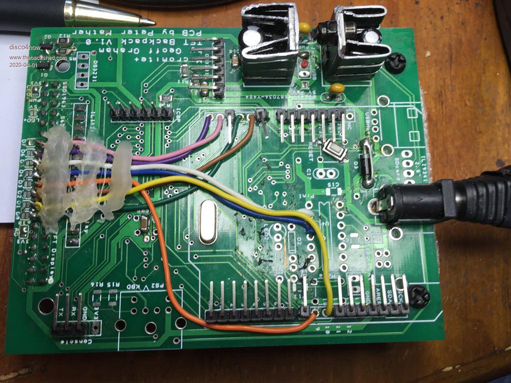

I have one I wrote some time ago. I ran extra wires on  peters M70 backpack as shown below.
This shows the pins I used for B8-B15

I will post it up if this is what you are doing. I have this board setup to get any P16 LCD working first before I try to configure as 8 bit.
Most can be converted to 8 bit with a bit of hacking. See this thread.
