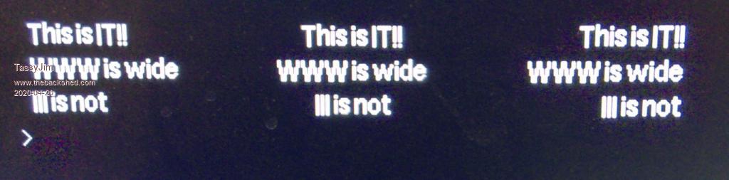

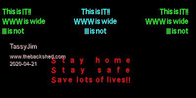

Posted: 07:55am 20 Apr 2020
I have updated 'fonttweak" so that you can shift a font to the left and save the width of each character as DATA statements.
Simply load you font and select "Save as BAS (Proportional)" and you will end up with something like the one in this program.
It is then easy enough to print each character in turn at the correct position.
The last character might overwrite anything immediately to the right of the text.
It should work on all platforms.
 ' proportional fonts demo
 ' fill the array with character widths
 DIM fontwidths(256)
 RESTORE FONT_WIDTH
 READ fontstart , fontcount
 FOR n = fontstart TO fontstart + fontcount-1
   READ fontwidths(n)
 NEXT n
 CLS
 pro_txt 10,100,"This is IT!!", "L"
 pro_txt 10,120,"WWW is wide", "L"
 pro_txt 10,140,"III is not", "L"
 pro_txt 200,100,"This is IT!!", "C"
 pro_txt 200,120,"WWW is wide", "C"
 pro_txt 200,140,"III is not", "C"
 pro_txt 390,100,"This is IT!!", "R"
 pro_txt 390,120,"WWW is wide", "R"
 pro_txt 390,140,"III is not", "R"
 PRINT
SUB pro_txt(x,y,txt$,just$)
 LOCAL AS INTEGER txtwidth, n, px
 FOR n = 1 TO LEN(txt$)
   txtwidth = txtwidth + fontwidths(ASC(MID$(txt$,n)))+1
 NEXT n
 SELECT CASE just$
   CASE "C","c"
     px = x - txtwidth/2
   CASE "R", "r"
     px = x - txtwidth
   CASE ELSE ' "L", "l"
     px = x
 END SELECT
   TEXT px,y,MID$(txt$,n,1), L,8,1
   px = px + fontwidths(ASC(MID$(txt$,n)))+1
 NEXT n
END SUB

 ' font widths
FONT_WIDTH:
 DATA  32, 95 ' fontstart, fontcount
 DATA  1,2,5
 DATA  10,8,15,10,2,4,4,12
 DATA  8,2,4,2,8,8,8,8
 DATA  8,9,8,8,8,8,8,2
 DATA  2,8,8,8,8,10,11,8
 DATA  9,9,7,7,9,8,2,4
 DATA  8,6,11,8,10,8,10,9
 DATA  9,8,7,7,13,9,8,8
 DATA  3,8,3,9,16,4,7,7
 DATA  7,7,7,5,9,7,2,4
 DATA  7,2,12,7,7,7,7,5
 DATA  6,5,7,7,12,7,7,5
 DATA  5,2,5,8
I haven't added any colour but that is easy enough to do.

Posted: 02:16am 21 Apr 2020
My next exercise will be 'justify'. That might be more useful.
Just have a few/lot domestic chores to see to first.
Posted: 06:59am 21 Apr 2020
Update. Now does full justify and colour.
 ' tassyjim April 2020
 OPTION EXPLICIT
 DIM INTEGER fontwidths(256) ' width of each character
 DIM INTEGER txtW(80) ' with of each char in the string to be printed
 DIM INTEGER fontstart, fontcount, n
 RESTORE FONT_WIDTH
   READ fontwidths(n)
 NEXT n
 CLS
 kern_txt 10,100,"This is IT!!", "L",,RGB(GREEN)
 kern_txt 10,120,"WWW is wide", "L",,RGB(GREEN)
 kern_txt 10,140,"III is not", "L",,RGB(GREEN)
 kern_txt 200,100,"This is IT!!", "C",,RGB(CYAN)
 kern_txt 200,120,"WWW is wide", "C",,RGB(CYAN)
 kern_txt 200,140,"III is not", "C",,RGB(CYAN)
 kern_txt 390,100,"This is IT!!", "R",,RGB(GREEN)
 kern_txt 390,120,"WWW is wide", "R",,RGB(GREEN)
 kern_txt 390,140,"III is not", "R",,RGB(GREEN)
 kern_txt 110,200,"Stay home", "j", 180,RGB(RED)
 kern_txt 110,220,"Stay safe", "j", 180,RGB(RED)
 kern_txt 110,240,"Save lots of lives!!", "j", 180,RGB(RED)
 PRINT
 PRINT
SUB kern_txt(x AS INTEGER,y AS INTEGER,txt$,just$,maxW AS INTEGER,c AS INTEGER,bc AS INTEGER)
 ' maxW = maximum width of text in pixels to justify to.
 ' just$: C = centre, L = left, R = right, J = justify to width maxW
 ' background colour may extend to the right of the last character.
 LOCAL AS INTEGER txtwidth, n, k, px
 FOR n = 1 TO LEN(txt$) ' fill char width array and find total width
   txtW(n) = fontwidths(ASC(MID$(txt$,n,1)))+1
   txtwidth = txtwidth + txtW(n)
 NEXT n
 SELECT CASE just$
   CASE "C","c"
     px = x - txtwidth/2
   CASE "R", "r"
     px = x - txtwidth
   CASE "J", "j" ' justify
     px = x
     IF txtwidth < maxW THEN ' if text width is less than maxW add extra pixel spaces
       k = 0
         IF MID$(txt$,n,1)=" " THEN txtW(n)= txtW(n) + 1 ' increase space characters first
         k = k + 1
         IF (k + txtwidth) >= maxW THEN EXIT FOR
       NEXT n
       DO
           txtW(n)= txtW(n) + 1 ' increase all characters
           k = k + 1
         NEXT n
       LOOP UNTIL (k + txtwidth) >= maxW
     ENDIF
     px = x
 END SELECT
   TEXT px,y,MID$(txt$,n,1), L,8,1,c,bc
   px = px + txtW(n)
 NEXT n
END SUB
