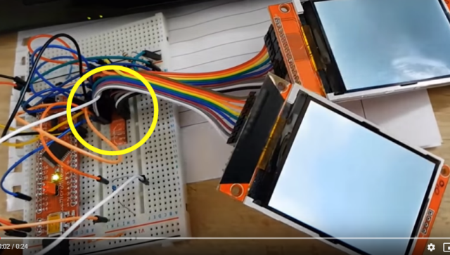

Posted: 04:26pm 11 Mar 2020
  PeterB said
I think you are using a micro on each display hence the problem with interrupts.
nope. Single '170 driving two displays. You can see both displays are connected in common (except CS, natch) in this still from the vid. Could drive many more (of the same type) - limited only by free pins. I programatically handle the CS pin just before I do any screen access.
I don't (never have yet) use the touch interrupt, I prefer to poll for changes but it could be handled on one screen OK, just have to activate the CS for the "touch display". Using something based on a priority encoder it should be possible to determine which of the screens you touched if you wanted it on all of them and switch the correct CS in... with caveats (and some extra circuitry)... with a bit more time it might be possible to come up with a total MM solution, but I just yanked this out of the air. It's not something I have ever needed so no proven method, just guessing.

Posted: 07:43am 12 Mar 2020
an as-yet un-diseased pom... mate they are dropping like flies in and around my town
... I try not to be smug - we all began as something else and I am only too aware of walking among masters here and of my Socratean status - "True wisdom comes to each of us when we realize how little we understand [...]"   Always happy to share what I learn/do.
So with the displays, all pins with the exception of CS are common and controlled by the MM. I lose one pin when configuring the display in MMBasic as it asks for a CS - it gets it but it isn't connected and I can't use it for anything else. Then with all other display access, I programatically take whichever CS pin I want, active right before. In the video, you can see two display resets - this happens by my program resetting the display, selecting the other CS and doing it again - this is how I figure (haven't tested) that you could do this on a dozen displays or more if you have the pins and can keep track of what's what in your code.
At first I was thinking about some multiplexer to control the CS but really, unless you are pushed for speed, it is easy enough to do it directly with code rather than components and sacrifice the one pin - you have to select the display you want anyway. I did a little write-up about it here and you can see in the code around line 7 where I select each CS in turn and initialise the panel, then inside the DO/LOOP, I use a FOR/NEXT loop to select each CS in turn and do some random scribbling... I think this is probably the code you see running (with tweaks) in the second vid where it demonstrate independent control/content.
You are probably thinking about inputs at this stage and you'd be right - I never played with that as the application was after display only (and it mean slightly cheaper LCD panels with no touch chip). I think it would be easy using a single display for touch because then when you get an interrupt, you know which display you need to service... if more, my idea around priority encoder would still give you the interrupt but then you'd have to read 3 bits from the '148 to determine which of the (8 in this case) displays generated the interrupt. Too busy to check atm but it would make for an interesting afternoon in the shed.

Posted: 08:03am 12 Mar 2020
  zeitfest said
Do the displays both show the same content ?  I had the impression, MM will not maintain two different concurrent display states for updates etc
Both displays can have independent content. I think with the cheaper little panels, MMBasic uses a "fire and forget" approach and the only "state" maintained is just concerned with the interface. Don't know if that is an accurate assessment but looking at how this does actually work I am drawn to think the internals are fairly simple.
The thought crossed my mind when I was playing with this first and was half expecting the
Gui Reset Lcdpanel
command to complain after the initial one, but it was fine - and it is key to the whole thing - you can't send stuff to a screen you haven't initialised so I was half expecting the second panel to not respond  or be filled with junk, but it is fine. It continually blows me away just what a tiddly MM can be pushed to accomplish.
The ILI9134 is not the fastest of panels but simple animations/screen gadgets and informational updates are fine. Never tried this on a different panel.
