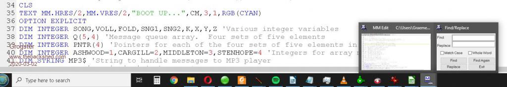

MMEdit works just fine for everything, but if I click the torch(flashlight for you American members ) the search window DOES pop up, but then it is instantly hidden and I can't get it back no matter what.  Resizing the main window does not reveal the search window.  Minimising the main windows does not reveal the search window.  I can see it there in the preview if I hover my mouse over the MMEdit icons in the task-bar, but if I click on that window(Find/Replace) to try to bring it up so I can enter search criteria, it just vanishes.
Anyone else seeing this?
Image of the problem:

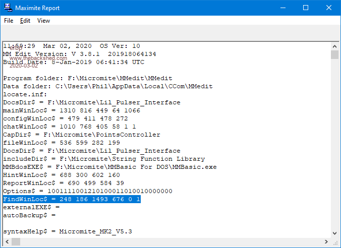

I had another thought about your missing Search window. MMEdit remembers the location of this window, so maybe it has got moved off the visible area of the screen (not sure how this would happen, but I have seen it with "missing" windows in other programs. To check, use the Help | Configuration Report menu option. It will display a window like the one below:
Check the values highlighted on the FindWinLoc$ line (as highlighted). If any of the first 4 values are negative, or greater than the size of the screen you are using, that will be the problem.
If so, check near the top of the report to find the Data Folder path, go there and find the locate.inf file and open it in Notepad (or equivalent text editor). Edit the line containing the FindWinLoc$ values (note: no headings at the start of the lines in the file, just the data, but it is the line below the OPTIONS, which is the line of mostly 1's and 0's as shown also in the Configuration Report). I'm not sure what values you should change them to but smaller than your screen res , or try copying the values in my example image. I **think** 3rd and 4th values are the Left and Top coordinates.

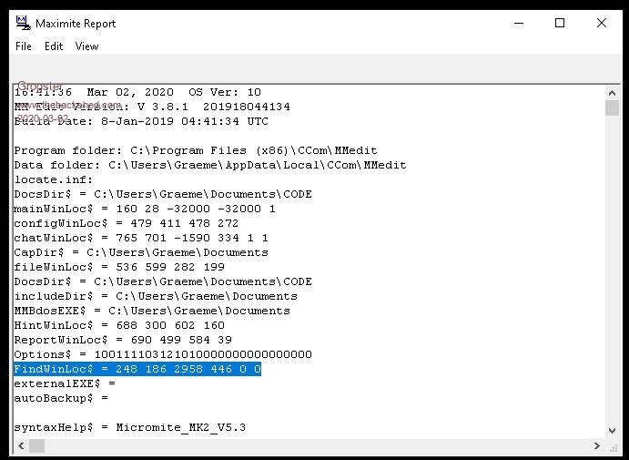

Here is my report:
I do have two LCD's on my machine, and so I tried to drag the search window to the other monitor, but it would not let me.  So I dragged the main window to the 2nd monitor(that worked), but still can't see the search window.
Always had the same resolution on both monitors - 1920 x 1080
I will edit the INF file and see if that helps at all.

SUCCESS!!!!
I edited locate.inf to change the 2958 to 1400, and now the search window opens on top of the main window and I can now use the search.  Thanks very much, erbp!!!!
