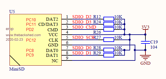

I have an Armmite F4 and would like to fit an external SD Card socket in parallel with the Micro SD socket on the module. This is due to the fact that for my project the F4 module will be mounted in a position such that the on-board socket will difficult to access, so I would like to mount the external SD Card socket in a position where it can be accessed easily to change SD Card.
I have a Grogster "E100 SD Holder 1A" module that would be ideal for my requirements, but am unsure about which signals connect where.
Below is a section from the STM32F407VET6 circuit diagram showing the connections to the SD Card socket. With reference to the main part of the circuit diagram I have annotated this diagram to also show the "pin numbers" on the module that the various signals appear on.

Ignoring 3v3, Gnd and WP, can you please advise which pins the remaining signals on the external card holder should be connected to on the F4 module?

Can't be used as it doesn't have enough signals broken out.The ArmmiteF4 uses a 4-bit parallel I/F. See this for the pin mapping
