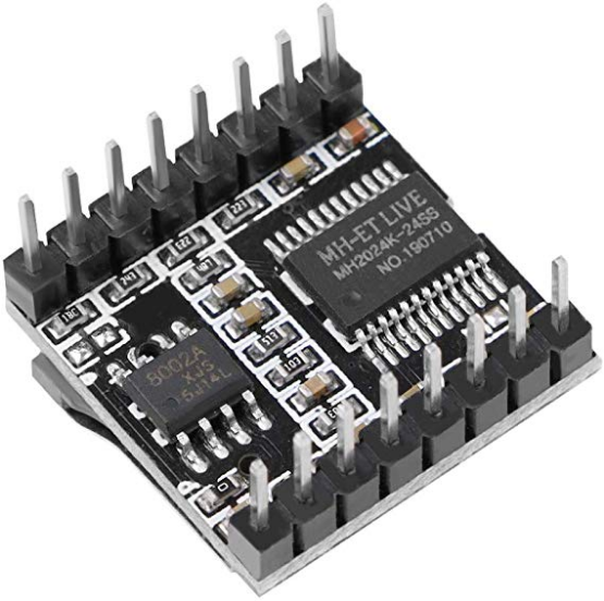

Some of these modules marked as MP3-TF-16P have the YX5200 chip and work ok. It's the ones that have the MH2024K chip that seems to have the problem working with the serial port.
Thanks. Dave.
Posted: 08:30am 23 Feb 2020
Buy only DFplayer modules with the YX5200 or YX5300 IC.
These ones seem to work just fine with the standard commands.
The MH2024K chip seems to use a different serial protocol, and details are very hard to find.

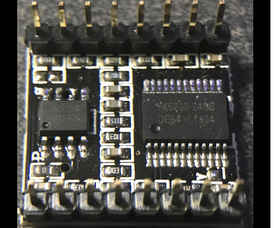

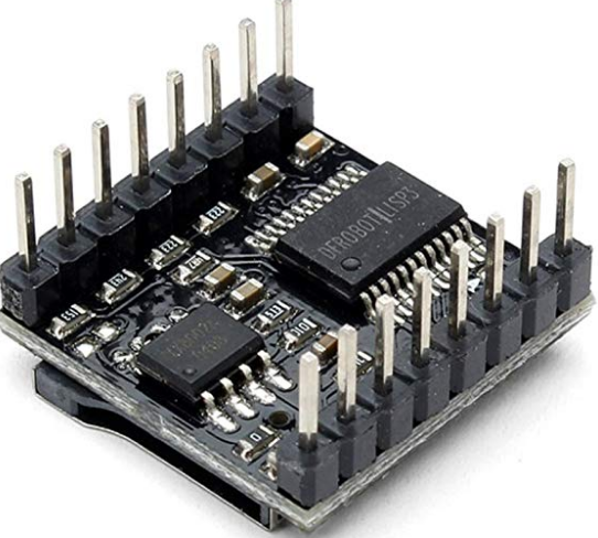

Some pic's of the boards reviewed.
From sellers images so who knows good/bad/other wise

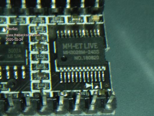

After reading this and the info about the fakes, thought I would check the ones I bought and saw this in the chip MH-ET LIVE MH3028M-24SS.
So now I'm confused.
Bought these for a model railway project to add sound to some parts of the layout, was thinking about using it for loco sound loops but that would be too limited, so on to the next idea for that.
Have not seen another of these DFPlayers with this MH3028M-24SS chip.
Cheers Aaron

I can confirm the module labelled MP3-TF-18P with a MH3028M-24SS chip does work with the serial interface.  I have another module labelled DFPlayer-Mini with a chip marked as AA1752CJ3J13.1-94 and that also works with a serial interface (both 9600, 8n1).
Gerry

Tested using a nano and DFPlayerMini_Fast-master, the DFPlayer with this MH3028M-24SS chip works nicely with serial, the wav or mp3 files, last one saved to the micro SD was the first one to play.
Also it was a bit fussy about the file names, it refused to play 01 (ended up corrupting the file) but 001 or was it 0001 works fine.
There was some explanation about this in the DFPlayerMini_Fast file.
Obviously I'm new to this, but I have it the player doing what I want it to. eg. play first track then loop second track.
perhaps the 2028 chip wants the correct file names.
Cheers Aaron

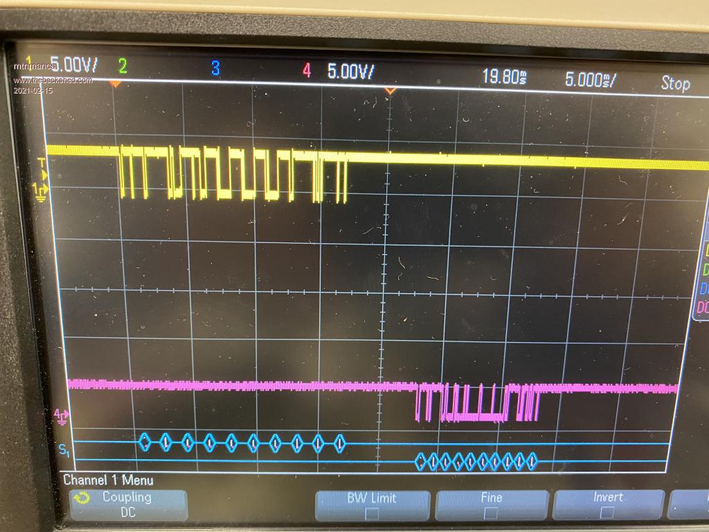

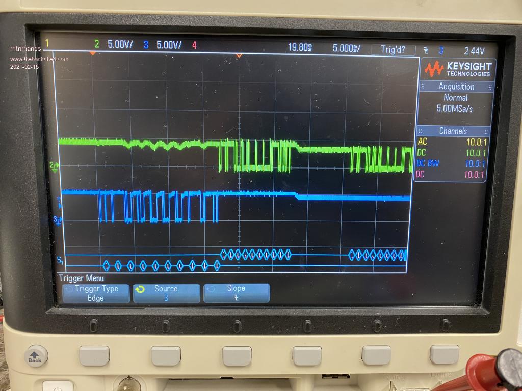

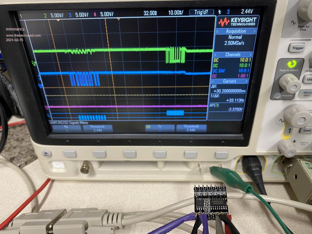

1) I use a 5V supply
2) I use a PIC to communicate via serial with the modules (at 9600 baud, idle high, 8 bits without a parity bit)
3) I place a series resistor (about 1k) between the TX pin on the PIC and the RX pin on the module
4) I monitor serial traffic (TX and RX) with a scope
5) I place generous bypass across the supplies at the module (100uF). I have scoped my supply and it looks clean
6) I have had great success with the YX5200 modules. The audio noise is acceptably low, the volume is good, and the modules drive 8 ohms speakers well.
7) I name all of my tracks ###.mp3, where ### is 001, 002, etc. unless otherwise noted.
8) I name all of my folders ##, where ## is 01, 02, 03, etc.
9) I only test serial comms (I don't test a module's ability to respond to button presses because I'm not interested in using them with buttons)

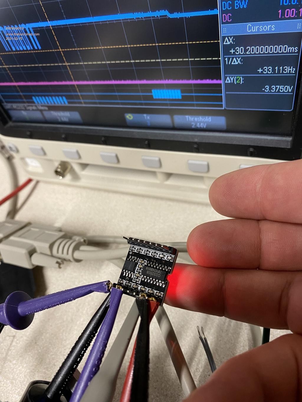

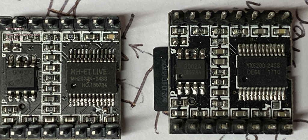

Some observations about the MH2024K-24SS modules that I received:
1) The modules look very similar to the YX5200 module that I have (the component values and placement seem similar).
2) The indicator LED on these modules behaves differently.
      a) on the MH2024K modules, the LED is always off unless the module is playing, in which case the LED turns on brightly
      b) on the YX5200 modules, the LED is always dim unless the module is playing, in which case the LED turns on brightly.
3) The series resistor between PIC TX and module RX prevents successful serial communication.  The MH2024K module serial communication does work successfully if I short out that series resistor, and I can get the module to play my tracks.

1) The modules look very similar to the YX5200 module. However, unlike other modules that I've seen, the audio amplifier (8-pin SOIC) does not have any readable markings on the package.
2) The indicator LED on these modules works as follows:
      a) if there is no SD card, a brief flash when power is applied (sometimes)
      b) if the SD card is inserted, dim illumination for a few seconds at power-up
      c) dim illumination when micro SD card is inserted, then the LED turns off after a few seconds.
      d) bright illumination when a recording is playing, followed by dim illumination for a few seconds after the recording stops, followed by the LED turning off. This does make me wonder whether there might be a way to reduce the noise by preventing the module from going into the state where the LED is completely off (the LED on my YX5200 modules never turns off, and I don't have noise problems -- is there any correlation there?)
3) Same comment about the series resistor as with the previous module.
4) Same comments about noise as mentioned in the previous module.
Some observations about a module with a chip labeled GD3200B:
1) The module looks different on the back side of the PCB. Between the main IC and the audio amp IC, there are 5 components (Rs and Cs) instead of 7. The GD3200B has 16 pins instead of the 24 pins on the YX5200 IC.
2) The indicator LED on this module does turn on briefly and then go out when powered up.
3) The module does not respond at all to serial communications.
4) The module produces a constant hum in the attached speaker. I didn't run an FFT on the hum, but it sounded about like 60-100Hz. I tested this module in the exact same circuit as the other modules, so I doubt that it's a setup issue.
