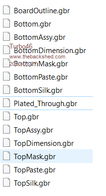

In the CN column of the January issue of Silicon Chip in there was a description of a ‘Micromite Mk2 dev board with Microbridge’. I wanted to get a couple of boards so I downloaded the ZIP file which contains the Eagle ECAD files and Gerber files among other things with a view to ordering 5 boards from a Chinese manufacturer like: JLCPCB, PCBGOGO, PCBWay or similar.
From what I understand a drill file is needed to specify the drilling sizes. But there is not one included. The Gerber files included are:
I had a look at some of the Gerber files and the first line says:
G04 DipTrace 3.3.1.3*
Which leads me to believe that they were created using Diptrace NOT Eagle. I use Diptrace 3.3.1.3 for schematics myself so I imported the .brd and .sch files into Diptrace and produced a new set of Gerber files as above and a ‘Through.drl’ file. It’s a bit of a worry because the new set of Gerber files are different to the originals.
My problem is: are the original set of Gerber files enough for ordering PCBs? Or should I use the second set even though they are different along with the .drl file. How do I supply them to the manufacturer?

Here is what I use with JLCPCB
NC Drill     TXT
Milling      GML
Dril legend  do
Cream top    GTP  I think this is used for the stencil
Sldr Msk bot GBS
Sldr Msk top GTS
Silk top     GTO  I only silk screen the top
Bottom layer GBL
Top Layer    GTL
I zip them and upload to JLCPCB and use their gerber viewer
linux I use the Gerbv Gerber File Viewer

Posted: 04:27pm 27 Jan 2020
If the drill file is not included, you should be able to produce a proper zip file from the Eaglecad sch and brd files. Using version 9.3.0 (free), from the brd file I click the CAM processor icon (to the right of SCH/BRD), click Export as Zip, and click Process Job.
This produces a zip file which contains everything, though the drill file is in a separate directory within the zip file from the other gerber files. JLCPCB will accept this file directly.

The PCB Fab house will definitely want a drill file for production of the board.
You generally need
Top Copper
Bottom Copper
Top Silk Screen
Bottom Silk Screen
Top Solder Mask
Bottom Solder Mask
Board outline (or profile)
Drill.txt
And if Using SMD devices
Top Solder Paste
Bottom Solder Paste
