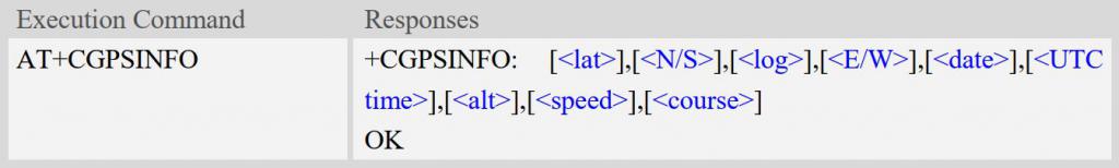

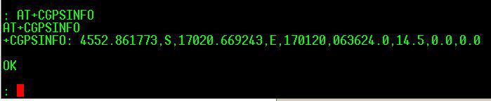

I am having a horrible time, trying to decipher the data received from a GPS module, to actual USEFUL information.  The data supplied by the module is in an odd(to me) format.
It is not just in degrees, minutes and seconds, but several digits then a decimal point, then several more digits.
An example string I get back from the module is:
The manual says that: "Output format is ddmm.mmmmmm" for Latitude, and "dddmm.mmmmmm for Longitude".
dd is obviously degrees, mm is obviously minutes, but where are the seconds?
Manual says that the string returned is:
Can someone help me see the light with how to convert the data returned, into some kind of useful co-ordinates?

Do you know what the lat/long is at the point you have that setup, even approximately from Google maps?
Is it possible to get another location (again with co-ords from GMaps)?

Find the decimal place using INSTR. Then subtract 2 then VAL the string. This gives the minutes component.
minutes - INT(minutes) gives you the fractions of minutes,
multiply by 60 to give seconds

I would have thought it was 45 deg 52.861773 min so the seconds would be 60*.861773
In Google Earth you can get the position in this format. Go to tools/options.

I have been using GPS receivers for some time and I am surprised that your speed is zero. Is that a fluke?
I find the speed is all over the place when stationary but the accuracy improves when moving. It's another thing I don't understand but I accept it.
Our house has been clocked at 2 km/hr.
