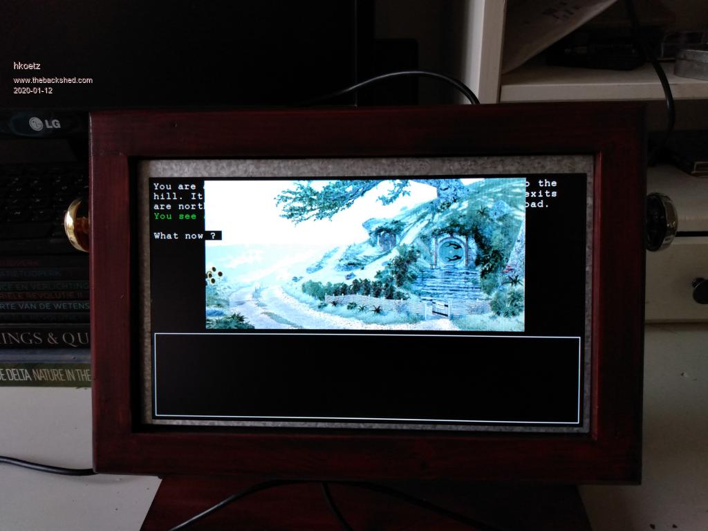

There is a picture on the top half of the screen (LOAD IMAGE). On the lower half is varying text (generated wint PRINT). Is there a way to clear the lower half of the screen only, keeping the picture on the top half in place. I have OPTION LCDPANEL CONSOLE active.

BOX 0,MM.VRES\2,MM.HRES,MM.VRES,,0,0

The attached photo shows what happens. How do I print and clear inside the box?

I get it. You paste a box filled with background colour over the text.

Not sure what you are trying to do. If you want to constrain the console to work inside the box it can't be done. In a program you just use normal drawing commands as per the MM2/MM+/MMX manuals
