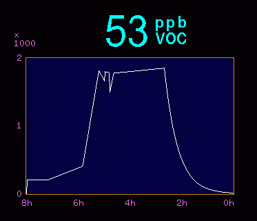

Yes, it is based on the LCD Backpack (any version) and all the code is in BASIC.  The sensor turned out to be tricky to use but the result is quite good.  It is very sensitive to things like unventilated rooms and chemicals used in furnishings (ie, sick building syndrome).
This is a screenshot showing the main screen which includes a graph over time (reached a max of near 2000ppb) and the current reading:
