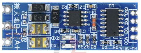

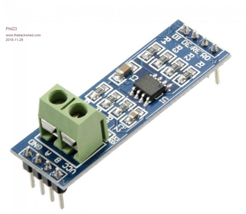

Also got a few of these at the time,
https://core-electronics.com.au/ttl-uart-to-rs485-converter-module.html
Think I used the others for some reason relating to the Auto transmit/Receive function of the HW-0519.
https://www.sunrom.com/p/rs485-ttl-module-with-protection-auto-transmit/receive switching
Don't think I ever got my head around head the use the others with Modbus slaves.
Or the pinout requirements.
DI, DE, RE, RO.
Phil.

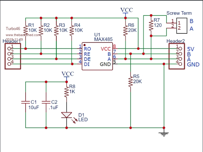

Turbo46
Joined: 24/12/2017
Posts: 1694
Posted: 01:15am 29 Nov 2019
Phil
This may help
RO (Receiver Output)  Connects to a serial RX pin.
RE (Receiver Enable)  Active LOW.  Drive LOW to enable the receiver.
DE (Driver Enable)  Active  HIGH.  Typically jumpered to RE Pin.
DI (Driver Input)  Connects to serial TX pin.
The 120 ohm resistor R7: If using in a multi-drop configuration, the modules on the two ends of the line should keep these resistors.  Modules in the middle of the line should have these resistors removed to prevent loading the lines too heavily. The signal wires should be a twisted pair, shielded for long runs and there should be a common ground.
Vcc is 5v but mine run quite happily at 3.3v
The Micromite can supply a DE signal (connect DE to RE) but it is the wrong sense (see the manual). Rather than use that pin and an inverter I use an output pin to supply the DE signal, set it high to transmit the message, then, after the message has been sent, set it low to enable reception. Apart from that it is treated as though it is a normal RS232 device.

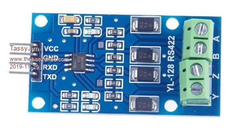

I actually use these RS422 modules so that they are plug and play and handle full duplex so I can load programs easily.

Turbo46
Joined: 24/12/2017
Posts: 1694
Posted: 06:18am 29 Nov 2019
The one in Phil's second photo uses the MAX485. This is the one to which I was referring. Here is the circuit.
There are no smarts. you need to control the transmit/receive switching.
I believe the one in the first photo does do it automatically.

Ah, maybe it's because TassyJim's appear to be using the MAX490 which don't have enables.
From what I can make out, this means that the devices can never go into low power mode(?).
Probably more of an issue with battery powered devices. Not an issue in my case so I might try some MAX490s, next time around.
Craig
Posted: 08:12pm 29 Nov 2019
  Tinine said  Ah, maybe it's because TassyJim's appear to be using the MAX490 which don't have enables.
Craig
The ones I am using are very good for one to one but not much use for multidrop where you need to put the transmitters into high Z.

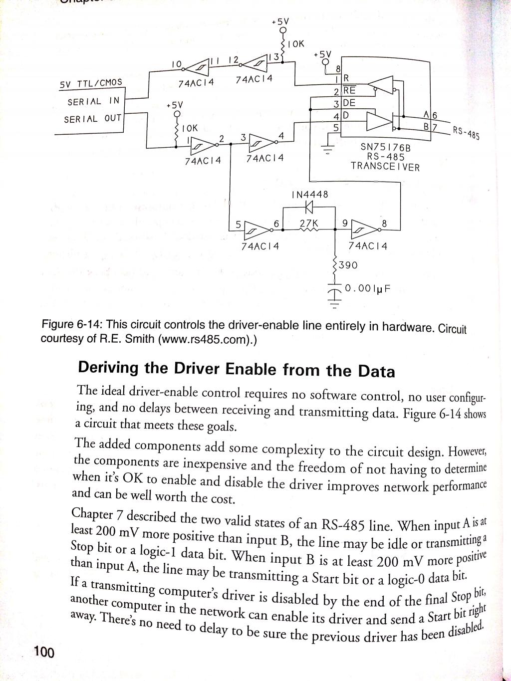

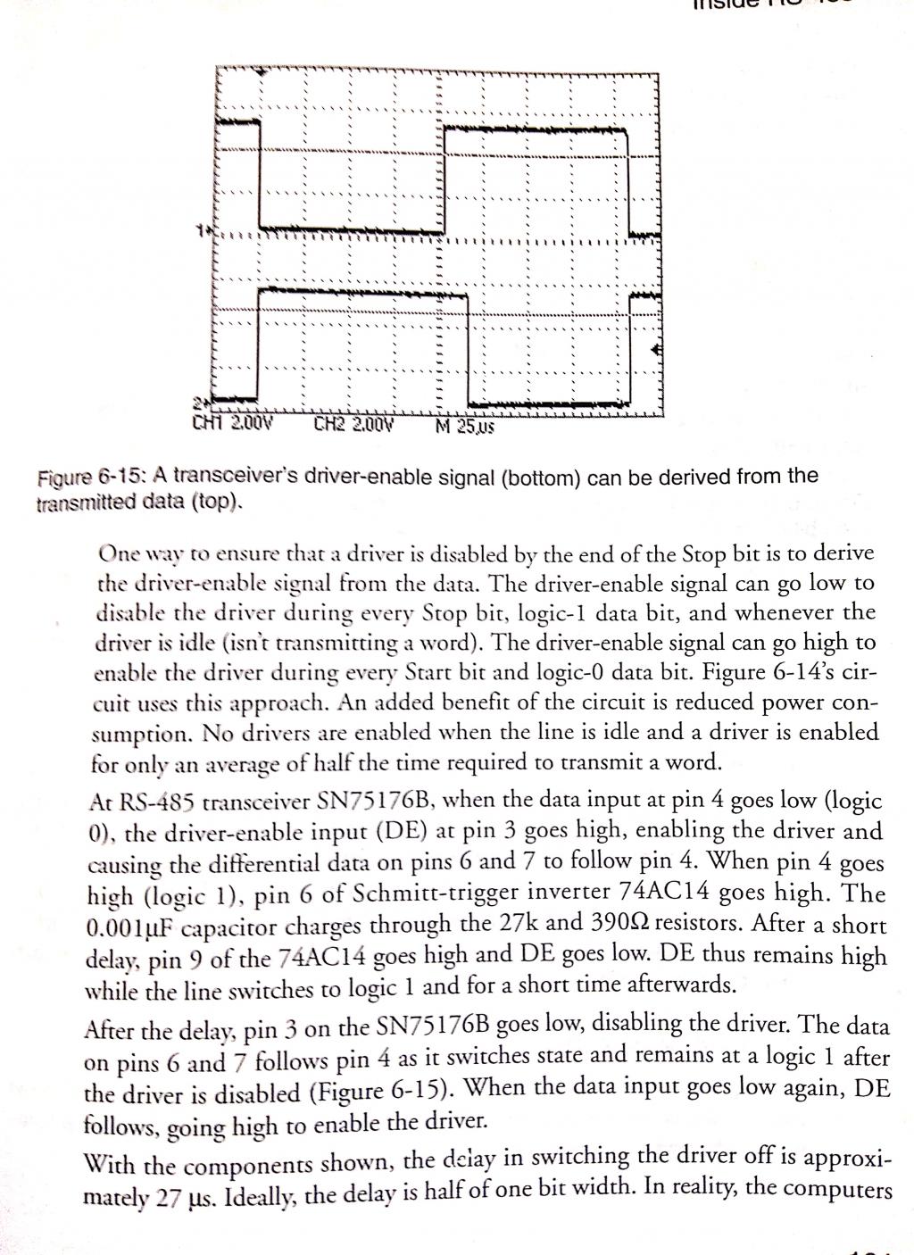

Auto Enable
Cheers,
Craig
Tinine
Joined: 30/03/2016
Posts: 1646
Posted: 12:59pm 30 Nov 2019
Turbo46
Joined: 24/12/2017
Posts: 1694
Posted: 09:25pm 30 Nov 2019
If I am understanding the above circuit correctly, the driver IC is only enabled when the Serial Out (Tx) pin is low and disabled when it is high (plus a short delay caused by the R/C circuit). As it says "a driver is enabled for only an average of half the time required to transmit a word".
If the data was 'FF' Hex, the driver would be only enabled for the START bit and disabled for the rest of the word except for a short pulse at the beginning or the first '1' bit. The RS485 A/B signal lines would be tri-state for every '1' bit transmitted.
Surely this arrangement would be highly susceptible to noise? If it works at all I can't see how it would work reliably - especially over long distances. The board shown in Phil23's first photo is a little more complex.
Not explained above is that the two Schmidt trigger gates in series with the Tx and Rx lines will add a little propagation delay to the signals so that little (if any) of the START and other '0' bits are lost.
Please correct me if I am wrong.
Phil23
Joined: 27/03/2016
Posts: 1667
Posted: 12:40am 01 Dec 2019
  Tinine said  I don't believe that those modules require the DE signal, do they?
I believe that they do it automatically when sensing a TX.
The ones in the first Pic I posted have Auto TX sensing.
Have found one in the box of stuff up the front; chances are there's another somewhere.
Have a habit of buying stuff in multiples.
Already using one of them to read my Modbus meters.
Phil.
