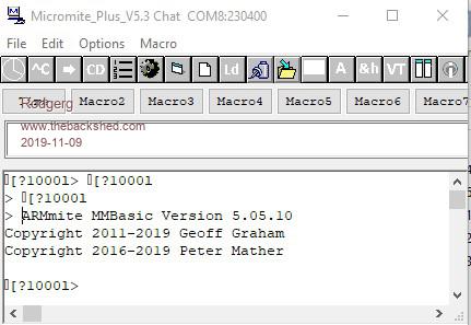

I am using a ZI2 Board, but I still see the escape characters on the console, even  when using the most recent firmware
> [?1000l
> [?1000l
> ARMmite MMBasic Version 5.05.10
Copyright 2011-2019 Geoff Graham
Copyright 2016-2019 Peter Mather
[?1000l>

Peters change was to remove the escape codes from the inbuilt MMbasic console, shown on the LCD.
I now have no codes on the LCD console, however depending on the external terminal program you are using, they may well be visible on that.

@KeepIs  Thanks for clarification Mike.
  Quote  depending on the external terminal program you are using, they may well be visible on that.
Your are absolutely correct.
I have been using MMEdit Chat as my terminal program until now as everything is nicely integrated in MMEDit for editing, uploading and controlling the Micromite.
Full screenshot below

I may still use MMEdit Chat for small tests, but the control codes appearing on the screen are a little annoying.

MMEdit hasn't kept up with recent changes to some of the MMBasic variants.
I will update it eventually but TeraTerm will always be a much better terminal program.
