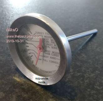

Here's mine,
Codenquilts

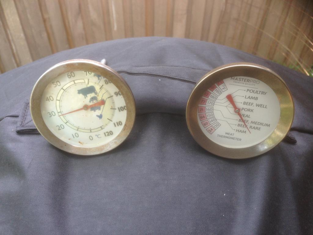

Here are two of mine (Oven & BBQ).
Cheers,
Andrew

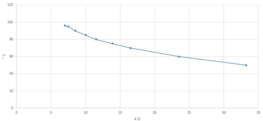

Here is a plot of the Temperature vs Resistance readings from 50 to 96 deg.
Edited 2019-11-07 19:42 by Andrew_G
