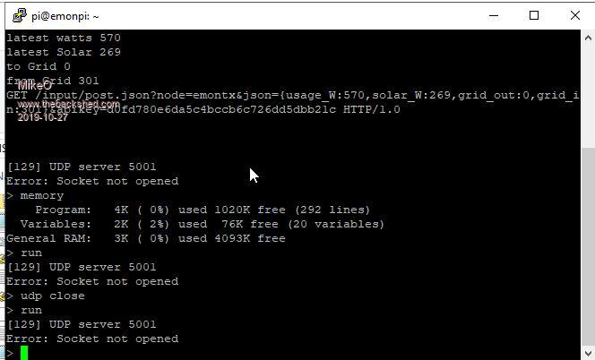

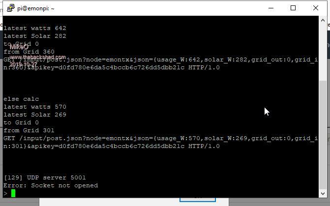

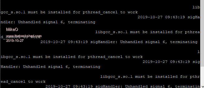

Peter, I just had another failure, I then clicked New instead of my usual ctrl/Z and I got this error in the session window, sorry its not in line but if I had altered the window I think I would have lost the message.
I have a problem in a routine running in Picromite ver 5.0504, Raspian Buster Minimal.
The routine receives a UDP datagram from two sources (My Fronius PV and photo sensor on my electric meter). The program processes the data and then outputs 4 data fields via a HTTP Get message to the logger API. The program is running in a screen session.
The problem is that all runs ok processing the data every 10 secs until 3 hours later where it fails with a UDP socket error message. I have ensured that only one socket is running at one time and also protected the UDP/TCP commands with error traps but its still fails in the same time frame. The memory stats seems to be similar/not unusual to startup when it fails. The program will not run again after failure without exiting (ctrl/Z) and restarting mmbasic. The RPI does NOT require a reboot.

It may well not be a Linux problem.  It sounds more like there is a library (Windows DLLs are the same and borrow the same ideas) missing.  It is either wanted by pigpio or mmbasic or some other thing you're using.
It doesn't sound so far to be a memory leak.
The library (shared object) libgcc_s.so.1 is at least missing or not in the path being searched.  You may be able to create a link to a similarly named one or, better, find out which thing you use is wanting it.

John, the  libgcc_s.so.1 does exist on the system, there does seem to be some chatter out on the web about some incompatibilities with this library but I am not sure it is a problem in this case?
I can report a few things;
I had another failure at 3 hours memory on the system at the failure are not really any different than during normal running.
I made some changes to the code so UDP socket is permanently open, TCP being used as required. I had some confusion on this subject , I thought I remembered from early posts that only a single socket was allowed to be open (Peter?) hence, why I was switching them however to try and advance this I set UDP permanent and TCP on / off. OK 3 hrs later, it failed, however UDP was still receiving it was TCP that was not and would not restart without a ctrl-z and restart (of mmbasic)

It's either not found (wrong path etc) or I suppose could be looking for 64-bit and can't find it / looking for 32-bit and can't find it (where presumably the existing one would be the other size i.e. 32-bit/64-bit respectively).
There are probably other reasons the message could occur (er, old version of lib, corrupted file, ...).
I can see reports about it but due to tools you probably are not using, so next it would be rather helpful to figure _which_ thing you're using triggers the message so we can find out if it wants a different size or just doesn't have it in its (library) path.
BTW if you find it's the latter you can potentially use ldd or as a short term thing such as:
LD_LIBRARY_PATH=/some/path program args
(which can be handy if you have several versions of a library)
Edited 2019-10-28 20:44 by JohnS

I am not a Linux person, just learning to make my way aground and I although I would like to solve the problem and use the program the way I had originally intended I know how long these things can take and sometimes "programming around it" is an option if not the best one. Also the error message I showed actually only appeared when i did a NEW command from the mmbasic command line, not when the failure occurred, so whilst no doubt a result of the fail may not actually be the cause.
