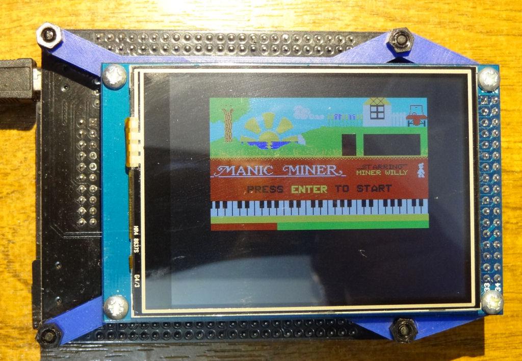

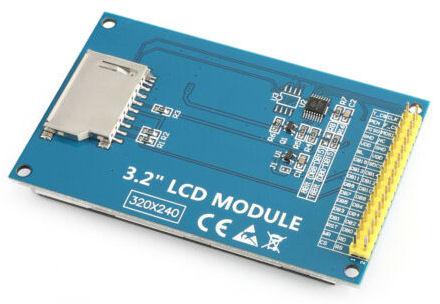

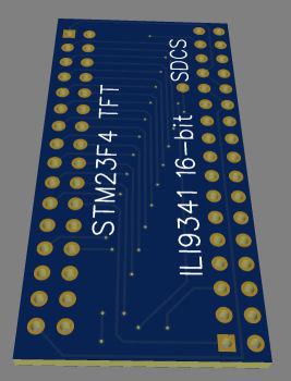

It defaults to using the ILI9341 16-bit touch display.  You can get them in various sizes up to 3.2-inch.  You can get one on AliExpress that fits direct to the TFT connector on the board, but it's awkward to support it properly.  I wanted more of a 'backpack' design for mine so I chose to use the cheaper display from Ebay - the 34-pin one - it has a different pin-out but I designed a 'shim' PCB to make the connections and also designed and 3D-printed a mount that fastens the display to the back of the board and allows it to be panel mounted or free standing on a desk.
I solder the shim PCB direct to the STM32F4VE 'TFT' pins, and then have a socket (double row of female headers) soldered to the other side for the display module to plug into.  This spaces the display far enough away from the back of the STM board so that the mount is thick enough to allow self-tapping screws to fasten down the display module.
The display has a full-size SD card holder on the back, which you can connect up if you want to - but I don't bother, I use the STM32F4's on-board micro SD.
