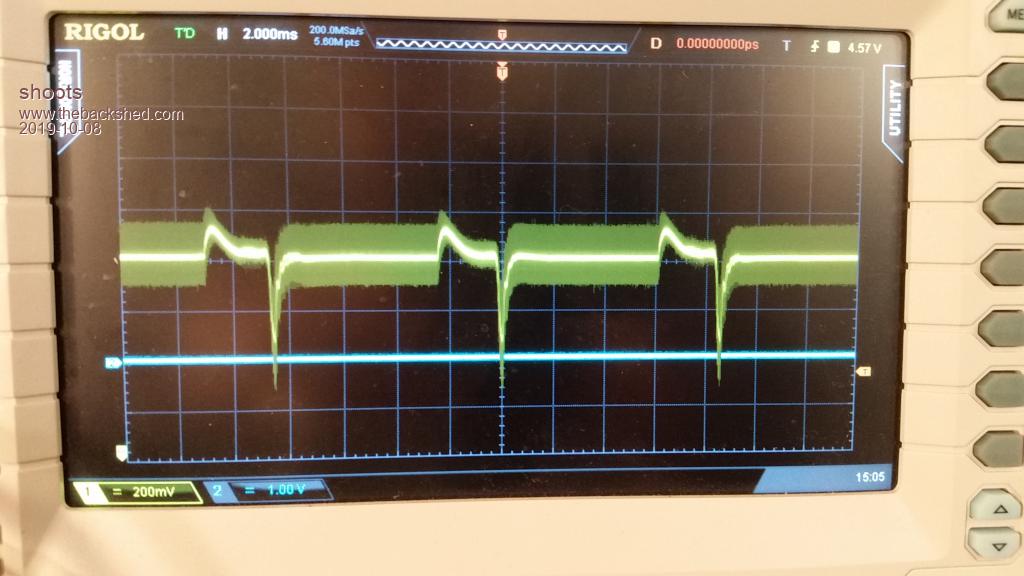

I am running an Explore 100 with a 5" touchscreen piggybacked onto it. I have a pressure transducer sending an analogue input to the Explore. No matter what I try I cannot eliminate the noise on the analogue signal. The noise is present on the supply rail and is then coming through the output of the transducer.
It is not present when I unplug the touchscreen. It is still there if I use a battery to supply the system so I am confident it is not coming through the power supply. Monitored at the supply rail the noise spikes down 0.5v. I have tried loading an image of it. It has a main period of approx. 8.5mS and the shallower ripple in the noise has a spike every 10uS.

Here is an image of the noise on the supply

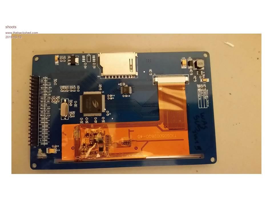

This is a pic of the rear of the screen. Has anyone had success with an alternate brand to this one? I would be wise to consider an alternate.

I will try both your suggestions. I did try a series of caps on the screen near the power input without joy (bottom LHS in the photo-since removed). I will try that as well as on the input to the MM. I will also have a look at applying bypass caps near the backlight boost circuitry.
Any ideas what the backlight voltage is boosted to on these screens? I suspect the boost cct may be at the top right. Will try and get to it tonight.
