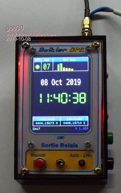

I use your function on my H7, and it work correctly (very good job thank). My only problem is your "valid" function who work only in binary state (yes or no), but some times I need to know if I receive internal time or gps real time, but it is no important.

goc30
Joined: 12/04/2017
Location: France
Posts: 435
Posted: 09:50am 08 Oct 2019
my proto box
panky

goc30
Joined: 12/04/2017
Location: France
Posts: 435
Posted: 10:09am 08 Oct 2019
  panky said  @goc30,
You're absolutely correct - it is a complex issue to fully analyse and interract with a GPS stream - even more so given that the internals of the PIC chip itself are somewhat obscured by MMBasic (a good thing for most of us, particularly with less time critical applications).
Would a precision oscillator with hardware division to precisely generate a 1 second control signal be an option. A periodic GPS check could apply an analogue correction to the oscillator via the Micromite perhaps?
panky
in my case, precision of 1 millisecond is good, no need more. And gps module give a "PPS" signal who come exactly at "000" millisec. I use this data to close my relay. For open relay, I use an other interrupt task (settick 10ms). and in this case problem begin to be strong, because relay close at "0", but re-open at a random time (normaly after 20ms) between 25ms and ... 800ms. to finish, I have an other interrupt task who print time on screen each seconde. When you look at screen, some time it lost seconds or pass immediatly for exemple from second "23" to second"24".
for info, on h7 with peter's GSP function, I have no pb. That say that it is an MMbasic timing problem on mx170/470.
