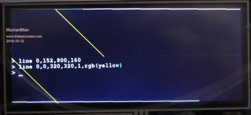

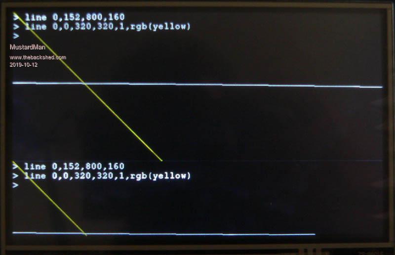

Frustrating... I've made tweaks to the MMbasic firmware (SSD1963.c and associated), but no matter what I do, the display does not operate correctly.
First test was to see if changing the firmware would work, and it appeared promising. When setting the Vertical size to 320 (my panel size), it displayed as expected on a 800x480 panel.
160 lines of the top section (800x320) are repeated from 320 to 480.
However, when I attach the genuine article, the 800x320 display, it displays the bottom section of what would notionally be a 800x480 screen, but all the rendering for a 320 height screen is performed correctly!
I've tweaked the pixel clock, the horizontal (and vertical of course) sync, the sync polarity, front & back porches (with absolutely no change to the display), and in desperation have started looking at other 1934 commands to tweak.

Well, I've decided to go the 'dirty hack' way and simply plug the 800x320 'wide screen' display in in place of the 800x480 standard display and perform all my display operations (graphical only, no text) using the bottom "half" of the screen. ie: add 160 to all "y" co-ordinates (160 = 480 - 320).
I've already spent two full days trying to find the cause of the problem, and I am not willing to spend any more.
I've written to "buydisplay.com", but despite their website promise ... Of course, we wouldn't just leave you with a datasheet and a "good luck!" ... I don't hold much hope in getting a useful response. I might look further in my spare time (because I don't like to be beaten by "the tech"), but apart from that, I think a 'dirty hack' is gonna have to do.
I suspect the SSD1963 is not reconfiguring the H & V timers as I am asking it to, because even drastic changes to the parameters make no visible changes to the display. I will have to break out some thin wires to a cro to find out.
I also think the SSD1963 might be refreshing the display from the bottom up, which would explain why it shows the bottom part of a 800x480 image rather than the top. The cro will verify that too.
