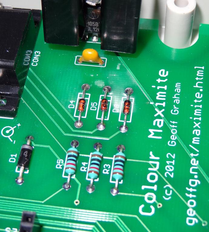

Posted: 04:45pm 16 Sep 2019
Are you sure you assembled the Maximite with the correct resistors and the diodes the right way round on the VGA output part?
The idea is that the red, green, and blue pins for VGA vary between 0V and 0.7V.  Because the CMM is only eight-colour, it wants those pins to be either high or low, and it does this by using relatively low value resistors (120-Ohm) with 1N4148 diodes that clip the maximum voltage at or below 0.7V.
If you use slower diodes then they don't switch fast enough and that results in a fuzzy picture.  If you've fitted one or more of the diodes backwards, then the voltage will be driven above 0.7V which is outside the VGA spec and also results in a poor picture.  The black bands on the 1N4148 diodes should be on the side nearest to the voltage regulator.
Also, it's easy to fit resistors with too high a resistance that will produce a feeble, dimly-coloured picture.
Those four-band resistors are a nightmare.  Depending on which end you read them from, Brown, Black, Black, Red, (Brown) is 10K with the last Brown meaning 1% tolerance, but from the other (correct) end, Brown, Red, Black, Black (Brown) is 120 ohms, also 1% tolerance.
I almost always check the resistance of resistors using a trusted multimeter - apart from the stupid ambiguous colouring scheme, I've seen resistors that were just totally wrongly coloured: I've kept one somewhere that is almost exactly 220 ohms (should be red, red, black, black, brown) but is actually painted yellow, violet, black, red, brown - 47K!
Make sure you have the correct 120 ohm ones fitted (150 ohm would also be okay).
Edited 2019-09-17 03:06 by ceptimus

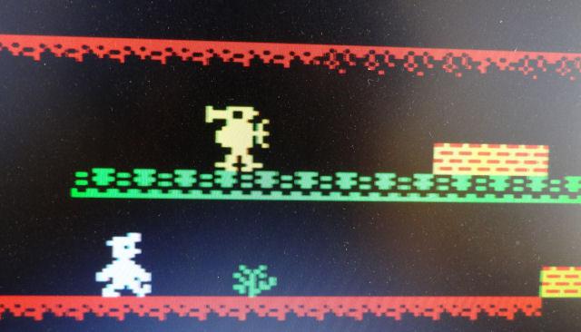

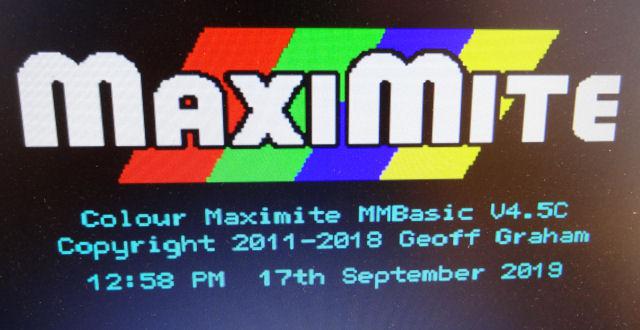

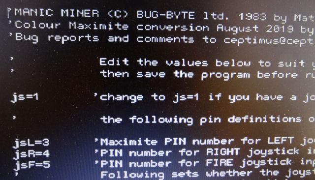

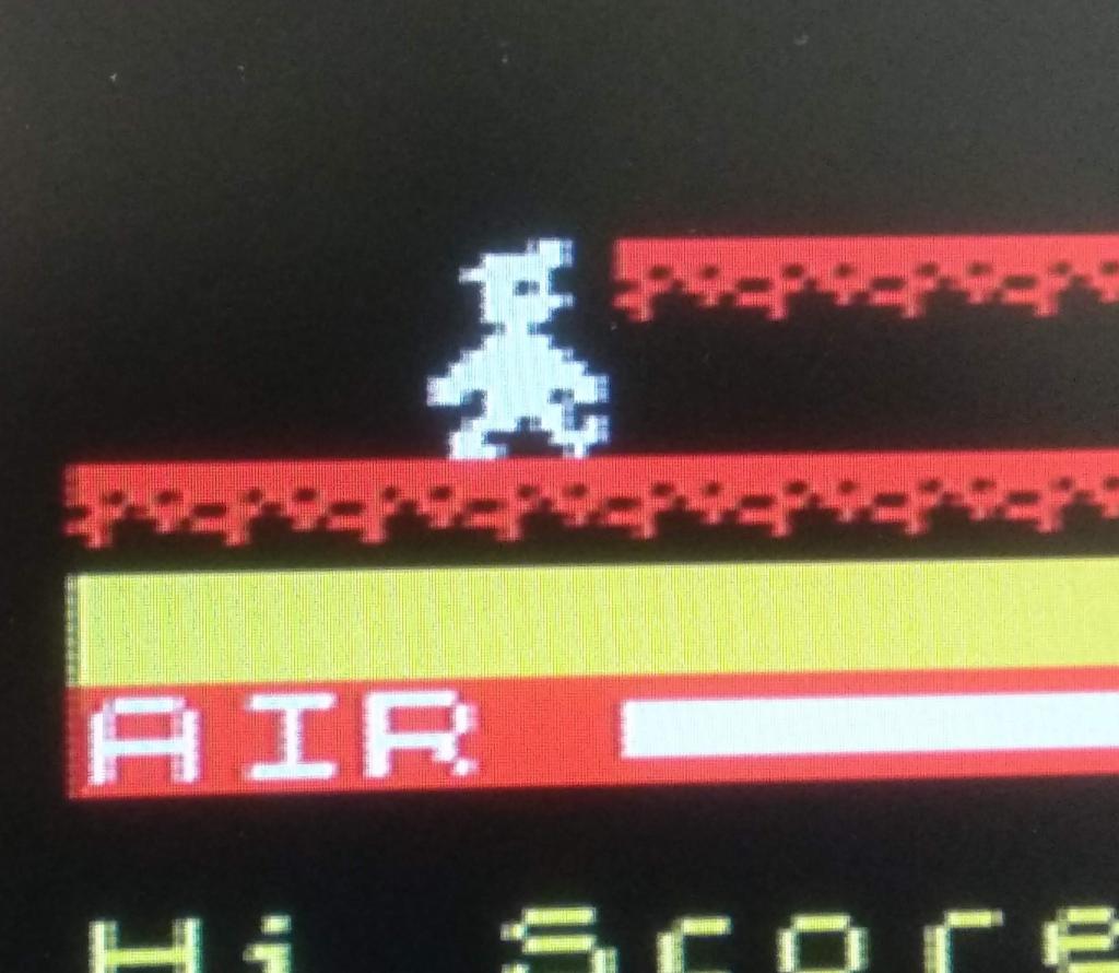

Here are some photos I just snapped of the screen.  This is with a cheap Acer KA220HQ LCD monitor.  I really should have wiped the dust off the screen first!

Posted: 06:05pm 17 Sep 2019
Your LCD has a very stable image, but when I say about the quality, we can see in the image below the irregular scaling effect:
Look in the M letter, you will see that the vertical lines are not the same width for the same letter in another position on the screen.
The letter X has the same problem, which doesn't have uniformity in the diagonal lines, and I sure that the same letter in another position will sometimes have perfect diagonal pixelated lines.
This is not a CMM bug, it's like I said before, it's just the digital display trying to scale a not standard resolution, and on an analog display, these scale effects don't occur.
I used very old LCD monitors on the CMM, and some have a little color shadows effect with some small flickering, and others have a perfectly stable image. Only on a CRT I see a crystal clear image without any scaling misalign, but when I use blit command to scroll colored images too fast it's possible to see the colors out of sync because the CMM doesn't put the three colors at exact same time and doesn't use VSYNC or a frame buffer.
Edited 2019-09-18 04:06 by MauroXavier

Posted: 06:43pm 18 Sep 2019
I've checked the diodes and resistors, and I've wiggled the connectors to no avail, pixels (especially in Mode 4) still have a "shadow":
