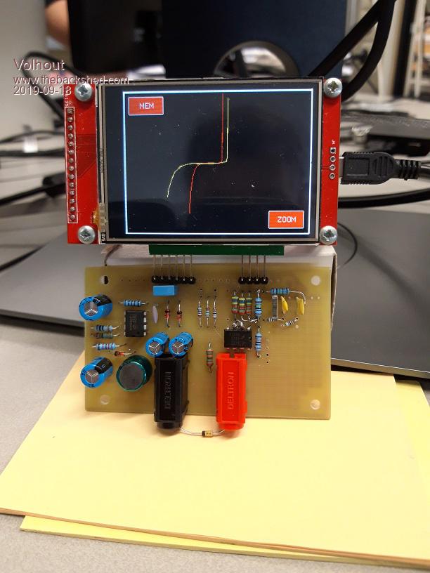

In my previous job the company I worked for had HAMEG oscilloscopes that had a component check feature. Very helpful if you want a quick analysis of a defective printed circuit board. This component check feature has been at the basis of the well known "Huntron Tracker".
My current employer did not have these HAMEG oscilloscopes, or Huntron Trackers.
Since the technology behind it is very simple, I used a standard oscilloscope, a function generator, and a 10k resistor to achieve similar functionality.
In my mind an idea formed to build this functionality with a micromite and an LCD screen. First I thought about the LCD backpack.
Then, at matherps advice, I ordered a ArmiteF4 and screen, but had bad luck these did not work. Back to the Back...pack.

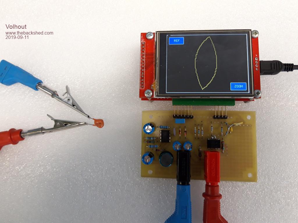

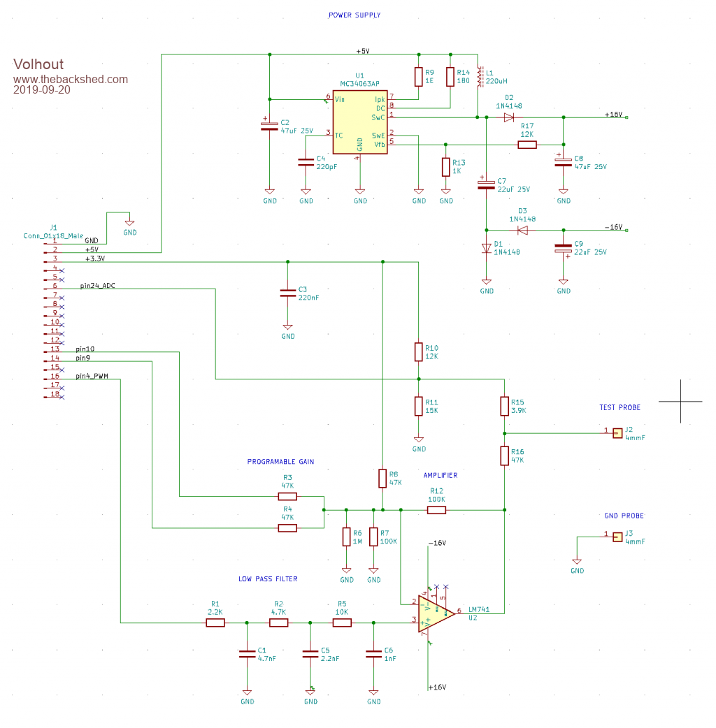

Drawing some schematics, and prototyping resulted in this
The small PCB holds basically 2 circuits
On the left side is a convertor that makes +/-16V to power the amplifier (the test voltage is +/- 12V).
On the right side is a PWM lowpass filter, and an amplifier that amplifies the 3.3V signal to +/- 14V.
The micromite ADC is used to measure the voltage back.
Software is not ready yet (ZOOM is not implemented), but I thought I should share the current status with you.

Did you make up your alligator-clip to probe thingy, or do you have a link to where it may be bought
What problems did you encounter with the F4 and LCD?
Can you publish a schematic and do you intend to make a PCB?
Posts: 6208
Posted: 02:13pm 11 Sep 2019
hi lizby,
1/ There is no probe, It is a component with wires.
2/ The F4 did not connect through USB after mmbasic was programmed. Programming went well though. Others have experienced the same, but it is different between units. Some do connect after few tries. Mine doesn't.
3/ Schematics and final code will come when I am satisfied with the performance.
Although it doesn't look like it, the photo shows a PCB (single sided).

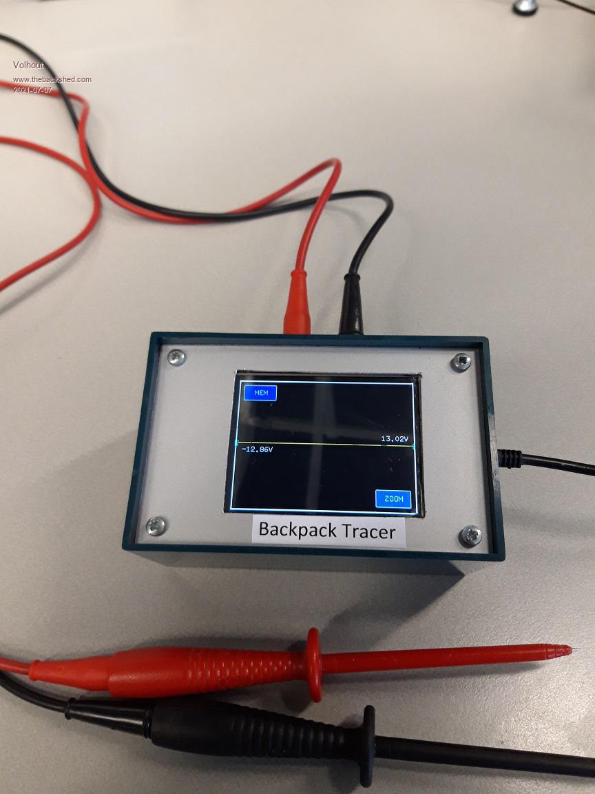

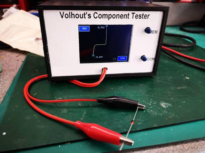

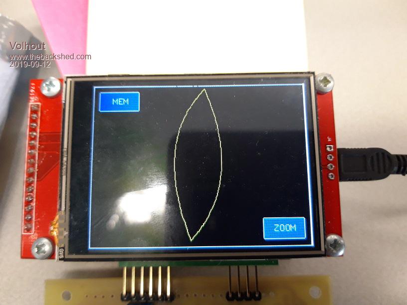

I am finally satisfied with the performance. The resolution and number of sampes per refresh are variable in this code, and with the current settings it is workable on an MX170. I get 8 fps (frames per second, in this case waveform refreshes per second).
For those who want to experiment, constants are defined in beginning of the program.
Implemented the hardware zoom, the software zoom, and memory.
The code should be compatible with other screen resolutions since I used MM.HRES and MM.VRES in the relevant scaling. Have no option to try it myself though.
Attached photo gives an impression of the basic functions, measuring a 4.3V Zener diode, and comparing it with a different Zener diode.
In normal mode the test voltage varies between +13V and -13V (so you could even test 12V zeners)
In zoom mode the range is +6.5V to -6.5V (half) to get better resolution for diodes and low voltage zeners.
I had some HW bugs in the layout, in the next posts I will add readable schematics, an updated layout (graphics only, it is not made in a CAD system) and code.

Many decades ago we had a couple dozen Huntron Trackers in the electronic shops at Pan Am. They were EXTREMELY useful devices which saved a lot of time in troubleshooting.
This looks like a really useful gadget to have. I recommend it to everyone here! Thanks Harm!

Posts: 6208
Posted: 08:56pm 19 Sep 2019
You must have been waiting eagerly for this....
Finally the schematics of the backpack tracker.
Honestly, the prototype board was drawn on a sheet of paper, and the PCB was made using the toner transfer method from a simple SPRINT (draw lines and pads) program.
Since I had not used CAD packages for some 20 years (yeah...as a manager you don't do the fun stuff) , I am going through the learning curve again with KICAD.
This is the schematics, I have done the placement, next week I will do the routing again....in KICAD.
I'll update this thread when I am satisfied with the routing and silkscreen....
Edit: oops, R15 must be 47K, R16 must be 3.9K
If some wonder about the choice for a LM741: it has maximum voltage range of +/- 20V. More modern opamps limit to +/- 15V.
Edited 2019-09-20 16:57 by Volhout

Posted: 07:11am 20 Sep 2019
Valhout,
I don't understand the configuration of R3,R4, R6 and R7? As shown, I can not see how  there is any difference between changing either of the gain lines from the MM?
If you get the time (and the inclination     , could you perhaps give a brief Theory of Operation of your circuit with reference to the software.
This is a great idea and I am well on the way to a port to the E100 with a 9" LCD display using the MM+ GUI commands.
panky
Posted: 07:29am 20 Sep 2019
panky
The two gain pins are switched to high Z inputs for low gain setting so they are effectively taken out of play.
For high gain, they are tied to 3.3V and GND putting them in parallel with R6 and R8, changing the feedback ratio.
I too would like a run down on the operation.
this might be a starting place:
http://www.huntron.com/sales-support/pdf/ASA-paper-extract.pdf
Edited 2019-09-20 17:31 by TassyJim

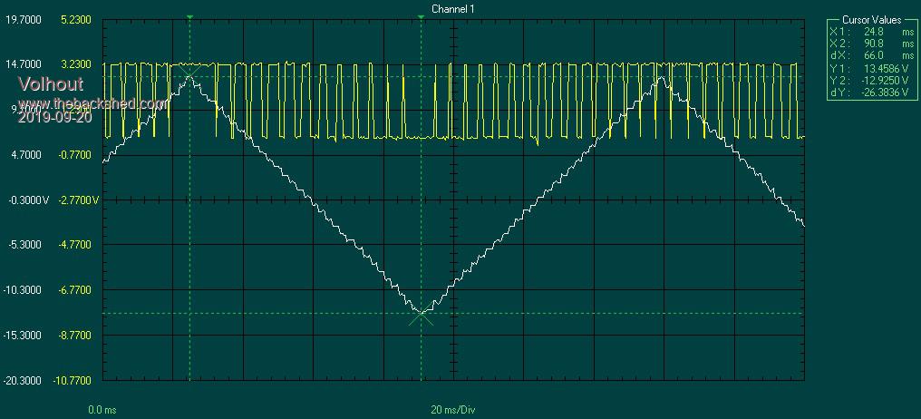

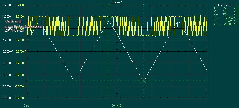

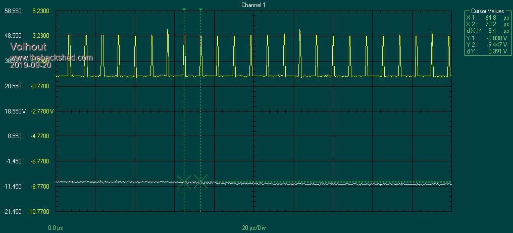

Posts: 6208
Posted: 09:23am 20 Sep 2019
I'll explain a bit about the operation. TassyJim's article more or less sums it up, but I'll add this bit.
The BACKPACK_TRACKER is a measuring device for impedance. It applies a voltage to a component and measures the current. By varying the voltage, and measuring the current at each change you can detect complex impedances (inductors/capacitors) and non linear impedances (semi conductors).
Graphical representation of voltage and current makes instant recognition possible (humans are very visually oriented). But audible representation is also viable.
BACKPACK TRACKER works visual. A device like this is also referred to as a curve tracer.
The word TRACKER is from following a trace.
The only difference between the theoretical description above, is that the MX170 on the LCD backpack has only 1 ADC free. Therefore measuring voltage (ADC1) and current (ADC2) is not possible. The trick is to use 1 ADC that measures a voltage that is a combination from voltage and current, and subtrackt the theoretical voltage from it to. Residual is the current. That is done in these 2 lines.
 y(i)=(ADC - pc(i) + center) * Vstep
 x(i)= ADC * Hstep
Vertical (y(i)) plotted is the measured voltage - theoretical voltage = current
Horizontal (x(i)) plotted is the measured voltage
If you look at the schematics, the PWM signal (120kHz, 0V/3.3V) is filtered to a DC voltage. By varying the PWM, we can change the DC voltage into a low frequency AC signal, in our case a triangle wave. The amplifier U2 changes the 0V and 3.3V levels to -14V and +14V. Through impedance R16 this is applied to the test probe. Below plot shows the PWM signal and triange waveform at test pins in normal mode and 64 samples per frame.
At each step in the waveform a sample is taken, and drawn on the screen. Around 500 vectors per second are calculated, and a 1500 drawn (1 erase old, 1 draw memory line, 1 draw actual line). That happens in this section.
    Line x0,y0,x(i),y(i),1,0                  ' erase
     Line xr(j),yr(j),xr(i),yr(i),1,memcolor   ' memory line
    x0 = x(i) : y0 = y(i)
    ADC=(Pin(24) * gain) + offset
    x(i)= ADC * Hstep
    Line x(j),y(j),x(i),y(i),1,linecolor      ' draw actual vector

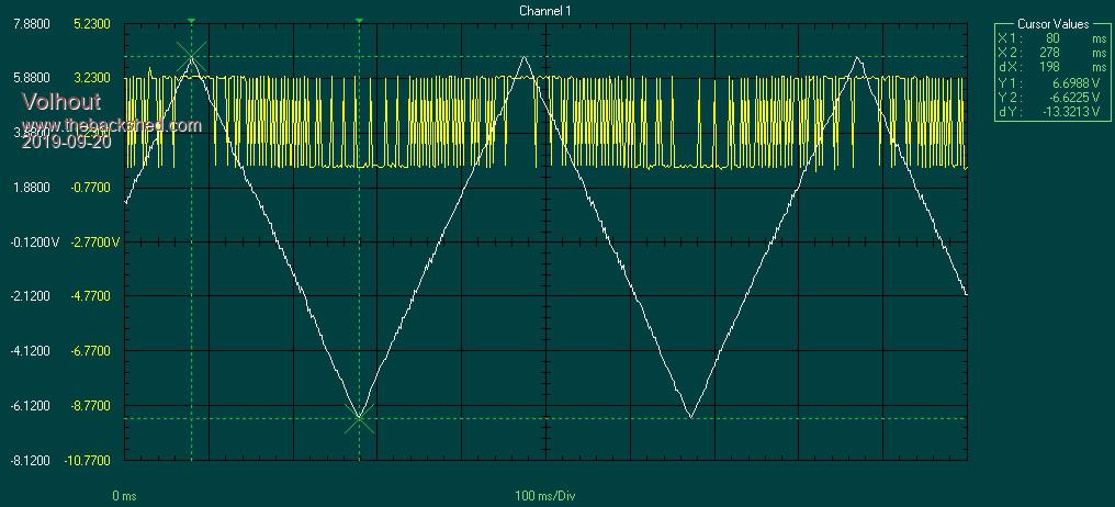

The oscilloscope picture yellow line does not represent the actual PWM waveform, since the picture lacks resolution. Below is a detail of the lowest point in the triange waveform (zoomed in hunderds of times).
The memory function, simply copies the current waveform to a memory register (xr(i) and yr(i)) and changes the color of the memory line to red. That makes it visible. The default color was black.
The number of samples in a frame can be changed in the code. That has impact in the waveform (more steps is finer waveform) but slows down the refresh rate of the screen. Waveform with 200 samples per frame is shown here.
ZOOM
Normally zooming would just be done graphically, but we are tied into MMBasic and the MX170, with only 100 possible different PWM setting. By zooming in we would only have 50 or less. Therefore a hardware trick is needed.
The amplifier has maximum gain in normal mode. The maximum gain is achieved when IO pins 9 and 10 are set to output (low impedance) and pin 9 is 0, pin 10 is 1.In fact parallelling R3, R4 and R6 R7 R8. When zoom is selected, the amplifier makes a lower output voltage (lower gain), but the PWM remains at full range (100 steps).
The lower gain is achieved by making pins 9 and 10 high impedance (input), and the gain is determined only by R6,R7,R8 and R12.
R6 and R7 parallel are 91K, so if you can get E24 values, you don't need 2 resistors.
Graphical zoom can be used for the ADC. No hardware needed, since the ADC is 12 bits (4096 steps).
With 200% zoom still has a resolution of 2048, far exceeding the resolution on the PWM.
The lower gain waveform is shown below.
Edited 2019-09-20 19:30 by Volhout
Posted: 11:21am 20 Sep 2019
Don't those voltages damage any components?
Posts: 6208
Posted: 11:29am 20 Sep 2019
Hi JohnS,
The 14V is current limited (3mA). Typical circuits won't get damaged by it, but I would definitely not advise to probe inside a 10GHz low noise amplifier or 100GHz spectrum analyzer input stage (there are FET's in there that do not have protection diodes build in to achieve better RF performance).
But the typical circuits we deal with are fine with these signals.
