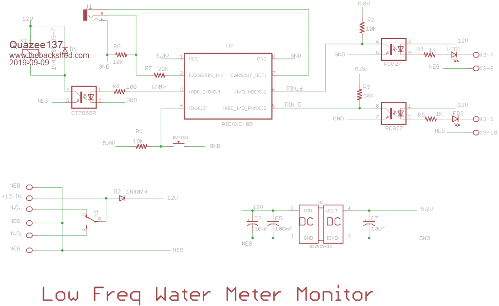

I thought I'd try and use the picaxe 08M2 for a project monitoring one or two
 water meters. There is a lamp that needs to be on if the meter/s are at or
 above the learned speed (rate). So here is my go at it. PICAXE Pros Please
 let me know if I've got any thing wrong.

Personally I would add a 10nF at Vdd of the PICAXE08M2. Not sure how good the 10uF alone works.
@lizby: It is interesting to see that in start0: you have a nice do...loop structure, but tasks start1:, start2 and start3: have hard goto's….
Personally I have not tested the "count" command in 2 different tasks. As far as I know count is not interrupt driven on the edge, but there is an internal 20uSec timer interrupt for each "counter", where they poll the count pin.

Agree that C5 should be on the other side of the DC-DC module, as close to the picaxe power pins as possible.

 In cleaning up the schematic I lost the other cap but then you know how easy it
 is to lose those SMD parts.

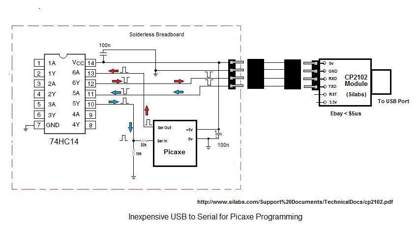

  Quazee137 said  Does the cable have to be the $29 or can I make use of any USB to serial as long as I invert the RX and TX signals?
I use a usb-to-RS232 DB9 cable with a 3-pin header--but some work and some don't and I don't know how to buy one off of ebay which is guaranteed to work. It is also possible to use a usb-to-ttl serial module with an inverter, but that module has to recognize and pass on a BREAK signal, which the PICAXE Editor uses to initiate a download. Many people have had problems with not being able to download because of this BREAK issue. I wish I could point to a reliable download cable which is less expensive than the Rev-Ed one, but I can't.
Here is somebody's usb/serial CP2102 to picaxe inverter using a 74HC14:

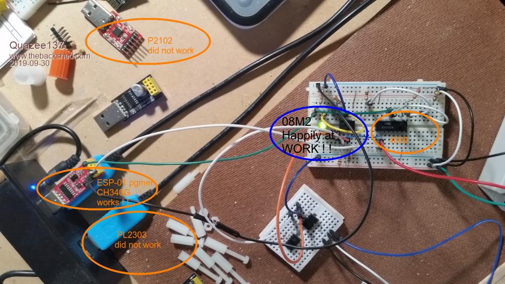

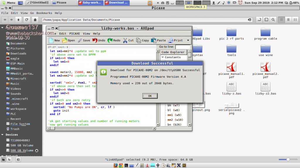

 The three Picaxe 08M2+s showed up. I tried a few USB to Serial converters none
 wanted to work. I was going to order the cable and looked at my ESP-01 USB to
 serial sitting there and said HAY why not give IT a try.
and YEA !! it worked.
 The parallel coding was not working so went to standard fall through coding.
 This is working really well. It takes 30 seconds to test if meter/s
 is above 8PPM. If only one is the other is tagged at zero.

let sm1=mm1*4 ;update sm1 to ppm
'if above zero set to 8PPM
if sm1<>0 then
  let sm1=8
endif
count meter2, 15000, mm2 ;get count for 15secs
let sm2=mm2*4 ;update sm2 to ppm
sertxd( "sm1=", #sm1, " sm2=", #sm2, cr, lf )
'if above zero then set to 8PPM
if sm2<>0 then
  let sm2=8
endif
'if both are zero retry
if sm1=0 and sm2=0 then
  sertxd( "No Pumps are ON", cr, lf )
  goto init
end if
'ok got starting values and number of running meters
'now get running values
do
  sertxd( "getting gm's " )
  count meter1, 15000, mm1 ;get count for 15secs
  let gm1=mm1*4 ;update gm1
  let gm2=mm2*4 ;update gm2
  sertxd( "gm1=", #gm1, " gm2=", #gm2)
 'if gm's are above sm's
  if gm1=>sm1 and gm2=>sm2 then ;
    high light ;then light on
    sertxd( " Lite ON", cr, lf )
  else
    low light ;else light off
    sertxd( " Lite OFF", cr, lf )
 endif
loop
Now wiring up a 28 pin Ziff socket and and 8 pin cable to go to the ESP-01
USB to serial and work with all the Picaxes.
Thanks lizby for the help.
Thanks Volhout saw some of your work at the picaxe forum great help to see working code.
Posted: 10:21pm 29 Sep 2019
I don't use any other USB <---> serial gadget now. CH340G always seems to just work when I have had a load of trouble from others - however, other  peeps seem to hold PL2303 etc. in high regards so maybe it's me *shrugs* but I have one of WW's 44 pin micromites on my desk right now that I daren't not move coz the USB chip on it with throw a paddy and then it's a reboot to get it back. I was looking at it sideways today and thinking I ought to cut the darned USB chip out of the loop and use a CH340G - got a bag of them in the workshop.
