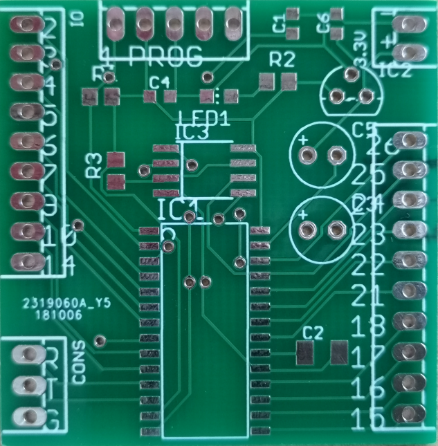

I am playing around with a layout for an Extreme64 based PCB. (very early stages)
As usual I am trying to keep this board as small as possible..
Due to the fact the VGA is not available on the X64 is there a need for the Mouse and keyboard PS2 connectors?
These are relatively bulky and it would be nice to not have them on the board..
I am after opinions as whether these are really useful on the X64 or not.. I can utilise the space for other items
Anyway I am interested in your opinions.

Re. The PS2, I am exploring a couple of other options (Piggy back plug in PCB) or header pins and a converter cable (prob using one of those 2 PS2 to USB cables and modifying it) as I am trying to squeeze everything onto a 50mm square PCB..
So far it is looking ok but those damn PS2 connectors are taking a lot of room.
Kind Regards,

agree with that.... PS2 blocks take a lot out of 50mm sq .
With the flash RAM chip; Pete M mentions, in that article I linked, "it was all written first in Basic and then just converted to C for improved performance". Looking at the data sheet there is nothing exotic about controlling it (bit fiddly in places e.g. with the pages etc.) but maybe if he is willing to release that code it might go some way to addressing your (valid) concerns. I prefer a pure MMBasic solution just to provide cross-platform compatibility... it also helps in that I don't do C and so writing CSubs are beyond my skills...
It doesn't matter anyway - whichever pin you designate as CS for it will get in the way of someones work
It was just a thought. My Mk5 mini controller board has space for one - I had the room and thought it was a nice touch - just in case.
This little board is a real workhorse - I use them everywhere - dead easy to build up and just gets on with business no problems. The use of a 78L33 won't be to everyone's tastes it is easy to "jumper" when provided with 3.3v on the input and  can work all the way up to 12v with a single solution and no hassles, plus I got stacks of them left over

If you use a header it becomes just another useful connector that can be used for whatever. It should be possible/easy to make up a free PS2 to header cable.
Are there other pins available that can be connected to the same header?
Peter
p.s.
I like CB's board but there are no bolt holes
P

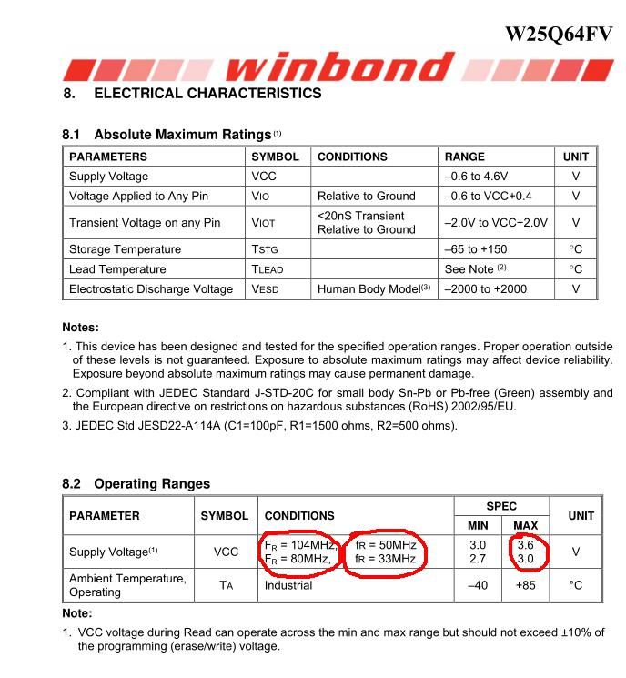

As to the flash memory, I have bought 10 to play with (A massive 55c AU each for the W25Q64FVSSIG).
I have had a quick scan of the data sheet and I am a little concerned about the following specs.
I am yet to determine what Fr really means but if operating at 80MHz/33Mhz the max Vcc seems to be 3.0v
Hmmm... I am sure they work well but just a thing to ponder

Posted: 10:54pm 08 Sep 2019
I read that spec. as saying you can run at the higher frequency with the higher voltage supply.  This is quite normal. So you can run at a maximum of 80/33 (I guess they are the figures for the two directions?) with a 3-volt supply, and the speed limit increases to 104/50 when you have a 3.3-volt supply.

It possibly does mean that but I feel that it looks like it is in reverse..
It states the Fr as (CONDITIONS) so I read the Vcc being max 3.0v
Very confusing.. but some people apparently have this working OK..
What sort of Fr would an X64 at 200/252 MHz create?

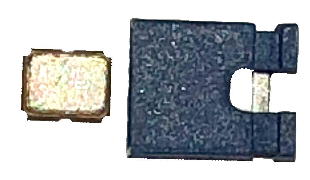

Actually, (Yes I know you were joking), I almost couldn't find it in its plastic bag.. It is a whopping  3.2mm x 2.5mm and was darn hard to solder some wires on to test it  in my X144 board. (yes it works fine even without the pin 1 mod).
This might be a challenge for someone to solder but then the 0.5mm pitch on the MZ is not going to be for home handyman solderers either. Flux will be a must.
Here is a rough as guts picture next to a 0.1" shorting link
Kind Regards,
EDIT !!!
Wow! Look at the size the image came out as..
Edited 2019-09-09 12:16 by bigmik

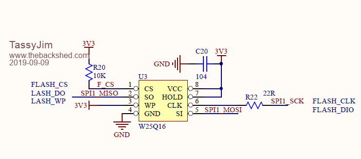

I have been playing with the W25Q16JV which comes on the STM32F4 board.
The data sheet is similar to the W25Q64FV.
This is the circuit for the flash chip:
Note the 3.3Vsupply and also the WP and HOLD pins tied to 3.3V

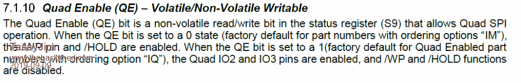

The chips supplied on my boards are of the variety that default to QUAD ENABLE being set!

I think you will be safe with 3.3V
