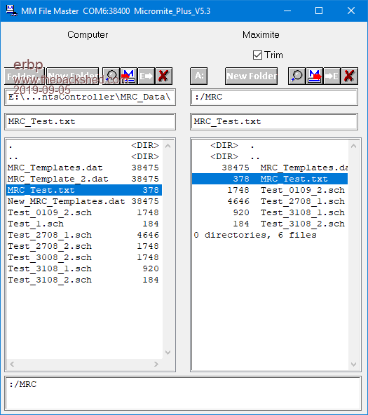

I then used MMEdit File Manager to transfer a second copy of the test data file to the SDCard. The below screen shot is prior to the transfer - note the size of the MRC_Test.txt file is showing the same 378 bytes in both the PC and MM panels.

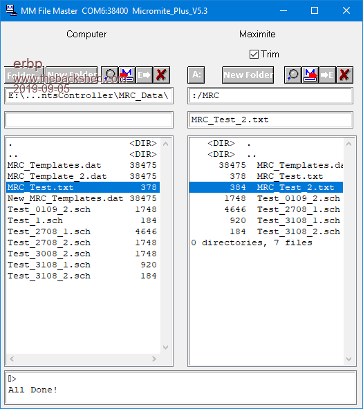

I then uploaded the file from PC to SDCard as MRC_Test_2.txt - following screen shot shows that the MRC_Test_2.txt file size is 384 bytes on the SDCard!!
Running my test program against the uploaded test file show the following results:
run
Enter name of test file: ? A:\MRC\MRC_Test_2.txt
File A:\MRC\MRC_Test_2.txt - Length: 384

Note the 15th record has appeared containing 5 0x1A bytes.
This would appear to be the XMODEM "filler" bytes inserted in the final block of the transfer to make the block up to the 128 byte size used by XMODEM. Note that the new file size of 384 bytes = 3 x 128.

It is not an error.
XMODEM works in 128 byte blocks.
There is also a 1K version but MMBasic sticks to the original 128 byte block size.
For the last packet, the file has to be padded to a 128 byte boundary. The standard allows for crtl-Z (which is the old CPM end of file character) or zero value bytes.
MMBasic reports the file size, so in MMEdit, if you are transferring from the 'mite to the PC, there is an option to truncate the file back to the original size.
There is no way to do that when transferring from PC to 'mite so the padding characters remain.
If your data contains 1A, you will need to have some way of determining file size to cater for the end of file characters.
