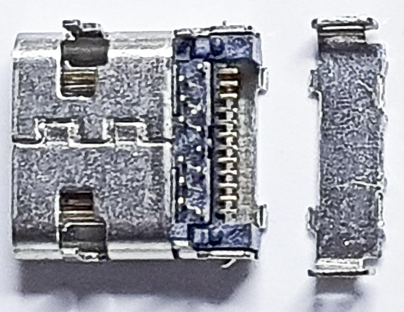

The connectors themselves come in a number of different physical configurations and in almost all configurations are going to be a hobbyists worst nightmare to hand solder. One I purchased from rs-online.au (895-0552) has a 2 rows of through holes then a row of pads for SMT connection at the rear. This rear row is virtually impossible to get to with even the tiniest of irons.
USB C  Drawing.pdf
There is a rear cover plate that can be bent up (and easily breaks off) to allow access with a soldering iron - still tricky but if you can solder 0.5mm chips you will be OK.
