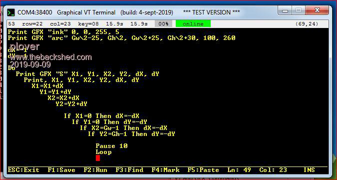

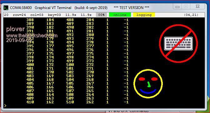

Posted: 01:56pm 01 Sep 2019
Just taken a few minutes before closing down for the night.
I am now able to get the connection to the E28 without too much trouble, not sure why it seems that the comport changes, have add I think it changes.
I have verified that the MMBasic is loaded, for example by printing 22/7 which is a close approximation to Pi.
Then I tried loading the "GFX demo 2.bas" via MME, by copy/paste to MME and I watched the download take place and success.
Next I then changed over to use GFXterm, I did the same mode of copy/paste into the terminal.  Program Started running right away, running a table lots of lines. Short time later a beautiful sinewave in rainbow colours rolled across the screen.
I am really impressed.
Put MMBasic into 'edit'mode and rolled the mouse up and down, as far as I could tell it worked fine.
I notice that I struggle with recognising where the mouse pointer has focus. I do notice there is a change in frame colour on GFXterm. Can I configure different frame colour?

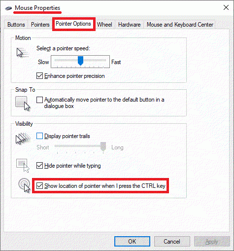

you can enable mouse pointer location in windows here:
as far as i am aware, this works in all versions of windows from XP upwards. when enabled, just tap the ctrl key to cause a circle to flash for half a second around the mouse pointer.

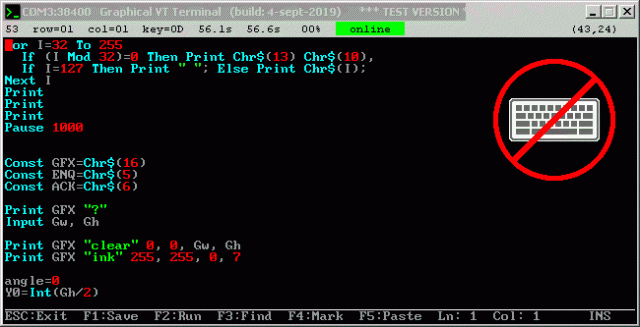

hi,
   give this test version a try:
GFXterm test (2019-09-04).zip
it shows a very 'unsubtle' icon on the screen when the application does not have focus:
rob   :-)

Well sleeping turned a few gearwheels in my brain.  I think I know the answer to my problems above.  The above statements need to be used inside a program. So that should be the next thing I look at.
The focus alert absolutely great for me. Even before I get around to hit the command line I know if the focus is away or already in place, a real treat.

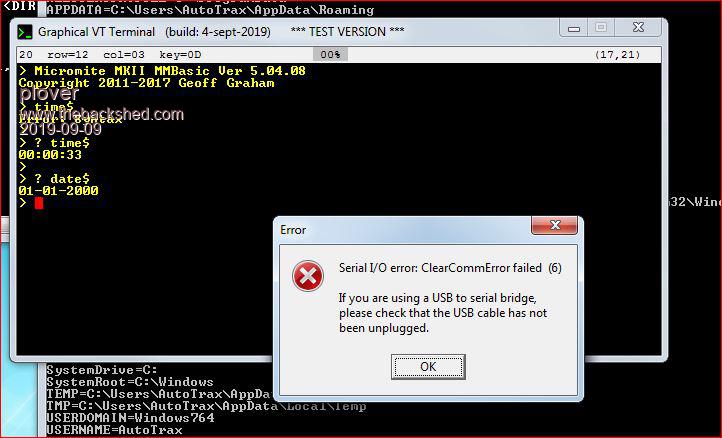

Have been away visiting family and took a win7 laptop for a bit of relaxation. I took also the E-28 thinking I would be able to check out some items that has me confused.
Well I found out that the GFXterminal failed to connect to E-28 on a Win 7 32 bit laptop. Stumped me because I run a win7 64 bit desktop and this does not have trouble. However that machine has been used to run MMEdit some motnhts/year ago and I may have installed driver at that time. I do not remember.
Device manager revealed the VID and PID
VID04D8   PID000A
I know it is something CDC, USB to serial coms interface
Internet search seems to give me a MS file needed 300 MB file for a 15 kB file??
A bit painful anyone got a better solution?  I am likely to have missed something like so and so supplied a driver? As I am home again I will not need it for another 4 weeks so I will put this aside for the moment.
I would like to return to the question of using console port on the MMBasic. I think I have figured out at last that while having a terminal connected the connection via the command line will be able to interpret a subset of the MMBasic commands?
Micromite MKII MMBasic Ver 5.04.08
Copyright 2011-2017 Geoff Graham
> time$
Error: Syntax
> ? time$
00:00:28
> ? date$
> ? DATE$
01-01-2000
> ? date$
01-01-2000
But following being MMBasic commands do not respond on the command line.
? MM.DRIVE$
> ? MM.FNAMES$
How many MMBasic commands and what are they that responds in command line ?
