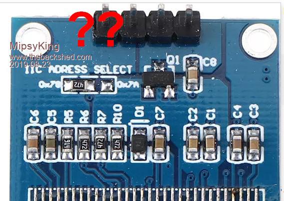

Posted: 07:17am 22 Aug 2019
In my case, the message is immediate but then the display remains dark, no matter if I type some command like:
text 10,10,"hello"
line 0,0,100,30
nothing on the screen, shoud I type before some specific command to enable the display?

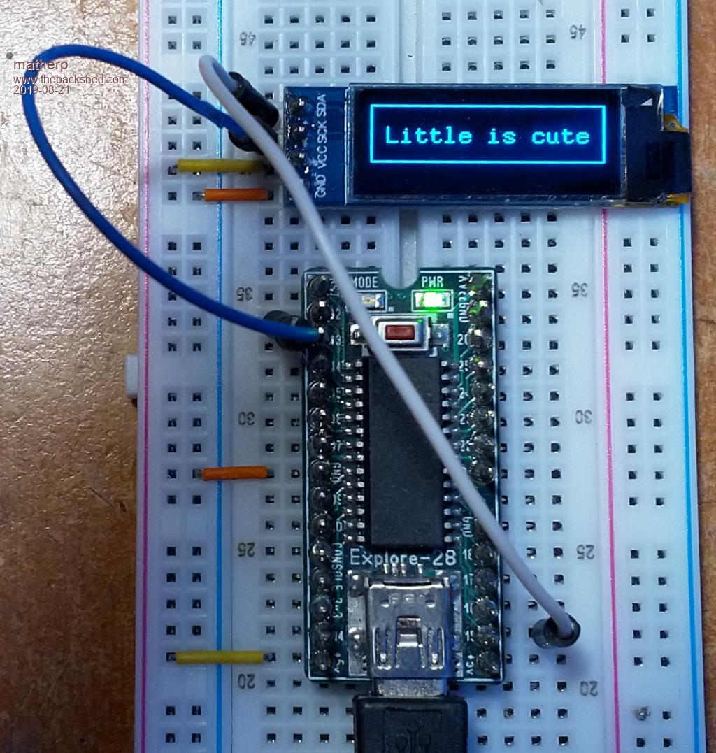

Posts: 12084
Posted: 08:47am 22 Aug 2019
  Quote  nothing on the screen, shoud I type before some specific command to enable the display?
No, should just work. I tested on 128x64 and 128x32 as pictured using a 28 pin MM2. Note 1.3" I2C versions are wired incorrectly and don't work. I'm not aware of any faulty 128x32 displays.

Posted: 04:28pm 22 Aug 2019
Ok, all working now!    The problem was the back of the display: there is a configuration resistor soldered on 0x78 and the alternative is 0x7A. So I configured your listing for &h78... but it was misleading because everithing started to work when I had the idea to simply dont touch your default setting (so the the real adress is &h3C ?) . I dont know why they wrote such numbers, if is not true...
Posts: 12084
Posted: 07:01pm 22 Aug 2019
  Quote  I dont know why they wrote such numbers, if is not true...
I2C devices have a 7-bit address and the 8th bit defines read or write. There are two conventions, one treats the addresses as 0-254 in steps of 2 and the other 0-127 in steps of one. MMBasic uses the second, your display is using the first.
hex 78 / 2 = hex 3C

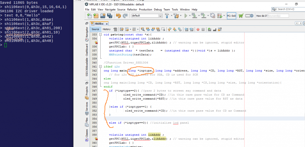

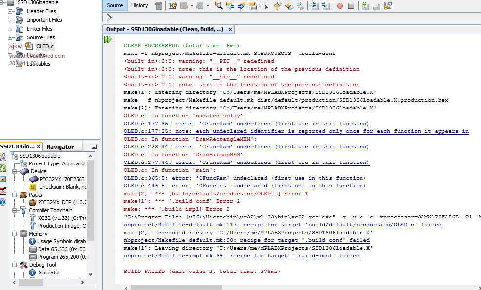

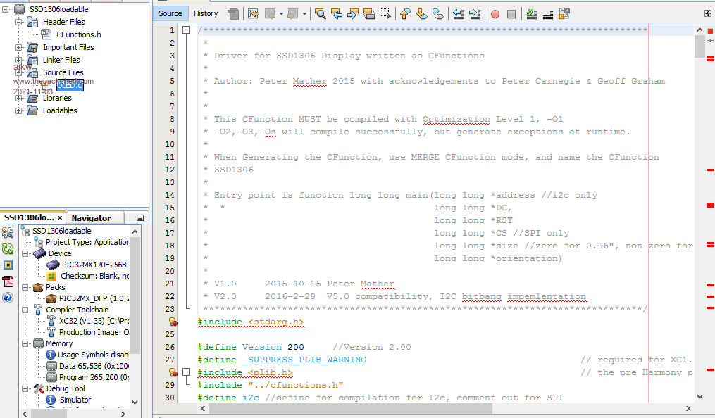

Is the source code for the SD1306 i2c driver for a Micromite available please?
I would like to see if I can adapt it to make a SH1106 I have work correctly.
With the all-basic-driver the SH1106 will , with a mod, work but and I can change the contrast too, however it is just not fast enough to draw a screen, so there is some hope.  Perhaps I can make a change to the Csub version and then learn how to compile it.

  Quote  Is the source code for the SD1306 i2c driver for a Micromite available please?
I've attached the complete MPLabX project
SSD1306loadable.X.zip
ajkw
Joined: 29/06/2011
Posts: 290
Posted: 11:36am 31 Oct 2021
Thank you Peter.
I have identified the change I think I need to make and have gone on to install Mplab X.
The first tutorial on creating Csub's mentions MPlab 3.10 and the compiler 1.33 however opening the project with this version generates a error has the project was created in something later.
What versions should I be using please?
Anthony.
Posts: 12084
Posted: 11:49am 31 Oct 2021
I'm currently running MPLabX V5.2 and compilers 1.33 and 1.44. This project was last built with V1.33
