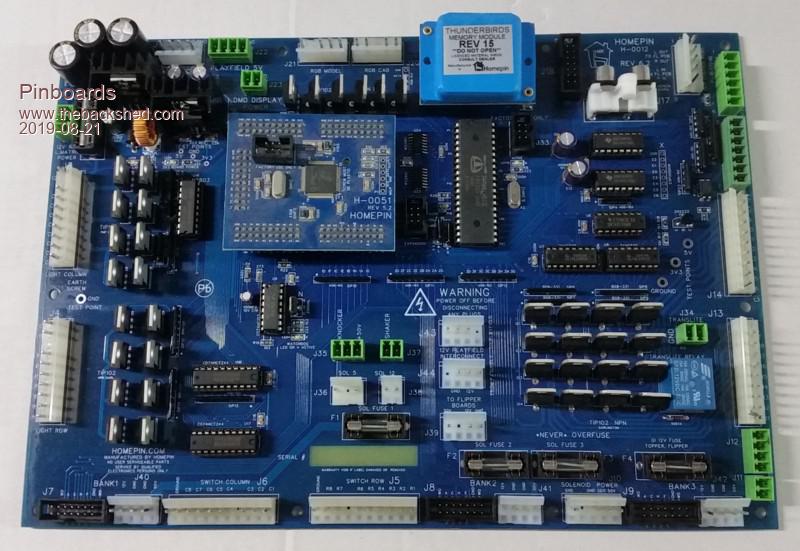

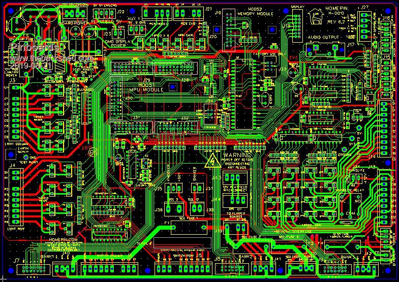

One of our larger boards that we designed using FreePCB:

That is a very complex board board you have there.
