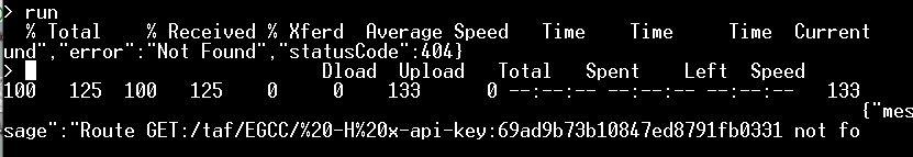

I've just tested it using terminal to the PI from Windows and
curl https://api.CHECKWX.com/taf/EGCC/ -H  x-api-key:69ad9b73b10847ed8791fb0331  works
system "curl https://api.CHECKWX.com/taf/EGCC/ -H  x-api-key:69ad9b73b10847ed8791fb0331"+q$,c() results in
I need a way to pass the spaces in the address through the system command "%20" doesn't work
and using %20 results in
Edited 2020-11-29 21:26 by lew247

Posted: 11:27am 29 Nov 2020
it's hard work posting and reading with the SSL cert out of date
using either of these
as in
(Spaces are showing as spaces and not & #32;)
both give
Edited 2020-11-29 21:41 by lew247
