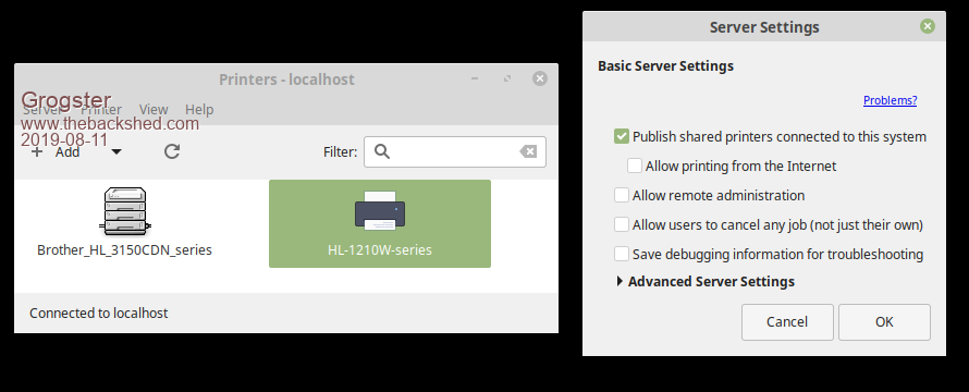

Here is my Linux Mint printer setup:
What is NOT shown in this image, is the drop-down(right-click) menu for each printer, which both have the tick in the SHARED and ENABLED check-boxes. Note that I have enabled publishing the shared printers so that they SHOULD be discoverable by other machines on the network.

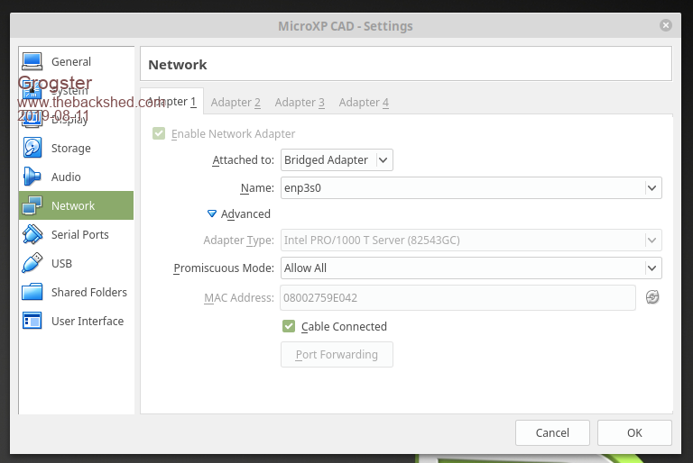

Here is my VirtualBox network settings:
With these settings, I can access the shared folder via the XP VM back to the Linux folder for exchanging files etc - that is working fine, so the network is working.

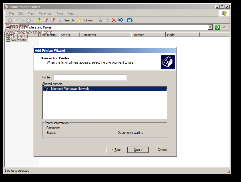

The XP VM sees nothing. All I ever get when I search for network printers, is this:
Stuck now, as I figured that these settings SHOULD allow the XP VM to see the shared network printers.....
I tried booting another full-install SP3 XP VM, but it won't see anything either, so there must still be something else I need to do to get things to talk.
