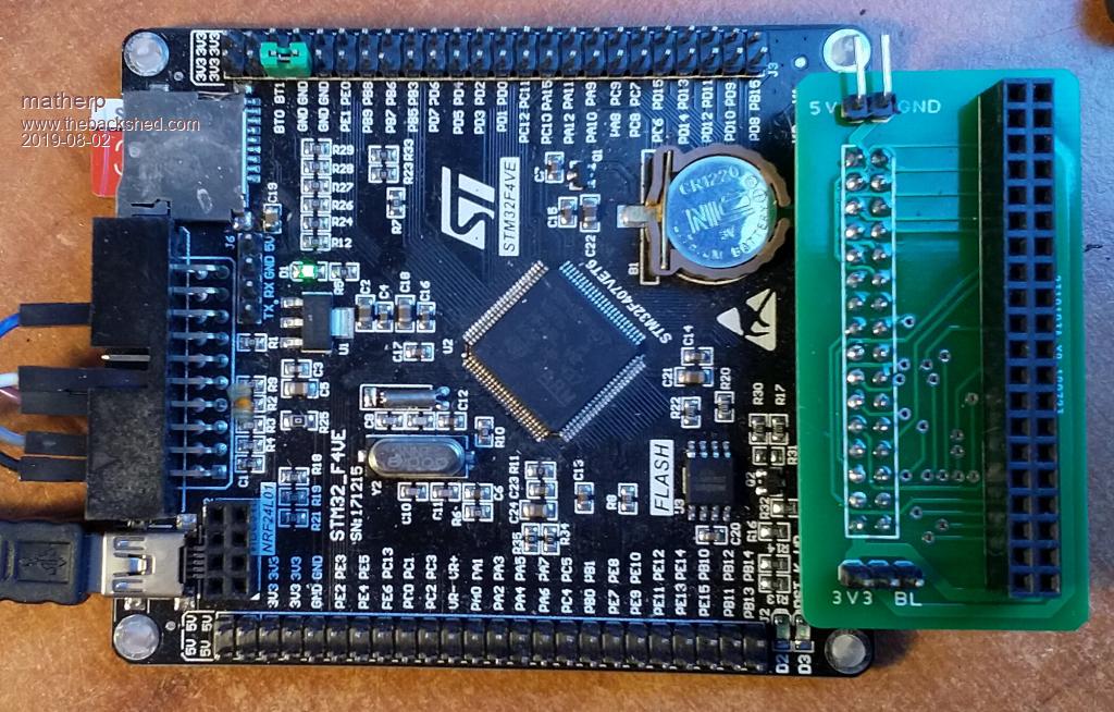

This is the final version of the SSD1963 adapter board for the Armmite F4. Gerbers are attached
STM32F407.zip
Also attached a very slightly modified version of the Armmite firmware that corrects the backlight signal when an SSD1963 display is attached and the Backlight control on the display is selected to "LED_A"
ArmmiteF4.zip
If the Backlight control on the display is set to 1963_PWM or Always On, then the two way header can be left open. If the Backlight control is set to LED_A then set the header to 3V3 for full backligght with no control or BL for control by the PWM output from the STM32F407. NB: this PWM is completely separate from the normal PWM channels.
For 7" displays attach a 5V supply and GND to the 5V header on the adapter. I have found that the STM32F407 board is perfectly capable of supplying a 7" display from the 5V pins (bottom left in the picture) as long as you have a decent USB port powering the board.
For 9" displays using Grogster's East Rising adapter and external 5V supply should be used.

  Chopperp said  ... So the adapter here is for a totally different display type.
Right. This is so that the larger SSD1963 LCD panels will work on F4 boards. This works (in my case, with matherp's original adapter fixed with Din and Dout swapped) with 4.3" and 7" SSD1963 panels (as tested by me--matherp also tested these and 5" panels).
In order to get the 9" EarthRising SSD1963 panels to work, you additionally need Grogster's adapter. This also works for me (though color is wrong on mine, almost certainly for reasons not related to the adapters themselves).

The adapter will also work with 40pin 3.2" ILI9341 displays
