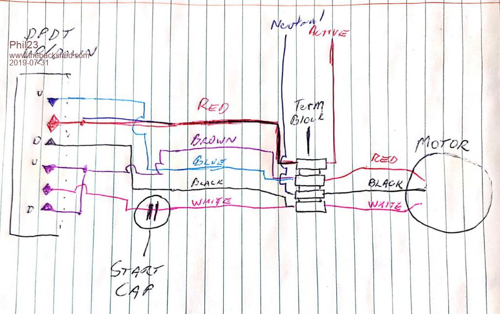

Drew this rough mud map of the wiring as I suspected that there may be a wire wrong somewhere & not sure about how you wire reversible induction motors.
Get the impression that it might be related to how the Starting Cap is wired.
Haven't studied it too hard yet, but any help would be appreciated.

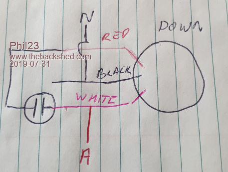

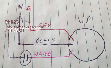

Basically,
Once I've traced it out a bit it just looks like this for Up & Down.
Wondering now how I identify the winding taps from the motor.

That system is typical and clever.
It uses a centre tapped winding RED BLACK WHITE.
In the UP direction ACTIVE is applied to the RED PHASE and the WHITE PHASE gets a phase shift due to the CAPACITOR.
In the DOWN direction ACTIVE is applied to the WHITE PHASE and the RED PHASE gets a phase shift due to the CAPACITOR.
