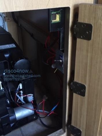

I have a Dometic VT2500 Aviation Style Vacuum Toilet in the caravan. This system allows for much flexibility in layout as the waste cassette can be some distance from the toilet bowl. The system is held permanently in a vacuum until the toilet is 'flushed' where upon the vacuum pump senses the pressure drop and pumps away (quite loudly) until the vacuum is restored.
It is difficult to maintain perfect air tight seals at both the toilet bowl end and the cassette end, so eventually the system will leak enough to cause the pump to spring into action and restore the vacuum. This usually happens in the middle of the night, so most end up switching it off at the circuit breaker before they retire.(if they remember). A google of VT2500 will find several solutions adding switches or timers so it only stays on long enough to allow the vacuum to be restored. If it leaks away you just hit the switch again when needed.

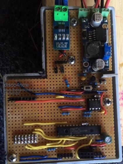

Here is my attempt at a better mouse trap using an MX170 and a few other recent TBS discoveries.
The time for the VT2500 to restore vacuum decreases as the cassette get fuller, until it will no longer attempt to restore the vacuum and it needs to be emptied. An ACS712 current sensor is used to detect when the vacuum pump is running.
The length of time the pump runs(last 16) is displayed as a histogram on this
ST7789 240*240 IPS Display so the decreasing run times can be seen and the emptying time predicted a bit better.
The last 16 runtimes are stored in this little RAM/EEPROM discovered by Lewis and coded by Jim. It ensures that the data is not lost when the power is switched off, and the previous usage is remembered.
47L04 a 4/16 Kbit SRAM with EEPROM backup

Installed in the cupboard
The hardware at the back of the screen.

Select Case f
Case
0,&hC000000000000000 'disabled or invalid
FlagRes(n)
Case
&h4000000000000000' AFTER
If TMRctr(n)>0 then
TMRctr(n)=TMRctr(n)-
1
If TMRctr(n)=0 Then FlagSet(n) ' indicate the timer has expired
Case
&h8000000000000000' EVERY
If TMRctr(n)>0 then
1
If TMRctr(n)=0 Then
FlagSet(n)
TMRctr(n)=TMRini(n) And &h3FFFFFFFFFFFFFFF ' reset the timer
End Select
Next
STATIC Integer lastpumpstate=off
pc(pumpcurrentindex)=pin(ACS712Pin)
pumpcurrentindex=pumpcurrentindex+
1:if pumpcurrentindex=10 then pumpcurrentindex=0
if MIN(pc(0),pc(1),pc(2),pc(3),pc(4),pc(5),pc(6),pc(7),pc(8),pc(9))<2.40 then
'if pin(ACS712Pin)<2.45 then
pumpstate=on
if pumpstate<>lastpumpstate then FlagSet(pumpstatechange)
lastpumpstate=pumpstate
else
pumpstate=off
endif
END SUB
Sub After(Interval As Integer,Tmr As Integer)
' starts a one-shot timer
TMRini(Tmr)=Interval OR &h4000000000000000:TMRctr(Tmr)=Interval And &h3FFFFFFFFFFFFFFF:FlagRes(Tmr)
Sub Every(Interval As Integer,Tmr As Integer)
' starts a repetitive timer
TMRini(Tmr)=Interval OR &h8000000000000000:TMRctr(Tmr)=Interval And &h3FFFFFFFFFFFFFFF:FlagRes(Tmr)
Sub At(dt$,Tmr As Integer)
' trigger at a specific date/time - assumes the core timer is running in seconds
'dt$ must be a datetime formatted as dd/mm/yyyy hh:mm:ss
Local Integer x
x=
UnixTime(Now())-UnixTime(dt$)
If x<2 then
FlagSet Tmr
' if he difference is less than 2 seconds, trigger the alarm immediately
Else
After x,Tmr
' otherwise set a one-shot for the difference
Function Remain(Tmr As Integer) As Integer
' stops a timer and returns the remaining whole counts in the counter
TMRini(Tmr)=TMRini(Tmr) And &h3FFFFFFFFFFFFFFF
Remain=TMRctr(Tmr)
End Function
Sub DI
FlagSet
10
Sub EI
FlagRes
10
' Bit manipulation functions
'Set a bit
SUB FlagSet(bit AS INTEGER)
FLAGS=FLAGS
OR (2^bit)
END SUB
'Clear a bit
SUB FlagRes(bit AS INTEGER)
FLAGS=(FLAGS
OR (2^bit)) XOR (2^bit)
END SUB
'Set bit equal to value passed
SUB FlagEq(bit As Integer,v as integer)
IF v=0 THEN
FlagRes(bit)
ELSE
FlagSet(bit)
ENDIF
END SUB
'Test if bit is set
FUNCTION FlagTest(bit AS INTEGER) AS INTEGER
FlagTest=
ABS(SGN(FLAGS AND (2^bit)))
END FUNCTION
' 47L04/47C04/47L16/47C16 (47XXX) is a 4/16 Kbit SRAM with EEPROM backup
FUNCTION setup() as string
local integer x,r
r = readstatus()
' get the current status register
x = x OR &b10 ' set bit 2 leaving the rest alone
PRINT BIN$(x,8)
r= writeCMD(STATUSreg,x)
' set autostore
r = readstatus()
PRINT BIN$(r,8)
END FUNCTION
FUNCTION writeDATA(addr as integer,D$ as string) as integer
' write string D$ to EERAM starting at addr
LOCAL integer L
addr = addr
MOD SRAMsize ' keep address within chip capacity
d$ = CHR$(addr\256)+CHR$(addr MOD 256)+D$
L =
LEN(D$)
ON ERROR SKIP
1
I2C OPEN
400,1000
I2C
WRITE SRAMcb,0,L,D$
I2C CLOSE
END FUNCTION
FUNCTION readDATA$(addr as integer,L as integer) as string
' read string from EERAM starting at addr, L bytes
LOCAL string D$
addr = addr
ON ERROR SKIP 1
I2C OPEN
400,1000
I2C
WRITE SRAMcb,1,2,addr\256,addr MOD 256 'Reset memory pointer to addr
I2C READ SRAMcb,0,L,D$
readDATA$ = D$
END FUNCTION
FUNCTION writeCMD(reg as integer,EERAMcmd as integer) as integer
'write command to the command or status register
ON ERROR SKIP 1
I2C OPEN
400,1000
I2C
WRITE EERAMcr,0,2,reg,EERAMcmd
I2C CLOSE
END FUNCTION
FUNCTION readSTATUS() as integer
'read status register
LOCAL integer status
ON ERROR SKIP
1
I2C OPEN
400,1000
'I2C WRITE EERAMcr,1,2,STATUSreg,0
I2C READ EERAMcr,0,1,status
I2C CLOSE
readSTATUS = status
END FUNCTION

Posted: 10:21pm 27 Jul 2019
Now you need a button to call the slave to take the cassette to the dump point for you.
We had a bulk storage tank and if it was too inconvenient to drive to the dump point, it was 3 trips with the tote tank.
Alas, those days are behind us.
It is also good to see the MMEdit code pasting working in the new forum.
disco4now
Joined: 18/12/2014
Posts: 1159
Posted: 11:25pm 27 Jul 2019
Yes, I had a couple of goes posting this item on the old system, but failed to save each time. I am suspicious I may have broken it a couple of times near the end.

BrianP
Joined: 30/03/2017
Posts: 292
Posted: 03:52am 28 Jul 2019
disco4now wrote:
  Quote  A short press while the pump is running will stop it immediately. (useful if paper or something is preventing a seal and needs to be cleared)
Just curious - what might the "something else" be??
disco4now
Joined: 18/12/2014
Posts: 1159
Posted: 05:45am 28 Jul 2019
Mostly a few hairs, but not always!
